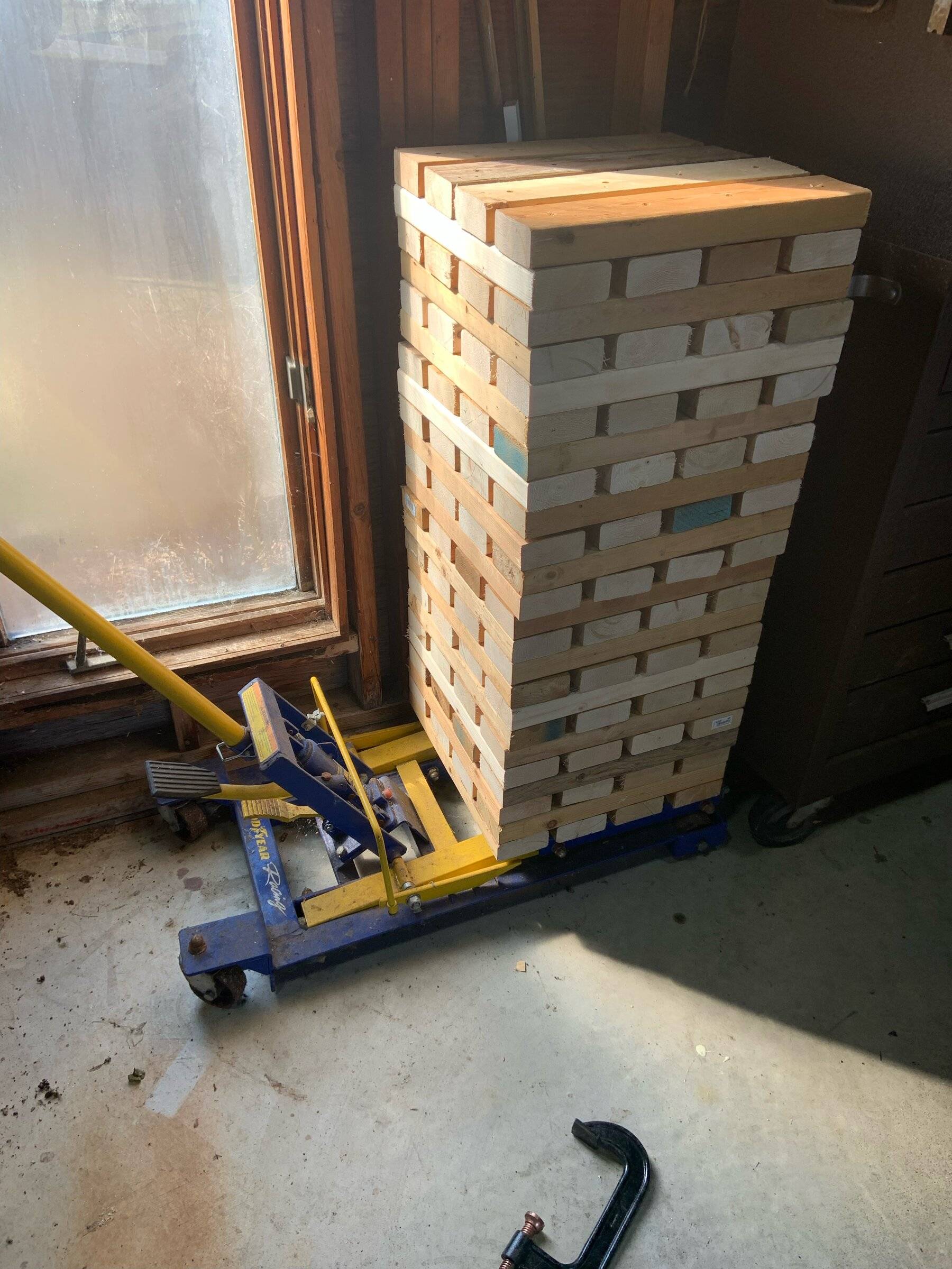

Today’s project was building wheel cribbing. I never feel safe under a car on jack stands, so I made 8 wheel cribs, each out of twelve 16-inch 2x4s. Each crib is 16x16x4.5 and is glued and screwed together for strength. They are used in pairs under each wheel, lifting each tire 9” off the floor, giving 15 inches clearance under my Mustang. They stack up neatly taking up very little space in my garage.
I use my Steeda Jacking Rails to lift one side of my Mustang the full extension of my floor jack. Because of suspension sag, this only lifts the front wheel 5 inches. I slip a wheel crib under each wheel and repeat on the other side. I then use a spacer block with my jack to lift the wheels high enough to add a second wheel crib, then repeat on the first side.
I considered buying the two piece Race Ramp wheel cribs, but they were $209 for only two wheels. I am looking forward to using these on my first oil change next week. View attachment 659506 View attachment 659506

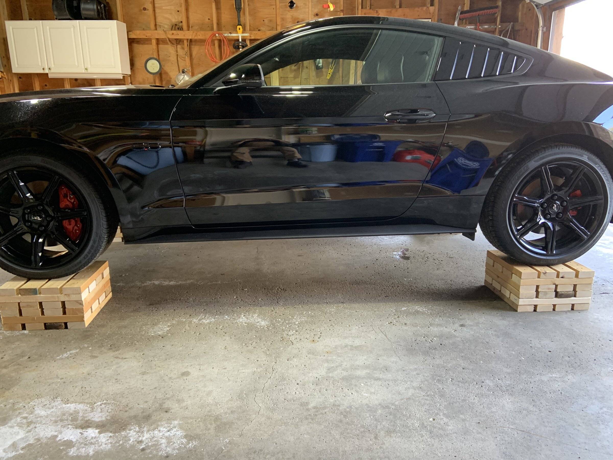

Here they are in use.

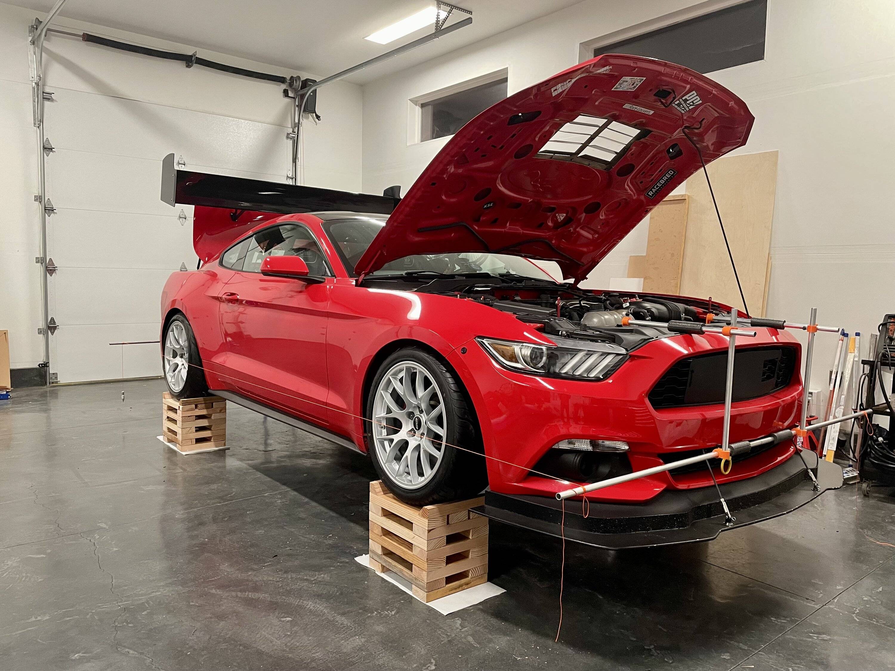

Pretty much the same thing I did, except I only did the outsides which allowed me to run about half the material, and I feel much better about the tires sitting in it.

I want to say 12x16, and using 96" boards, it divides nice so that there isn't any leftover. I run 18x11 and 18x12 wheels, and didn't have any problems or concerns about fitment. It sits a little on the inside as I'm nearly -4deg camber, but still way enough that it sits safe and solid.

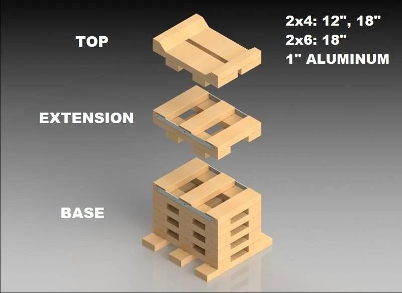

Here is my over engineered version...
Aluminum strips are to keep the top or the extension from sliding sideways. Designed years ago for my other car with 16" wheels, should still work for the Mustang.

Made a set of these as well, thanks for the idea guys. Makes alignments a joy.
