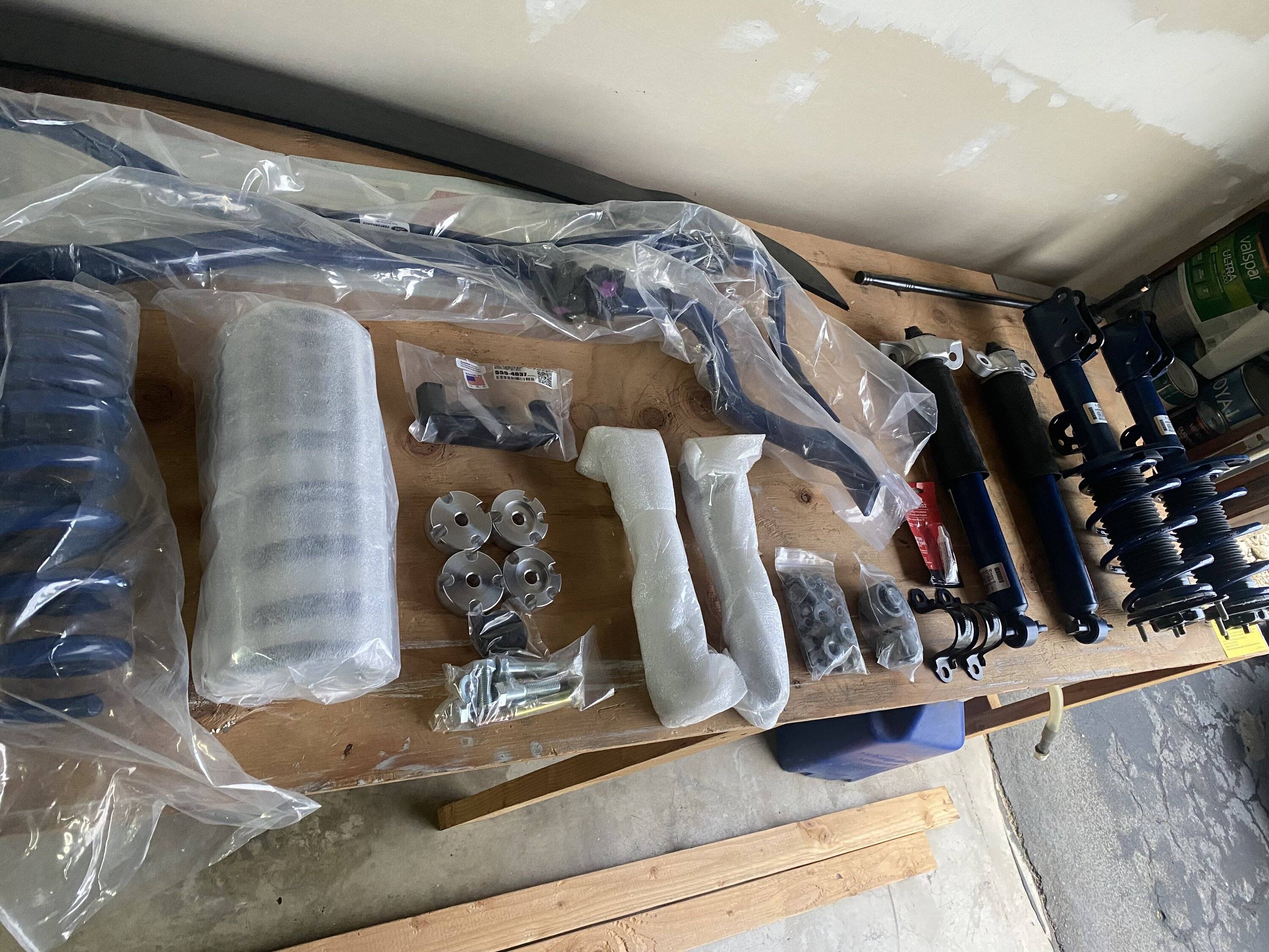

I already have the bolt sleeves and the Steeda inserts, I just hadn’t fitted them yet …
It might actually be a blessing in disguise that I had delayed fitment. I’m pretty sure that bolt was loose from new, probably already weakened and probably would have broken trying to remove it - then I would have been left with the issue rather than ford.
I’ve already spoken to the master tech and the service team and I have a date to take the car in.
They are pretty good and will work with me so I’m trying to make the best out of a bad situation :
- Whilst the exhaust is off - chop it for the H pipe.
- Strip the exhaust back to stainless (rather than the black crap we get on the euros).
- Whilst the cradle is dropped - Steeda red bushes.
- Stainless bolt sleeves.
- Steeda subframe supports.
- Steeda subframe alignment.
I don’t think I can swing it to drill for though bolts, but I don’t know if I want to and I suspect I won’t need them anyway.
I’m suspecting an alignment will be needed afterwards so depending on who they use, maybe I could pay an upgrade to get a fancy (rather than basic) job done.
I’m just going to have to see how this all pans out and keep my fingers crossed …
