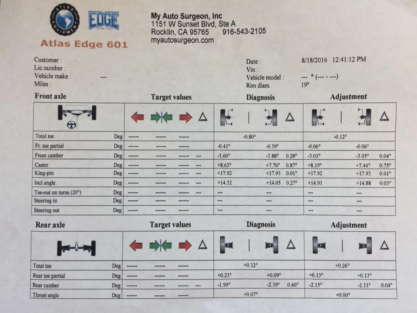

Thunder Roadster GT-R / ST3
Went in for alignment after last round of mods (relevant to alignment are BMR Handling springs & sways in middle position, Koni struts/shocks, Steeda Camber Plates & clearanced strut towers to allow max camber, BMR cradle lockout, Steeda diff bushing - black polyurethane).
After reading through this thread, I decided on a starting point of;
Front
Camber: -3 degrees
Caster: max and even desired - but my setup is non-adjustable currently...
Toe Out: 1/16th
Rear
Camber: -2 degrees
Toe In: 1/8th
Here's how the alignment ended up. Very happy with my camber and toe at both ends, and caster ended up being 0.75 deg different L/R.
The tech was pretty knowledgeable about track setups, and said that this could be due to my local track being 75-80% left hand turns when run CCW, which it almost always is. More g-loading on that side can make all the tolerances in the front end components creep to one extreme.
