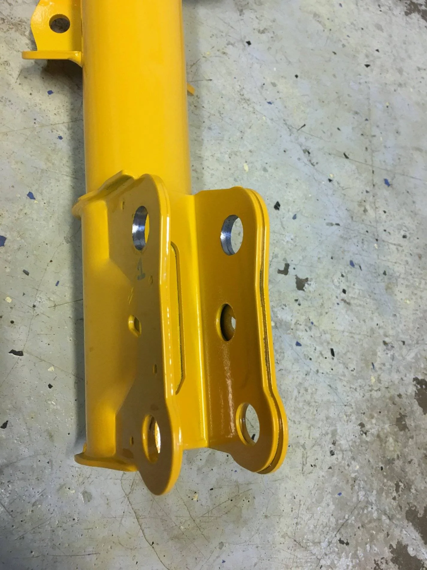

There's no factory camber adjustment up front. Unless you have camber plates or bolts you're stuck with what it is.
You need to grind one of the strut bolts holes 1 mm. There is a ford service manual specifying this procedure. I doubt a shop will spent the time to do it. Best done with a Dremel and a beer.

Stock front camber isn't adjustable unless you modify those bolt holes, so you get what Ford gave you. That said, grinding the front strut holes is very easy work with a basic dremmel and the default grinder attachment.. The grinder fits the hole perfectly. Getting exactly 1mm is another matter. Get new strut to spindle bolts if you're going to grind those holes so you get the ideal clamping force from fresh bolt stretch, reusing old bolts will increase the chance that that bolt will slip on you. I've had them slip multiple times. The other way to reduce slipping is to weld 1mm of material back in on the other side of the hole (which isn't hard either, all you need is a nub of material to keep the bolt in the new location). The procedure is 1mm on the top hole only, and remove material towards the strut body so you can tilt the top of the spindle in towards the center of the car. You'll get less camber than you want this way, but its better than nothing. Honestly tho I'd just wait until you get some Konis or better shocks and do it on the new parts.

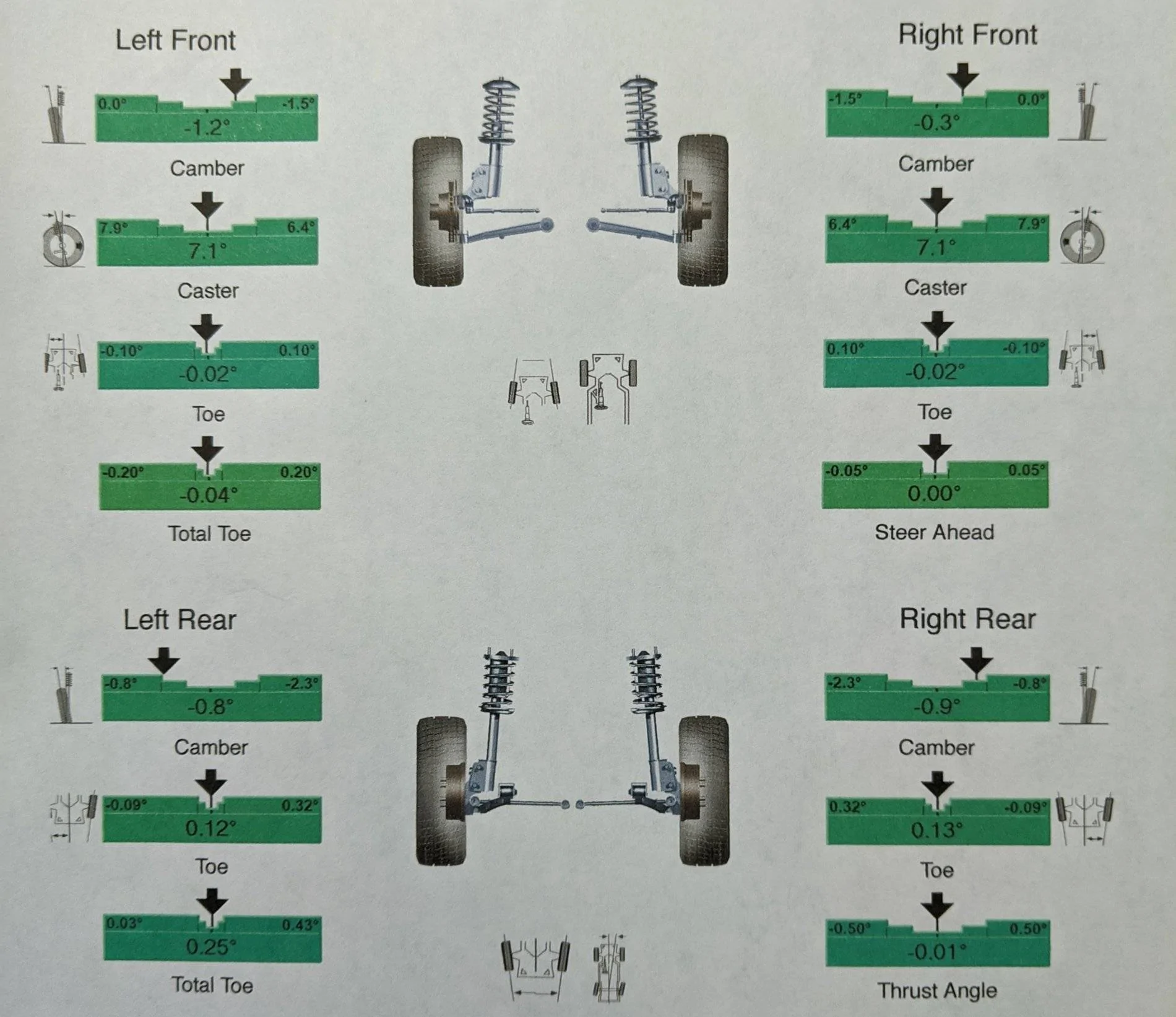

Thanks for the responses everyone, I appreciate the insight. Thanks Labradog for the chart, looks like a good place to start.

Not much luck with the front camber (right camber especially), but was able to dial in most everything else. I realized today that with my tri-ax street shifter w/ bushing and jacking rails, I will have to class in CAM-C next season anyways. So...maybe its time for some camber plates and upgraded dual sway bars.
