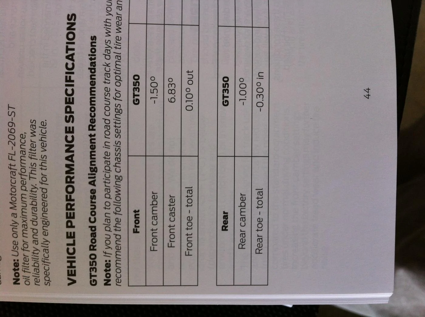

Attached is the GT350 PP track specs for interest.
