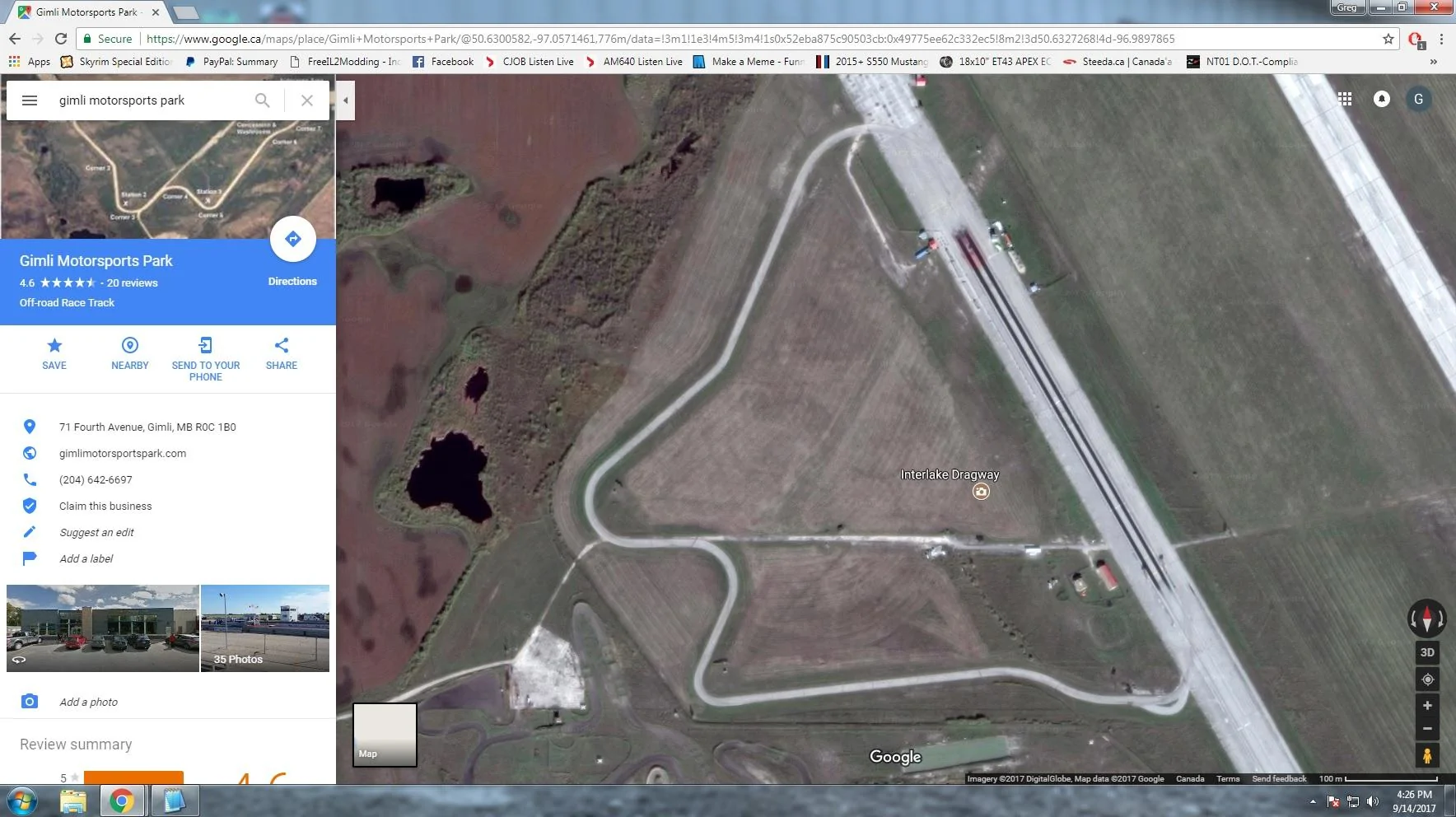

Aah my fellow Winnipeg townsman.
I'll be at Gimli tomorrow for the test & tune.
The surface is pretty rough and the race line is surprisingly challenging with early apexes and that last squiggle when they run it. There's a lot to learn there even with a stock car with a relatively soft suspension. The scariest part is probably T3 because you run out of asphalt pretty quick for an early apex from 160 km/hr. Guys get a bit of air if they end up running off. The only higher speed turn is T1 (which has a pretty hilariously big bump that sends the formula Vs flying a good foot out).
Car definitely needs camber though. I've got about 2/32nds delta outside in on the fronts.
