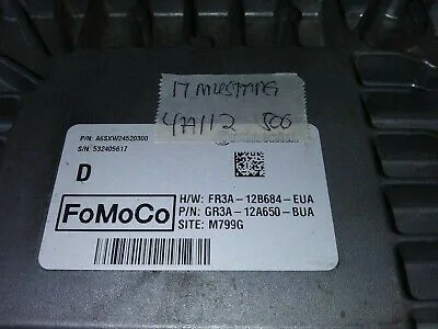

https://www.ebay.com/itm/2017-Ford-Mustang-ecm-ecu-computer-GR3A-12A650-BUA-/154309772227
I have seen this one from eBay but those people are crazy they are selling that PCM Used for $500 when the dealer sells it Brand New for $388 lol ☠. I’ve tried to have them reason on the price but they stated the price is firm because they are the only ones that have it.

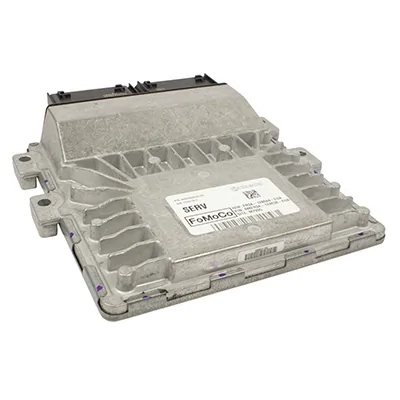

https://www.southfloridafordparts.com/oem-parts/ford-eec-module-fr3z12a650euanp
in there they have this picture of it but you can’t really see the PN and HW of it
I’m still confused ... and not even the dealer knows how to explain it...

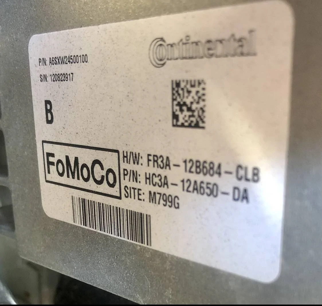

Not understanding your confusion. Your dealer can insert either number into his system and you PCM will come up. The label on the unit on eBay and the dealer are the same. It’s a Ford label.

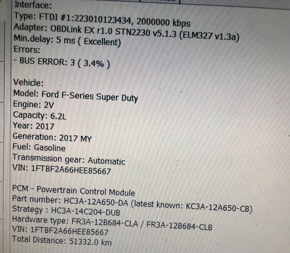

A Ford certified tech guy recommended for me to buy this PCM from eBay that came off a 2017 Ford F250 6.2l automatic, he said it would work once programmed and it would all be good to go. Part number on this one would be HC3A-12A650A-DA , here’s a picture of the sticker on this pcm:
And here is a picture of all the details of it retrieved from FORScan:

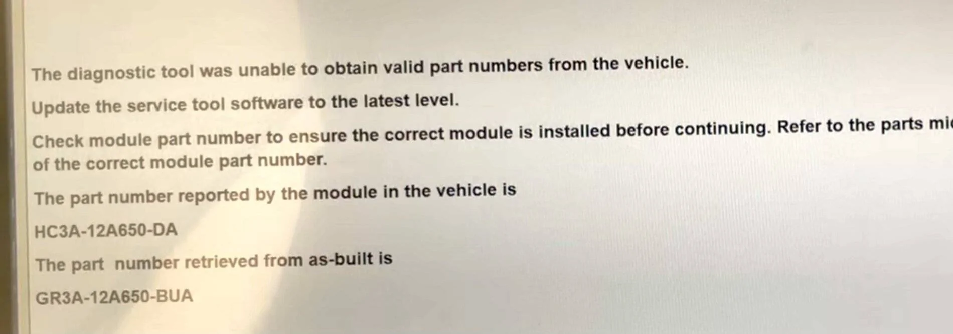

NOW, after this PCM has been programmed to my car I can’t upgrade the software on it and look at what the Ford IDS tool says using VCM2 on my 2017 Shelby GT350:

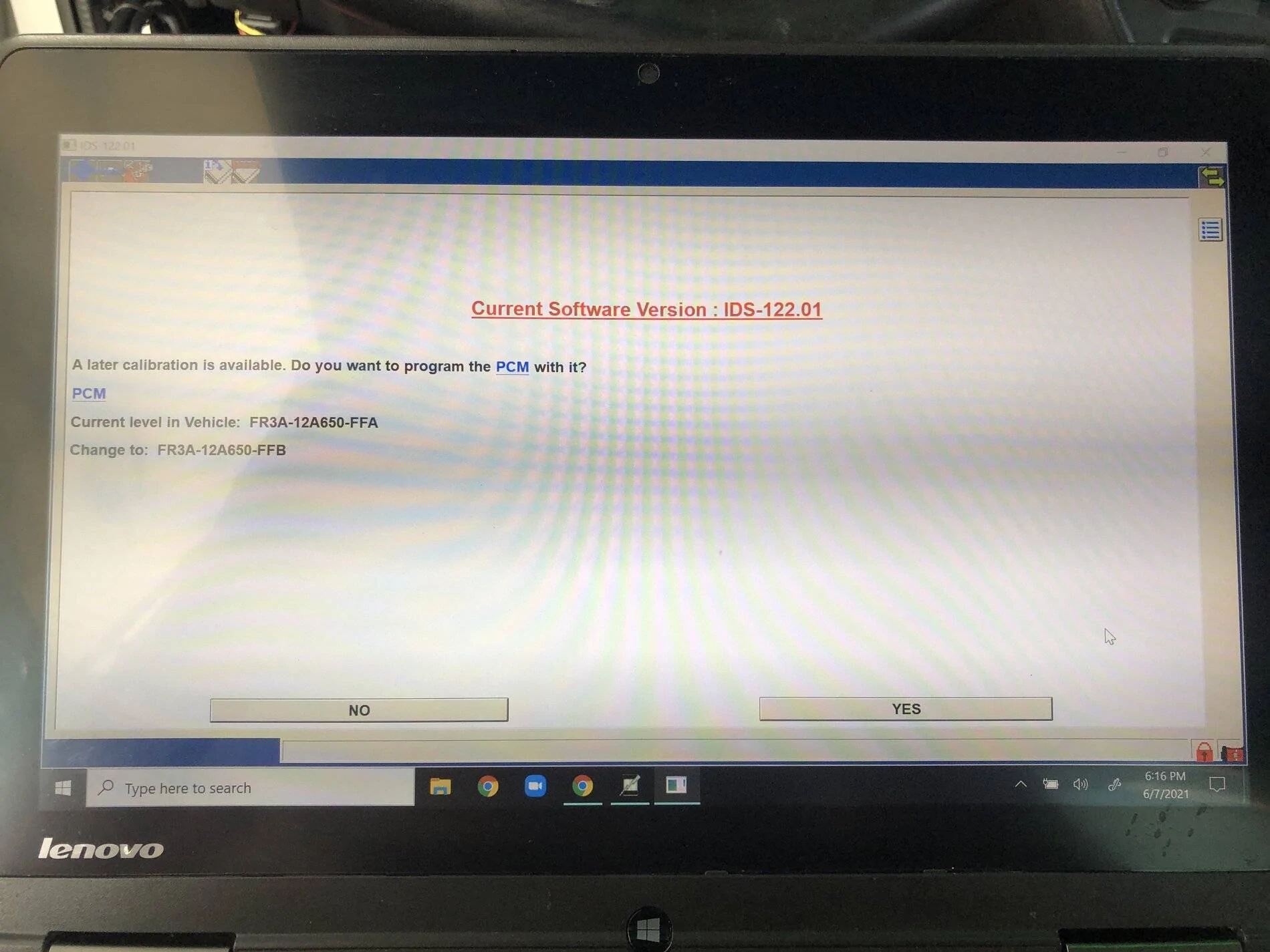

This is the action I’m trying to perform when i get that message about the part numbers miss match:

This is why I’m worried if I don’t use the exact part number GR3A-12A650-BUA that the same thing will keep happening.
