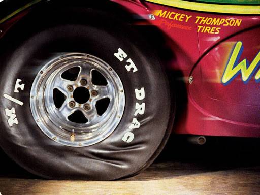

To explain why a good launch is so vital, basically shaving .1 second off of your 60' translates to .2 seconds off your ET in a 1/4 mile race. Each tenth of a second in the quarter is about 1 car length. What you want is a tire that collapses the sidewall when you launch to create more surface area (see pic below) then stands up tall at speed.
