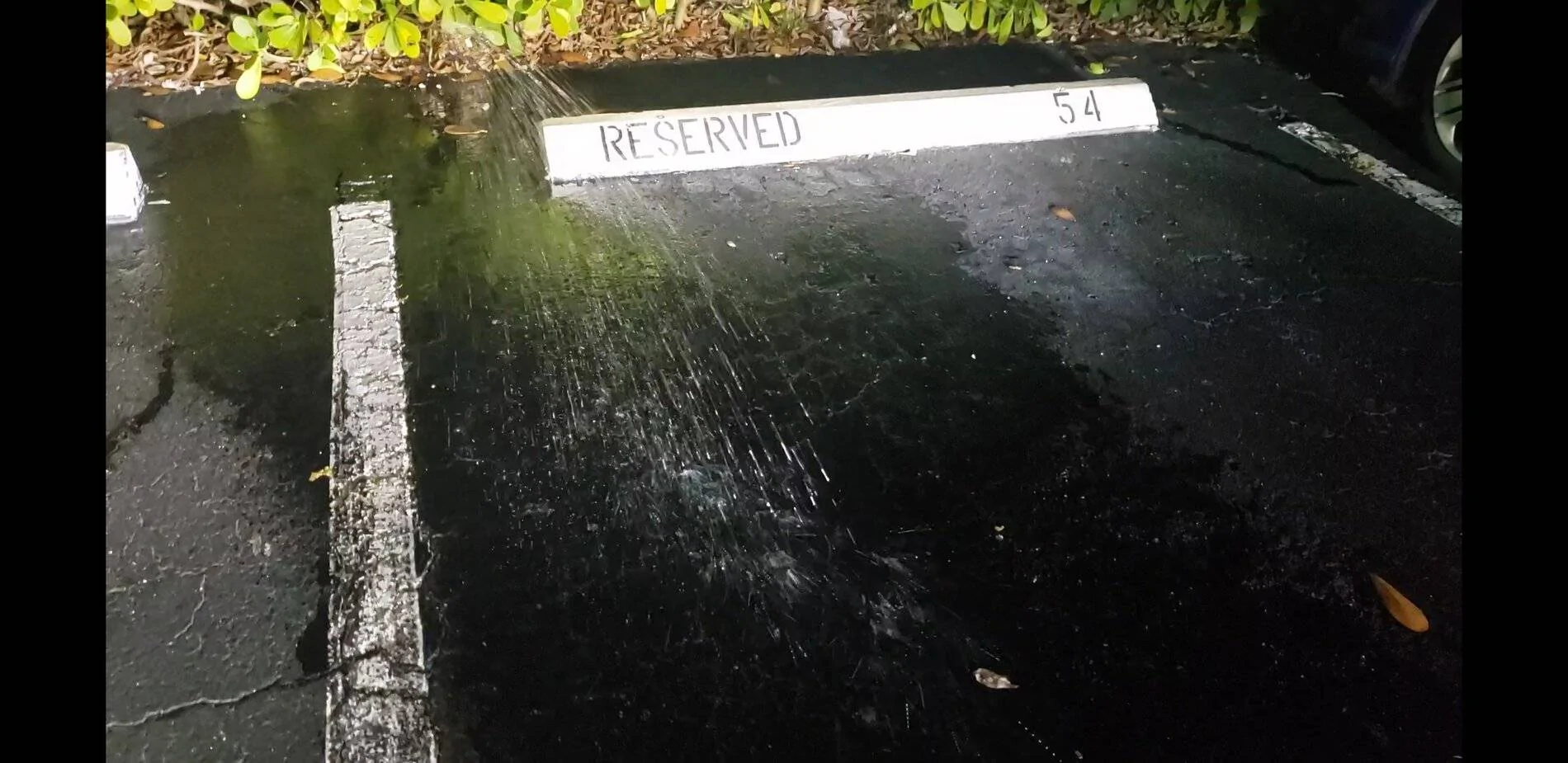

There's some hard water spots from a sprinkler I wasn't aware of were I park(assigned). Bottom flat part of the front fascia has the spots. I tried white distilled vinegar but barely anything. Looks like a light polish is all I can do? Then apply new ceramic or just leave it? I've got a quick easy cardboard barrier between the culprit and my car now.

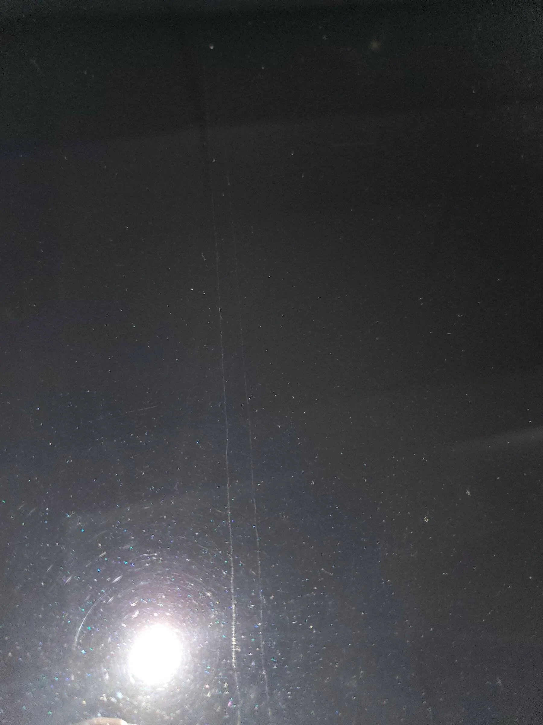

Here's a pic of my water stain that won't come off.
I had some bad hard water streaks that left long water/mineral stains etched in the clear coat. It's from the water dripping across the hood and drying before I noticed. They look like long micro scratches up close, almost 3 feet long. Just ordered a bottle of the carpro spotless 2.0 spot remover and hope it works out. Did you have to wash the area with water after every application of the spot remover? I read it could damage the paint if it's not used properly.

Ideally, you would wash the car prior to using Spotless so you are not rubbing dirt/dust ect into the paint. You could also water-less wash just the panels you are going to treat.
Any product comes with risks, used as directed you will be fine.

Yeah always try to least aggressive method first (water spot remover). If the clear coat has been etched, then a polish is pretty much the only solution. Try a finishing polish, then get more agressive if needed.

How the hell does a water streak leave so much damage to the point it looks like a 3 foot long scratch... it was right after I washed the car too.

Hard water will do that. I suggest a different water source to see if that helps avoid more streaks.
