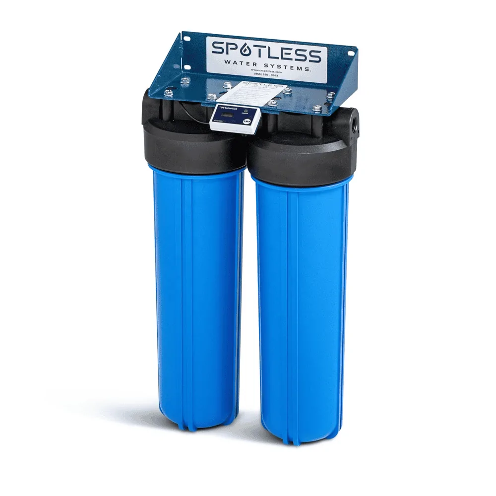

I can highly recommend the Spotless DIC-20 D ionizing rig.
at $400 is it worth it? How much water can it filter? I'm assuming more than enough for a full wash?

Albert: They claim that you can get 300 gallons from the resin carts. I back off the PW to 600psi which yields about a gallon/min. That equates to 300 minutes of rinsing. I've timed myself and I can rinse an entire vehicle in five minutes or less so about 60 rinses for me on two carts.
I have softened water at the house so it's pretty good to start with and I only use the DIC-20 water for a final-final rinse (I rinse the soap off with house water and THEN I rinse with the DIC-20.)
When I first got the rig, I tested it on my F250. Same wash routine but after a DIC-20 rinse, I let it sit in the south Texas sun. Virtually no spots which is why I recommend it.
I wash cars frequently and I just put new carts in after a year or so of washing. About $125/2 carts.
