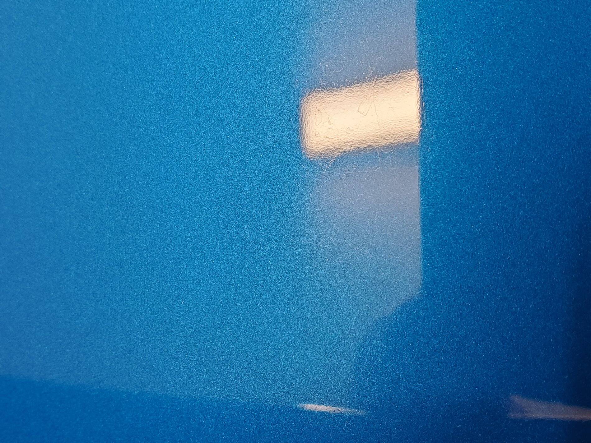

So I was able to get most of the water spots off with multiple passes on the clay mit. There are still some under the rear spoiler (where the trunk lid flattens out) and there are a lot of water spots on the rear glass. I did try vinegar/water as recommended by another member but it did not work. I have some Chemical guys VSS (scratch & swirl + polish) that I was thinking about trying on the paint. I just used it on my 15 F-150 and it looks great. I just don't want to do something that is going to scratch the clearcoat (ie. make things worse). Am I better off trying to buy some water spot remover or trying to polish? Overall it looks pretty good now but if I can remove all of the water spotting before I wax that would be fantastic...

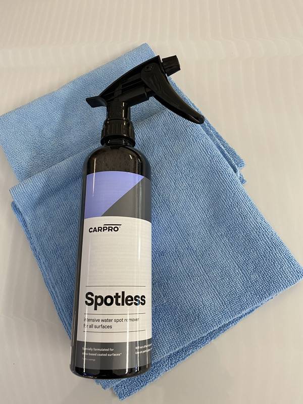

+1 on using Carpro Spotless. It works like a charm.

Robert: I am a CP fan but have never tried Spotless so I'm gonna give it a look see after your remarks.
OP: If you opt to polish the spots out, a Rupes yellow or white pad and Meguiar's M205 will quickly remove them and, add a killer shine. That said, if Spotless does the job, it'll be much quicker that way but, you won't get the polished shine.

Thank you for the input. I do think the car would benefit from a light polish - I don't want to remove any more clear coat than necessary though. Does anyone know the difference in aggressiveness between chemical guys VSS and meguiars M205? If I do polish I want just enough to take the water spots away but minimal clear coat. I read somewhere that the clear coat on the s550s is fairly soft compared to other vehicles...
