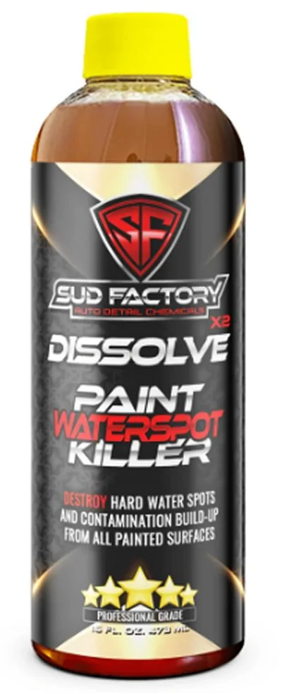

I had good luck with a product from Sud Factory. they have products for glass and paint. I used them on wife's MKX and my 34 year old Corvette.
