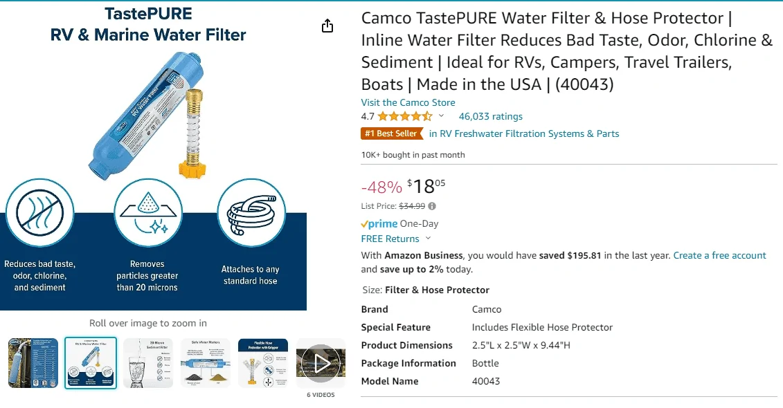

OP: The problem with something like that is, it is only a filter and carbon, so it will only filter sediment and remove some chlorine taste and odor but it won't remove dissolved solids as a softener cartridge would. The filter you have is more for improving drinking water in an RV.
Therefive, if your municipal water is not too hard (TDS) this will help but if you have a high concentration of dissolved solids, (TDS over 100,) you will get water spots if any water is allowed to dry on the painted surfaces.
Softening is the only way to avoid spotting.
