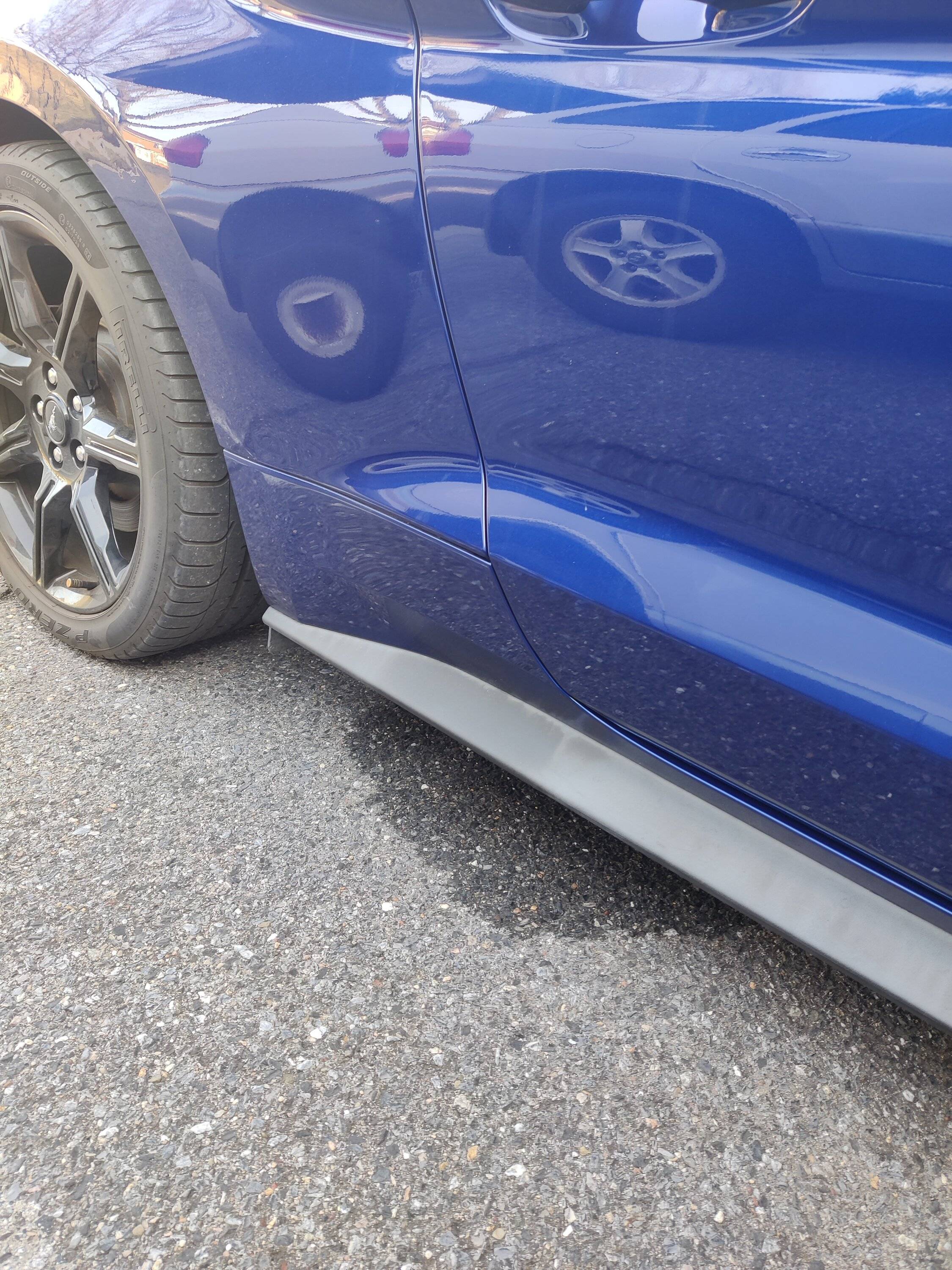

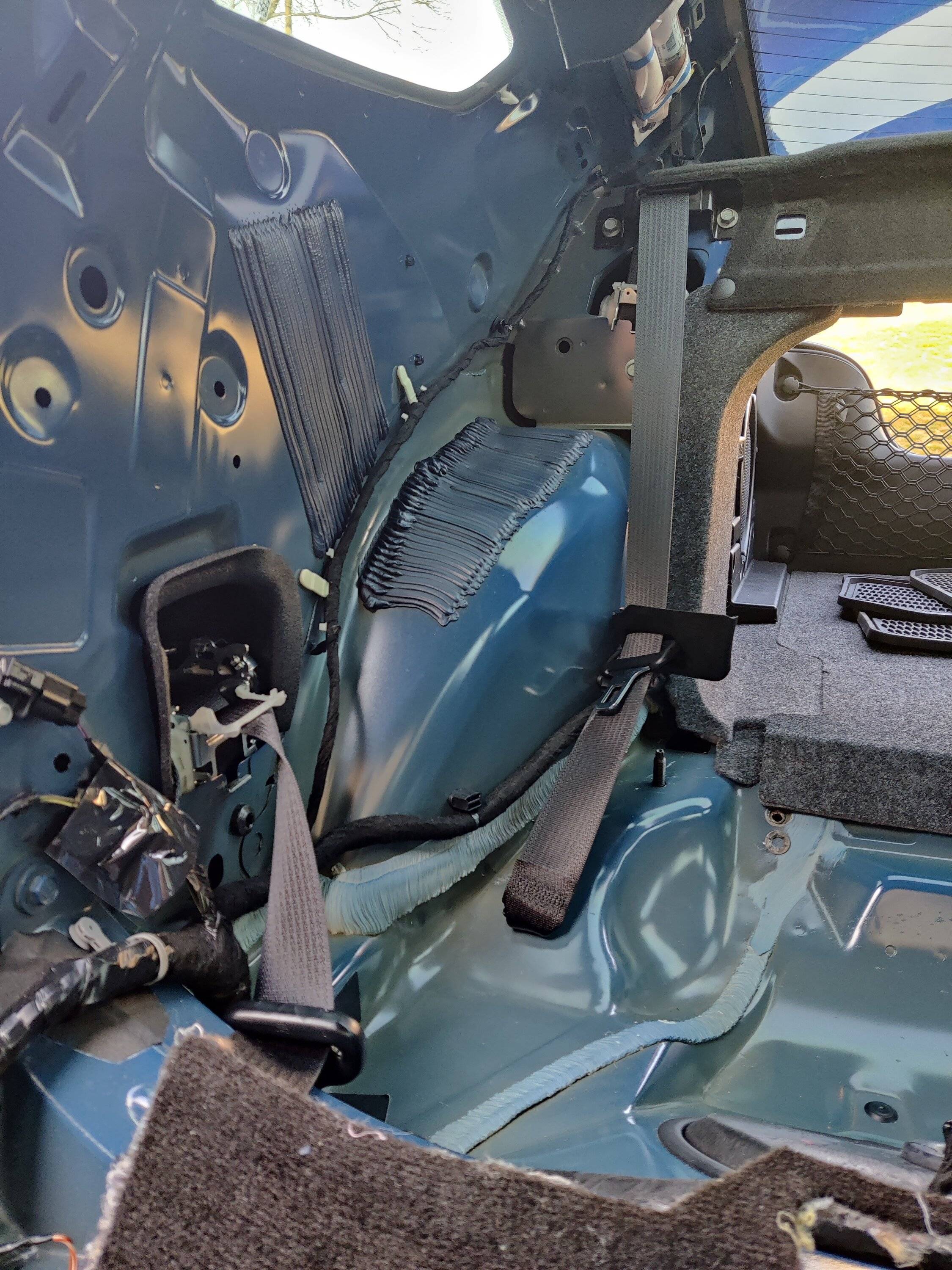

So many leaks in this thing it's driving me crazy. So far 2 have been fixed. Front windshield seam, and third brake light. There is a leak somewhere coming from the wheel well area, and I notice puddels in front of the passenger rear tire even when it's not raining. The inside is bone dry, so I dont know where or how to access this area. ANyone go through this? Thank you for any help!

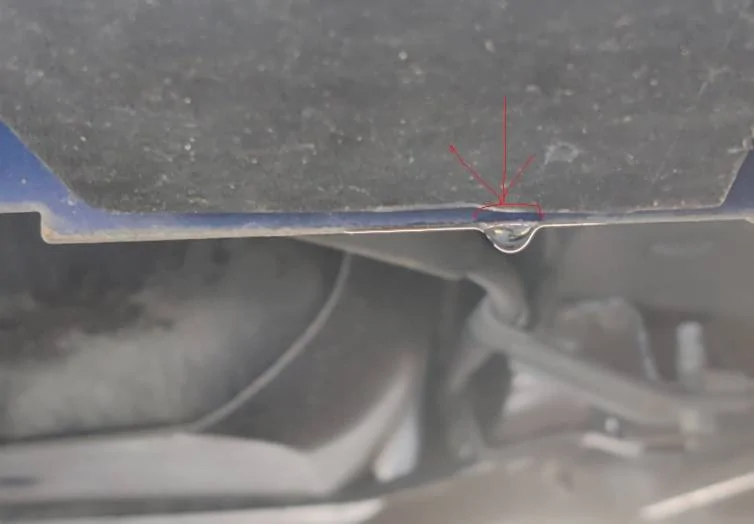

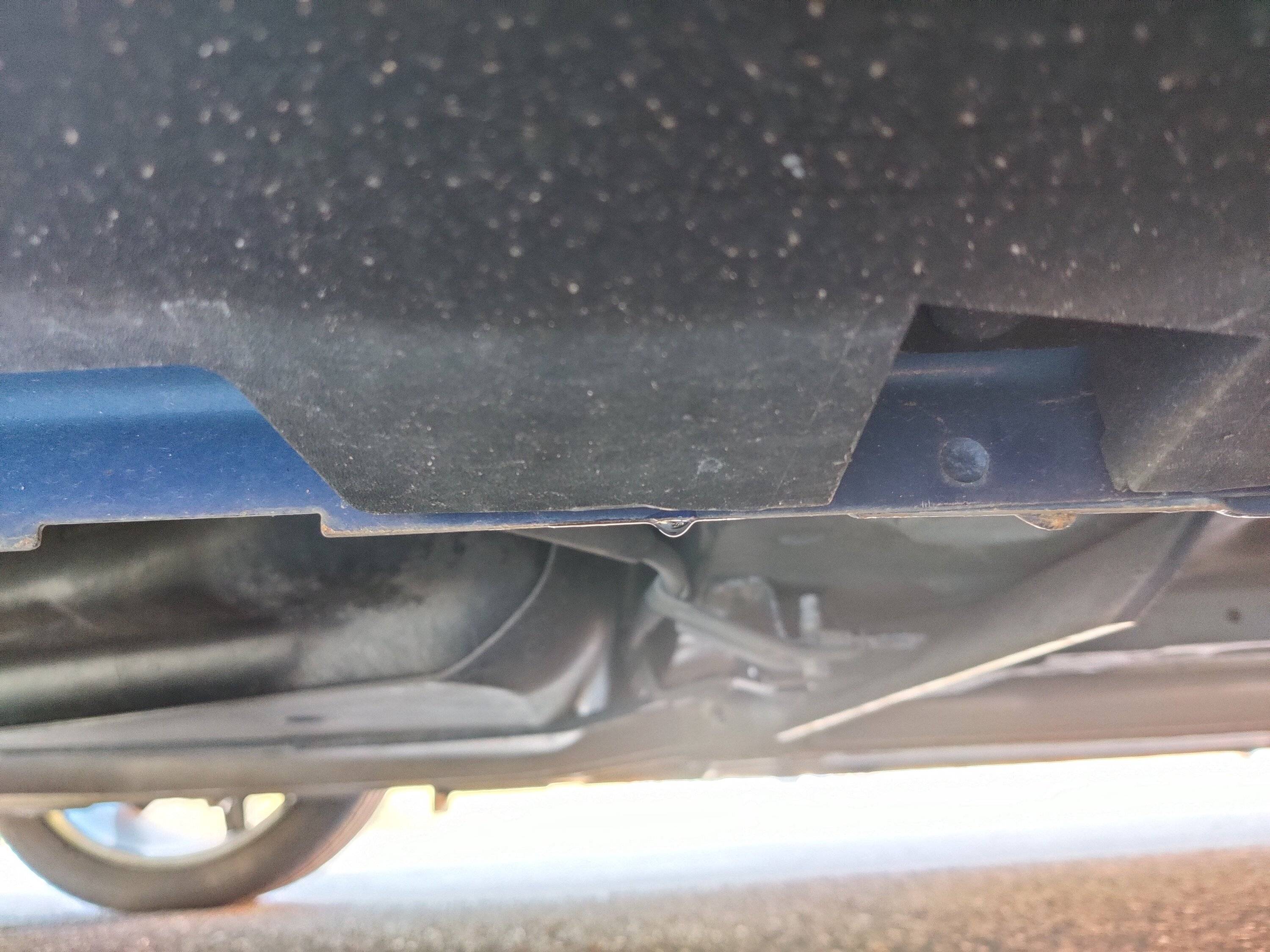

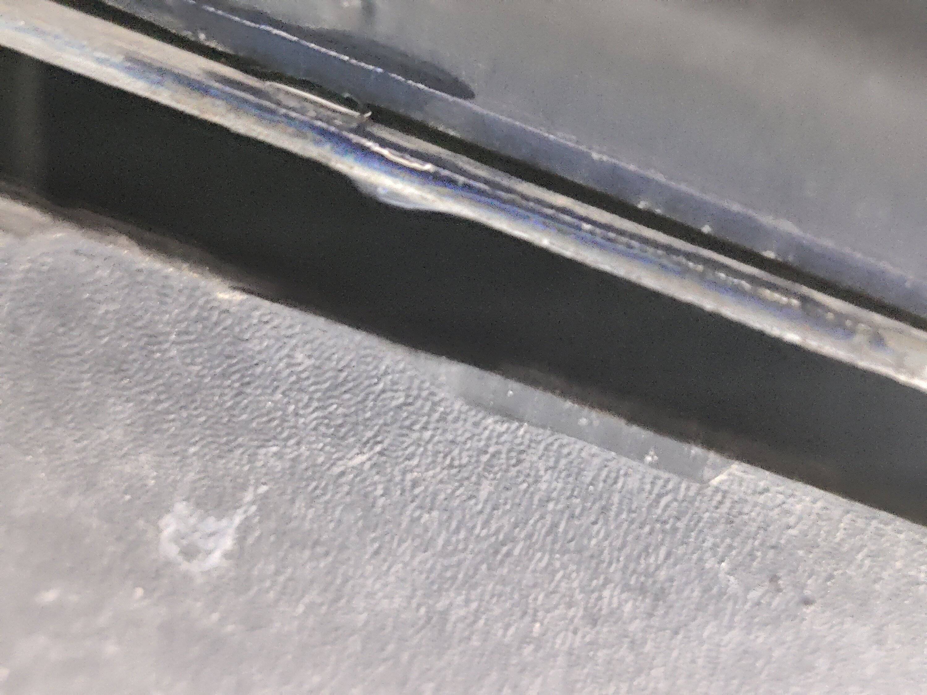

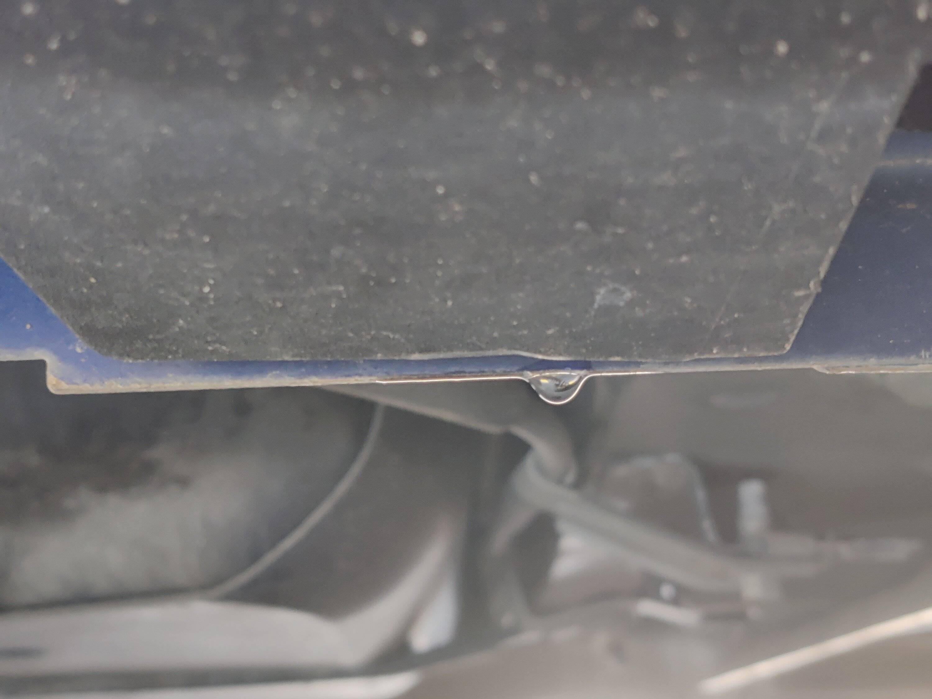

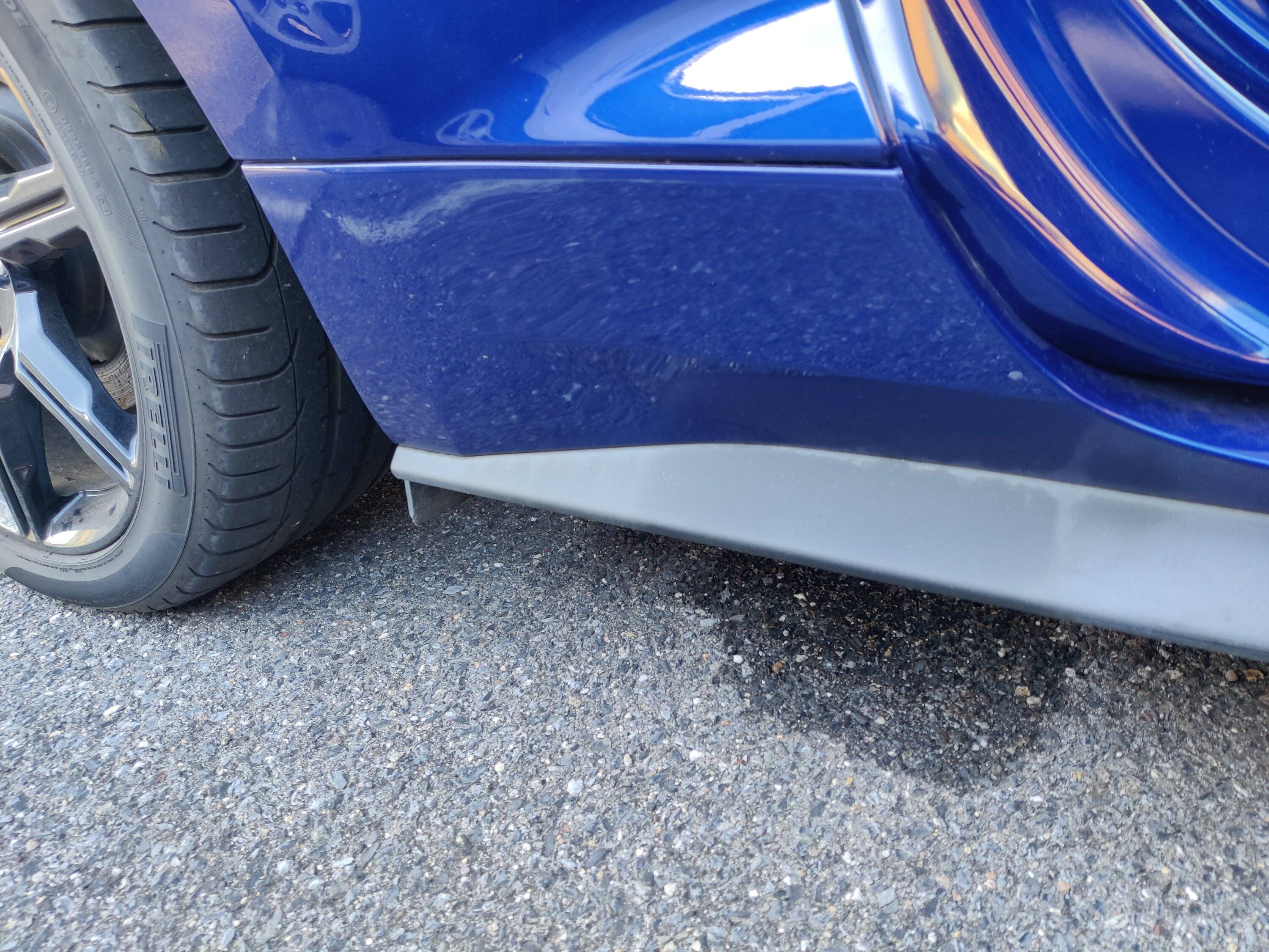

They are huge puddles under the car. On sunny days. I've never used the AC or defrost in this car. It's not coming from a drain it's coming from a seam underneath above the quarter panel window

This is the back end of the car

R U Sure it is coming from the seam, and not collecting on the plastic rocker ex. and dripping off that plastic part near where it is shown in your photo's.
I say this because if it was coming out of the middle of two sheets of metal, the outside of the metal would not be wet. and it looks it. if it was seeping from the spot welded seem, it not run up the outside of the sheet.

Check the door drain holes. it could be draining slowly, onto the rocker, and then down the underside.

---- Also to note I thought your thread looked familiar too.... You had already created this thread which is nearly identical in nature .... and I also had posted in that prior thread several areas to check on an S550 for water leaks. It had appeared you found or narrowed your research and fixed maybe 1 or the possible leak? I'm confused I guess because the images are the exact same in both threads now (past and current).
https://www.mustang6g.com/forums/threads/floor-pan-patches.185211/#post-3726855
Just a helpful tip:
We can help better if sticking to and remaining in the original thread, so that we're not on a wild goose chase trying to diagnose something that appears "new" that may have already been worked to diagnose previously. :)
Looking closely at your images again, the black plastic rocker appears to be damp. With that said, at the corner of your passenger door, there also appears to be a witness mark that is stained diagonally on the exterior metal and flows down onto and off the black rocker as well. This would be indicative of water draining from the door onto the inner rocker (metal), then "weeping" out from the corner onto the exterior metal and down the black plastic rocker.
Another thing too - we can't tell from the images if the car is totally level, or if it's sitting on a pitched driveway/road surface. The way your images were taken it *almost* looks like the surface is pitched down, meaning the car would be angled with the rear sloped "downward" - and if so, all water from within the door is going to drain "backward". Even the slightest pitch will cause this and if prolonged, the witness staining will be more obvious (on any vehicle) as that would be the path of least resistance for water draining IF the vehicle is always parked in the same manner on the same surface.
I could be totally wrong, but making your pics larger - that is what I'm seeing in the images that would cause that pooling in that spot.

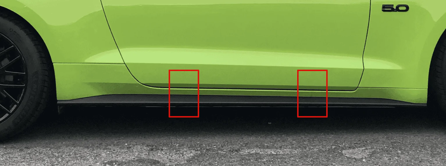

The door water drains are here :
I still get waxy residue coming out of them (enlarge the above photo), staining the paint and the plastic rocker that requires periodic cleaning to remove ...
The mustang window seals are crap (they let a lot get inside the door) so once it exits the bottom, it's at the mercy of gravity and the angle of the car to determine where exactly it will finally drip off onto the floor :like:
