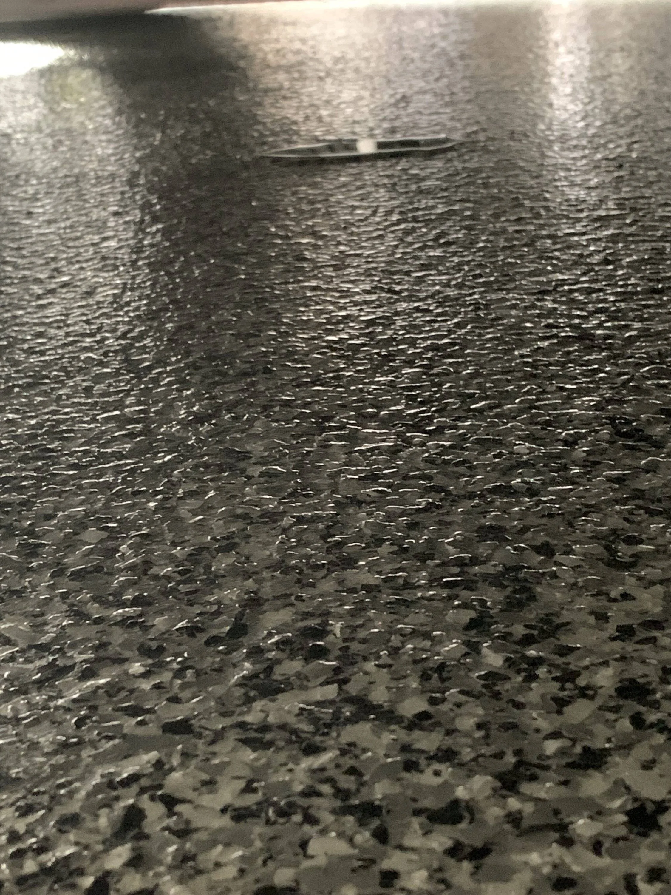

Hi everyone I’ve just finished crash rebuild mustang starts and runs fine however yesterday I let it run for a while for a while and experienced a coolant leak at the bottom radiator hose ( my fault wasn’t fully clipped in) but also water was dropping from onto the driver side (rhd ) exhaust when I went underneath It seemed like it was coming from somewhere above the transmission but it wasn’t coolant as it looked like clear water any ideas what this could be ?

Reads like you've had a lot going on. England. Check. EU spec.
I can see the liquid is clear. Any chance this is condensation from the air conditioning unit? You've been doing a lot of mechanical work. Nothing more than water which had been resting and is now being freed up?

Hi thanks for getting back That’s what I’m hoping it is not sure where the ac unit would be sitting could it be the ac drain tube ?

Mine drains on the right side of the car, the Driver's side in England. Could be Ford left a lot of the bits as-is versus reversing all the connections and areas involved.

" it wasn’t coolant as it looked like clear water any ideas "
Taste it, if its water AC, condensation as posted above.
and no you will not DIE.

Didn’t know that’s actually a thing but fair enough but it’s dried off now unfortunately

Well that's a good thing, one less thing to worry about :thumbsup:
Thank you for the help I’ll start it again later today and see if that was actually the problem

If your AC compressor is kicking on because you have the windshield defroster or AC in operation, it’s most likely what it is.

any modern engine will never leak CLEAR CLEAN WATER.
that is condensation from AC.

Like others have mentioned it’s more than likely AC condensation. Mine did it the other day under the trans and made me a little nervous till I cleaned it up only to find it was AC condensation
