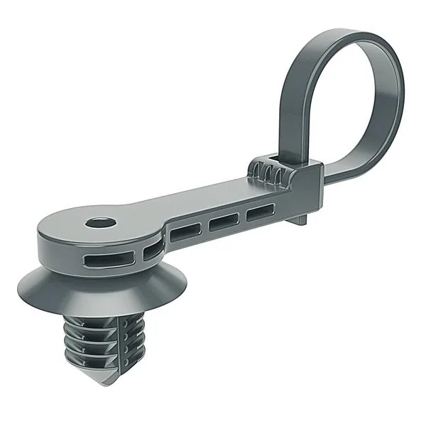

Got a surprise call Friday evening to alert me my car would be done Saturday. From first glance at the engine bay, JOB WELL DONE. However that is not enough for me. Once I got home I put her up on the quick jacks and went to work. Removed the splitter and belly pan and spent some quality time inspecting the work. Here is where I found some things not to my standards (pics to come).
I found one standoff installed but missing nut to secure in place, I replaced the nut. Found several fir tree (Christmas tree) cable ties not installed properly, installed. 3 of these fasteners were worn out and not reusable. I tried every parts store open on Sunday and nobody has them. I will probably have to go to Ford and have them ordered.
In the mean time I made my own with nylon clamps and fir tree push pins, did the trick. And lastly, the speed nuts that secure the splitter were toast! No surprise here as they are really fragile and should be replaced after every use. Replaced speed nuts. There is one fir tree standoff tape clip that is really bugging me but it will be so hard to get to. It secures a wire harness to the block just under the head. I see the tree side of the fastener and it is toast and frankly I am ANAL! That one will have to slide as I do not plan on fucking with it due to its location. It is in place and there is no play in the harness.
That’s it!!!! I am rather impressed with the install and satisfied. All my gripes are rather minor and most might not even bother replacing what I replaced.
