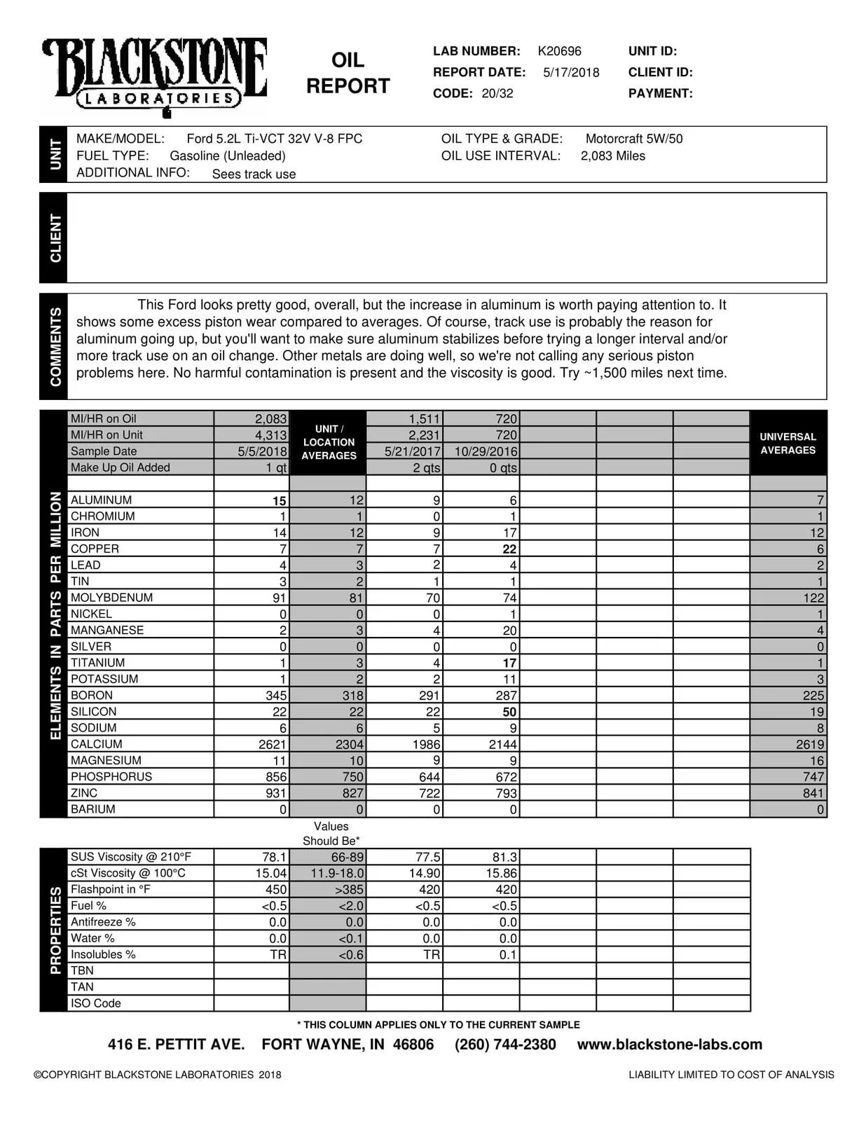

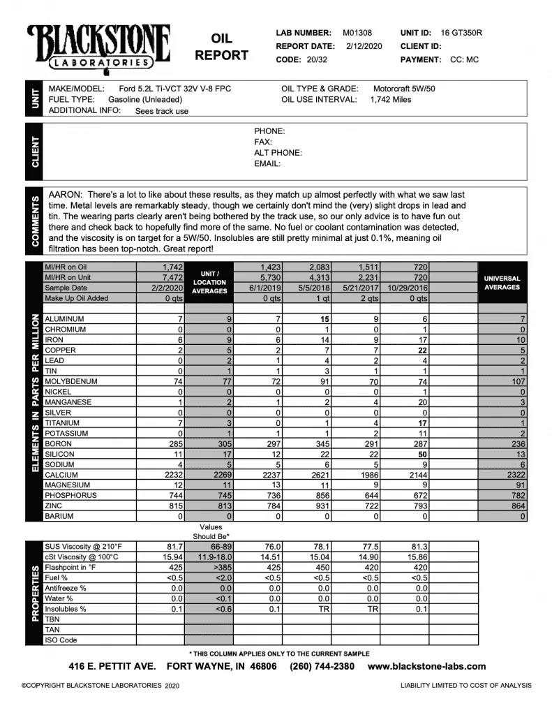

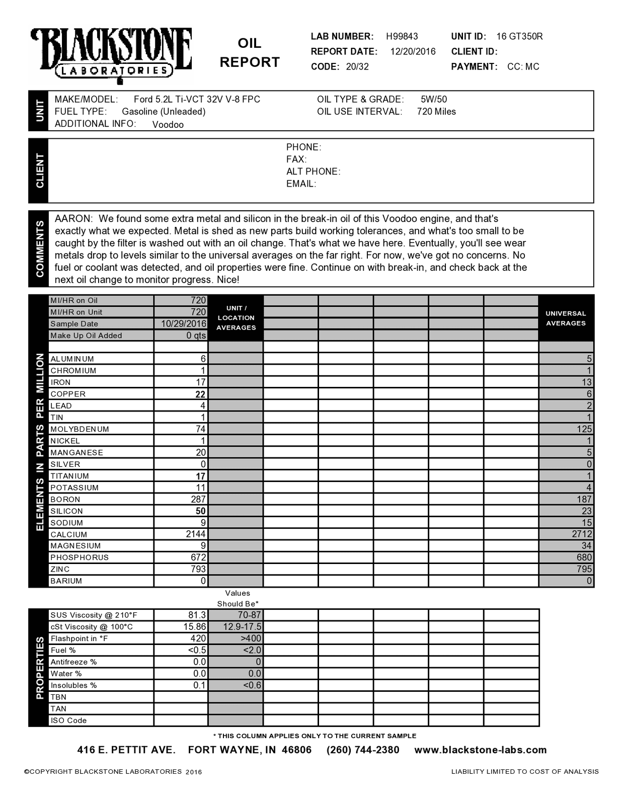

Latest. Seems I lucked out with this engine.
