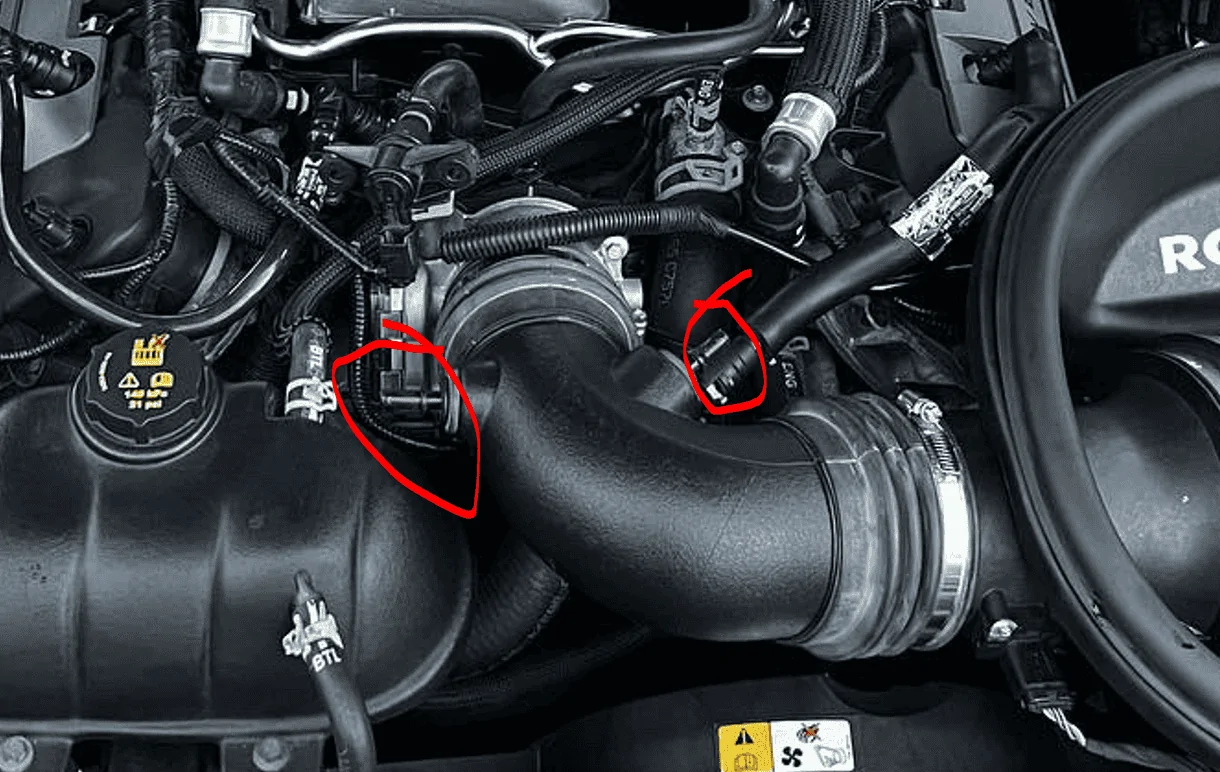

So I've been having this issue with my car for a while and I figured out the issue. For me, I have a Roush cold air intake. These two barbs had holes on them that were not plugged, which I never noticed LOL. This was causing a vacuum leak. Stupid me for not realizing, but it's worth checking if you have an aftermarket cold air.
