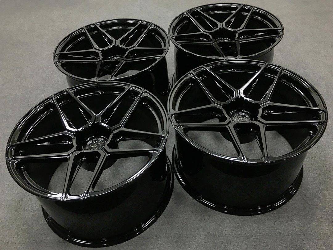

Good news, is the CFTP springs + @signature wheels should arrive this week as well :)
4 20x11.5 SV701
2 18x11.5 Matching SV701 for the MT ET Street Rs ( also ordered)

Steve, these wheels are MINT! Whats your plan for sneakers? I would like to use my stock rubber, and I would prefer 11.oh" for the front, and 11.5" for the rear.

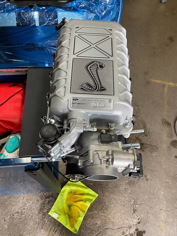

Got any shots of the Whipple throttle body?

18's... nice! GT brake swap or?
No, brake swaps is not something i dont want to consider. If indid, id go even smaller. These should clear the brakes no problem
Im going to use same rubber I have. Normally i try to shave weight from tires as well, but the ps4s are actually the lightest i can find in this size. R888R staying on the back for traction amd normal use.
18s wrapped in Mickey Thompson ET Street R's
The plan is that when i do drag race, i have a dedicated set, if i go play, i havw a dedicated set.. and for some reason if i make too much power for the r888r to handle on a normal basis, i have a matching option
Yes please
Prototype, gonna have to wait on that

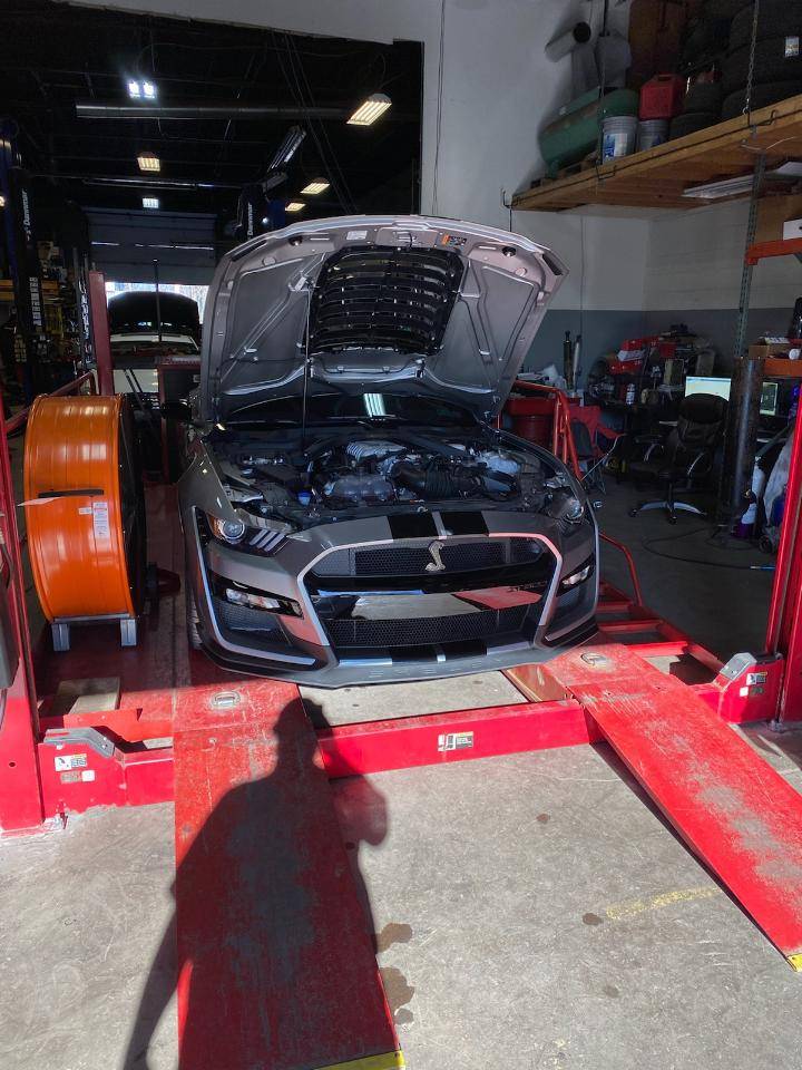

Radiator swap is done. Back at Mopar Addictionz ready for more work. Full length stripes look badass, as well as 360* tint with ppf+ceramic pro
Tomorrow they will baseline dyno, pull supercharger and send off to 1320junkie for port work.

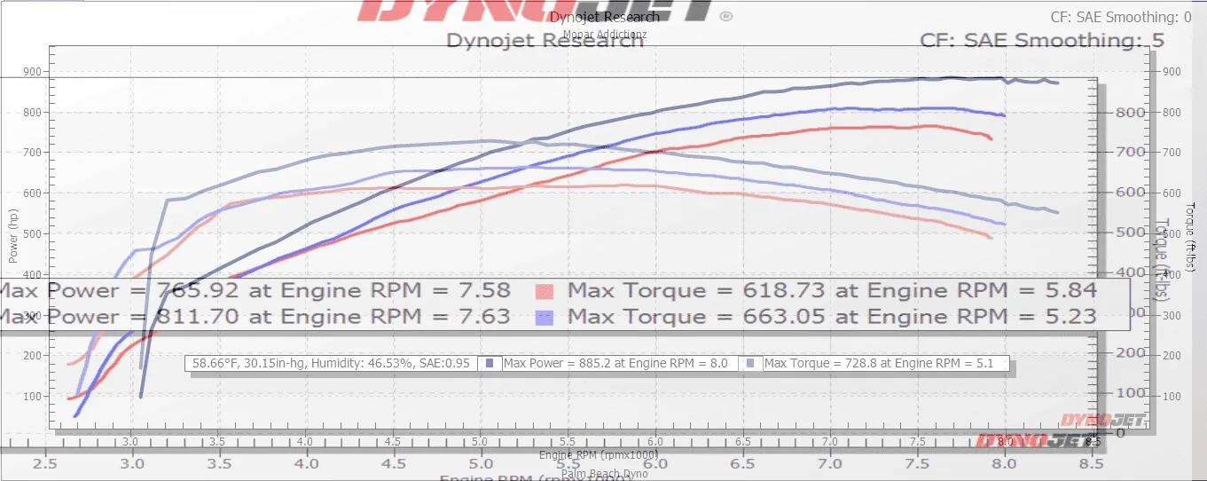

took longer than expected, a lot longer.. but we made some changes along the way.
I hadnt originally wanted to go to a smaller upper pulley, but since i had downtime, i decided to.
Recap:
PBD tuned
2.75 Pulley
AMG X Pipe
ID1050
765HP 93 octane
811HP E85
Added JLT Intake and 2.65 Pulley, retuned, gained 70HP on E85 to net 885RWHP on E85.
Excuse the rough overlay, but i dont have the .DRF files of the 765/811hp dynos
The Best part is, Blower is off and ready for 1320Junkie to port, and a LateModelThrottle 105mm Throttlebody

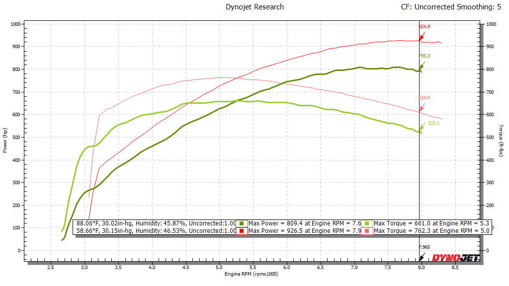

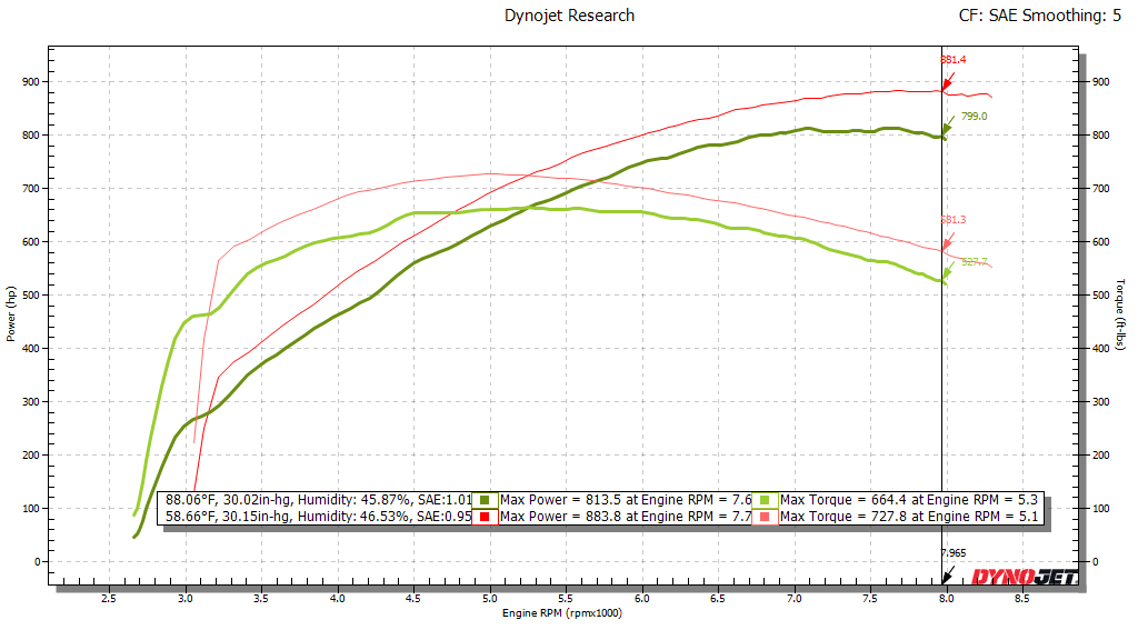

Ok, got the files for a cleaner overlay.. THIS IS WHY DYNOS MUST BE IN SAE
Im very excited now. Everyone talks of good DA when racing, but you really dont know until you travel. SAE in Florida was pretty consistent to real world 811 vs 809.. but if you look at the UNCorrected conditions.. a significant advantage for us in the North East ( 2nd graph) remember, I already went 140MPH in Florida with 810hp..
