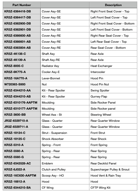

A list I have been working on;

Added them, can you confirm if any of the parts are specifically CFTP other than the rear wing?
The seat covers, axle shafts, heat exchanger, intercooler, hood pins, hood pin nuts, side rocker panels, steering wheel, quarter windows, rear deckled panel, supercharger pulley & snout, hood vent/rain tray, and hood are the same for base & CFTP. Only thing to note is the seat covers are for Recaro seats.
The swing spoiler & gurney flap, and front & rear springs are base GT500 specific.
As far as the front struts & rear shocks go, I am not sure if they are the same part number for both base & CFTP, with the difference being the CFTP gets a different calibration, but I requested the part numbers for my car (base GT500).
As mentioned, the wing is CFTP specific.
