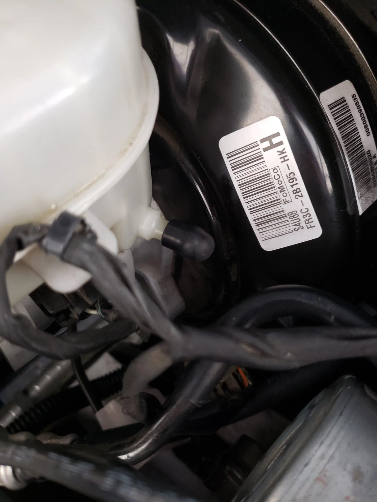

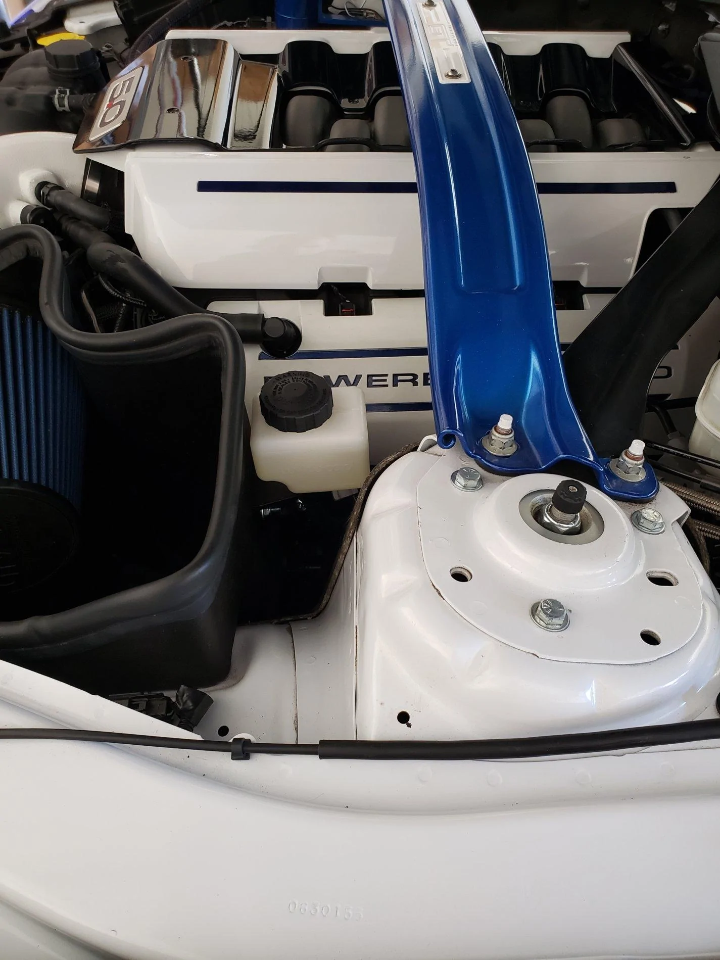

I'll be doing that tomorrow, I ordered the wilwood 7oz reservoir, I'm gonna be mounting it on the back side of my air intake box, I'll take some pics and post them up when I'm done.

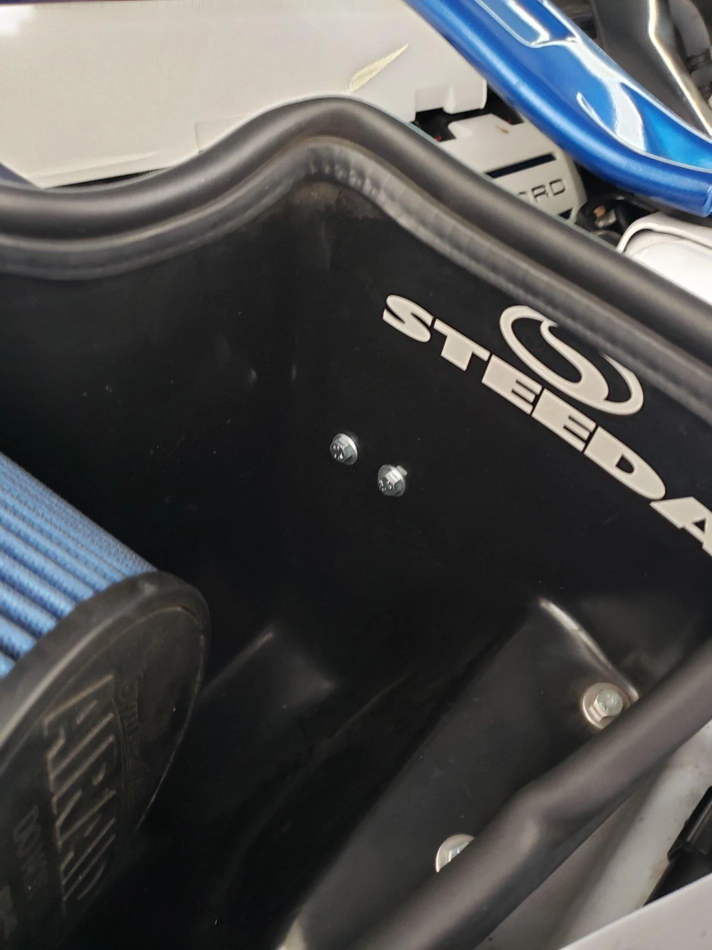

Here is what I came up with, just mounted the resivoir to the back side of the air box, attached it with some 1/4 bolts with nylock nuts on the back, ran the hose that the wilwood kit came with the the factory location, and put a vacuum cap on the nipple coming off the brake resivoir

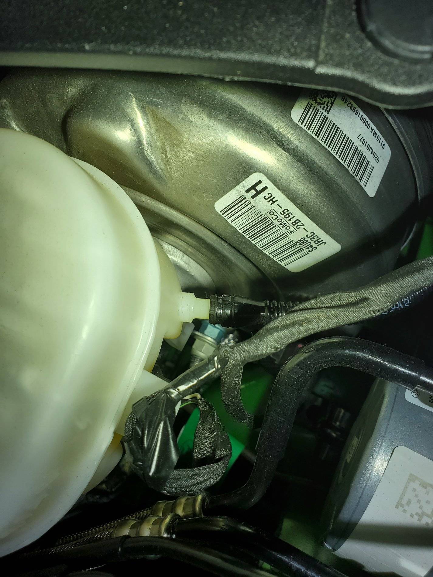

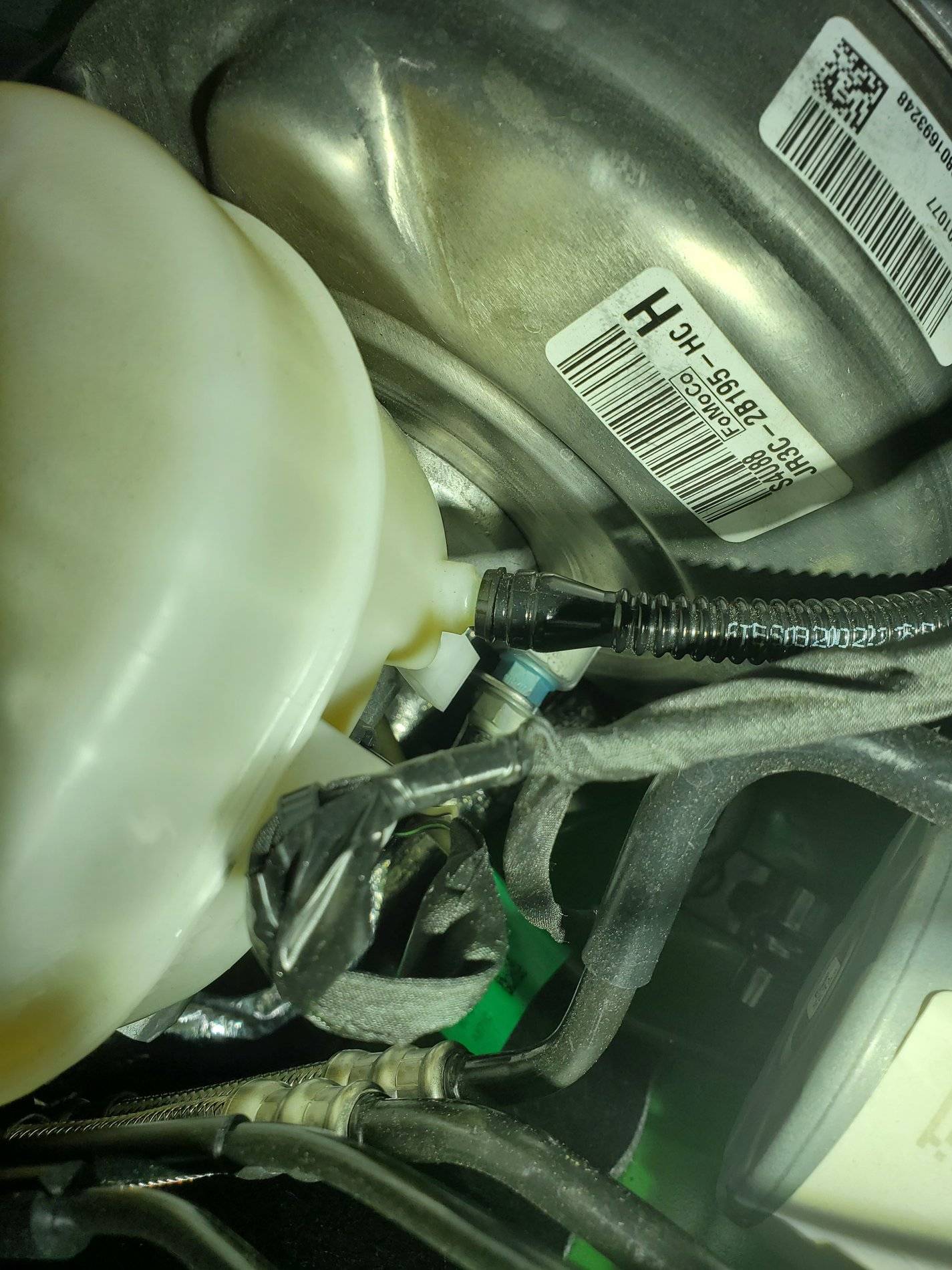

Before:
Mine was like this pic. I pushed it in all the way.
The question is -- do I need to install a hose clamp over it? I will inspect it regularly and put a hose clamp on if necessary.
A small zip tie is definitely the way to go for this.

I checked mine when this thread first appeared and it looked too much like the original pictures posted here. I pushed the hose up closer to the fluid reservoir and so far, it's stayed there without any other additional help.
