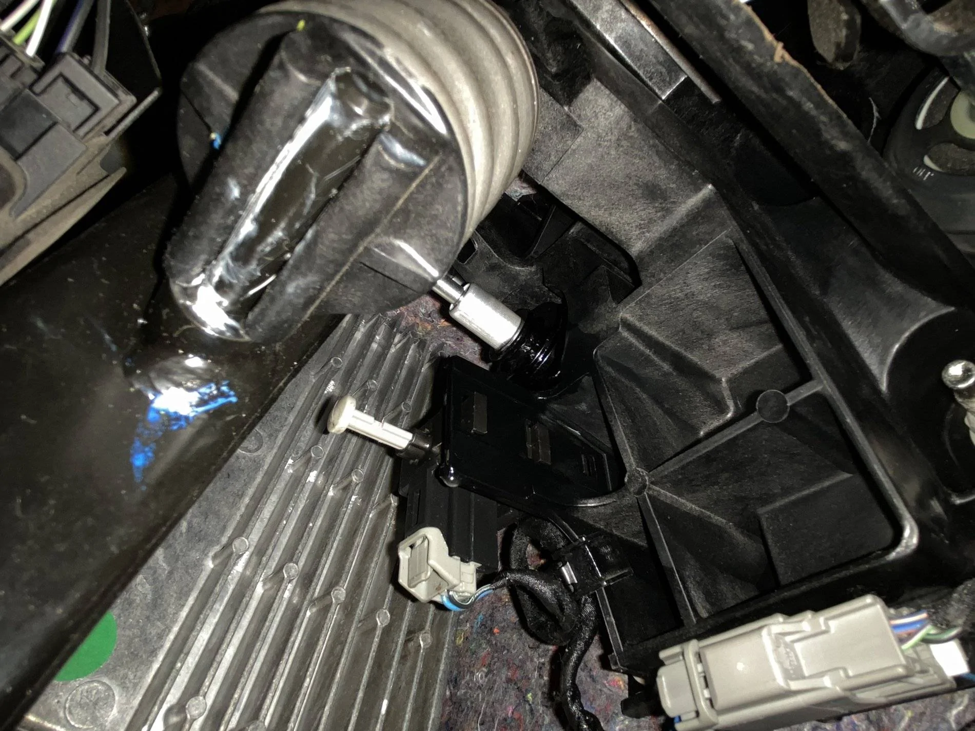

Right behind clutch"Leaking Inside" what do you mean exactly?
Are you talking about the white gunk on the spring perch? That's just grease (lithium grease?) because that whole assembly moves on that rod.Right behind clutch
Mind taking a pic? Would like to see the placement of the zip tie.I put a zip tie on mine around 2 ish years ago after pushing it all the way on. It hasnt budged since, and no brake fluid has seeped out at all, completely dry.
Yes right above that electrical connector it’s dripping out of that push rod, and a couple days Of pushing the clutch and it will be back. Fill up my reservoir and a week or two it’s getting low again.Are you talking about the white gunk on the spring perch? That's just grease (lithium grease?) because that whole assembly moves on that rod.
Just looked again, I see what looks like a small drop of lubricant just above that electrical connector. That what you're talking about? The whole piston assembly almost looks moist too. If you wipe it off thoroughly how quickly does it come back?

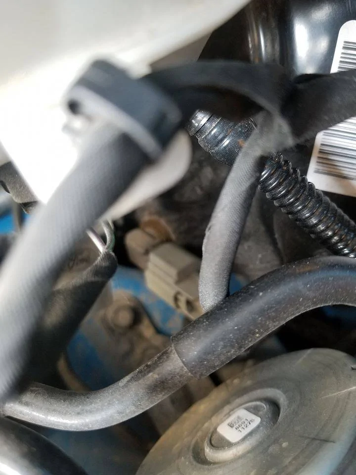

here you go...Mind taking a pic? Would like to see the placement of the zip tie.

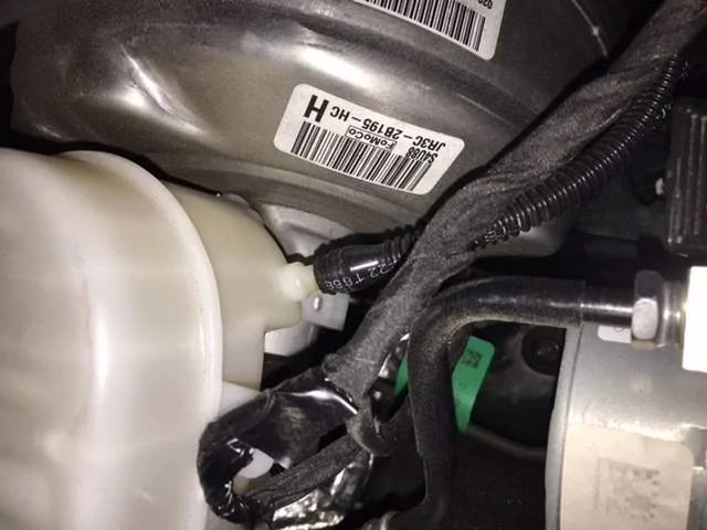

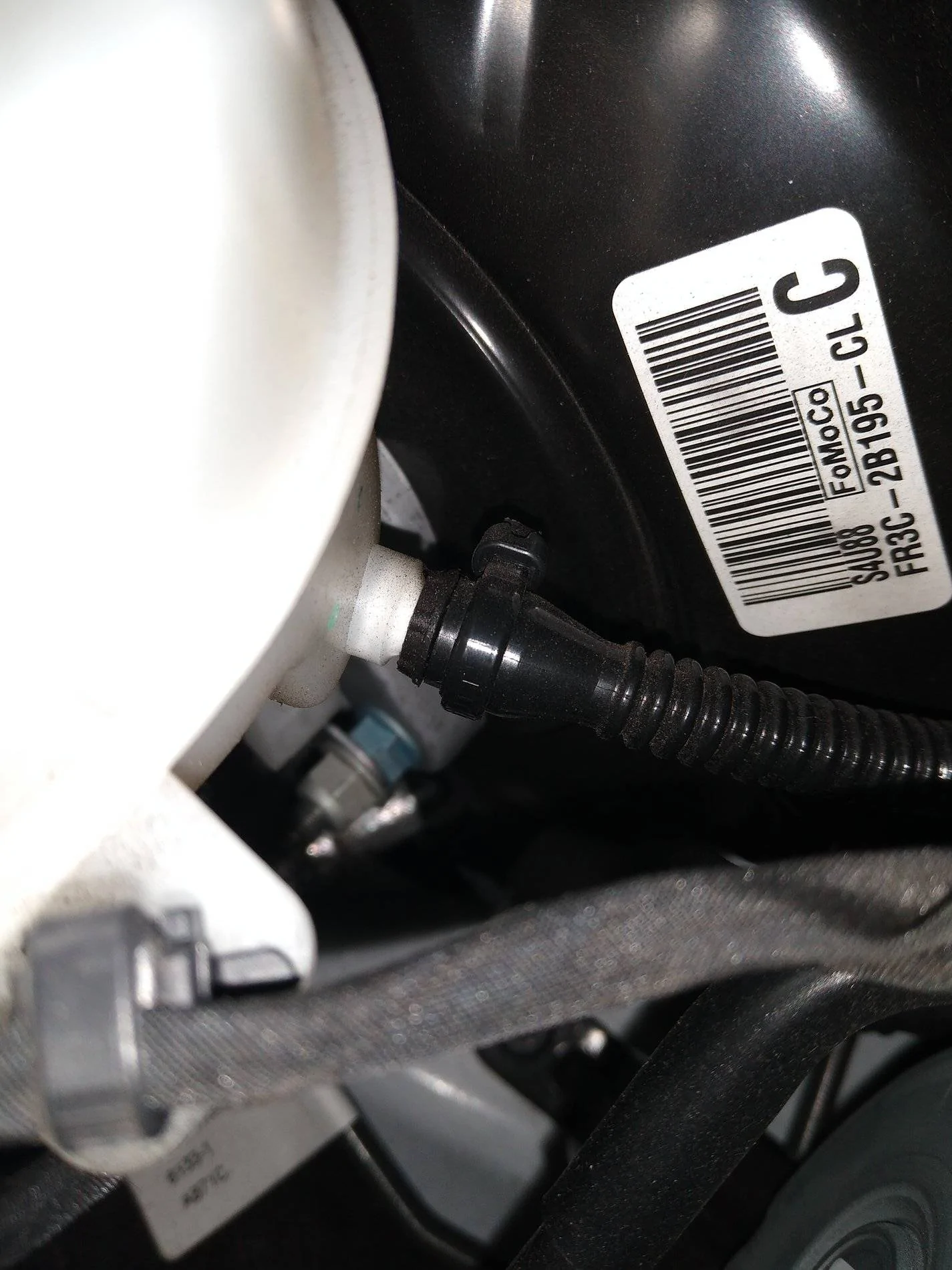

Looks like it's not all the way on the nipple if you look at the gap between the end of the hose and the reservoir. I had to push pretty hard to get the hose to seat all the way.Took a pic tonite...March 7th.. would not move at all !! Did not use excessive force!!
K after putting a few hundred miles on it, hasn't move one bit (no zip ties or anything)Yes! I just checked mine as well. It was about halfway off the connection and had slight seepage! Fluid level was good. I pushed it all the way on with a little extra umph, then tried pulling it off with decent force. Didn't budge! Good catch on this! Guess we have a lot of built on Monday, built on Friday cars lol.
Mine looks like that as well. I’ve had the car for almost 2 years and it hasn’t moved more or leaked at all. Tried pushing it on further but as you stated, didn’t use a lot of force but it didn’t moveTook a pic tonite...March 7th.. would not move at all !! Did not use excessive force!!
