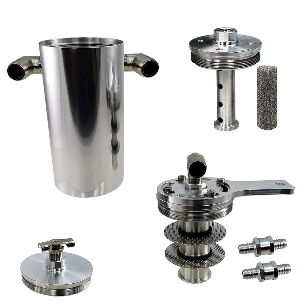

You have to squeeze the quick fittings white tabs simultaneously. You can't just push on one of the two tabs. Following UPRjoe's instructions: for the dirty connection, reach down and push 'in' on one of the tabs while pushing 'in' with the long flat screwdriver with your other hand on the other. For the easy-to-access ports, just squeeze both tabs at the same time and gently pull off. I liked the fact that UPR provided swivel connections mid-way on two of the hoses. Just a simple rotation of the hose to orient the quick connection to the port. The hoses were premium quality, not just stiff rubber ones.

Those aren't swivels, they are the check valves necessary to make the system work correctly. Make sure you check that both arrows on those fittings are facing away from the catch can. The fact that they let you easily orient the connectors on the end of the hoses is just a bonus.
