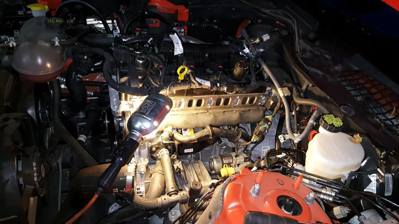

This is MY engine at 40K.
93 Octane "Tier One" [branded] fuel, regular maintenance on an accelerated schedule by the dealer and myself, 5K max on full synthetic oil, top end synthetic oil filters or Motorcraft only, regular air filter cleaning, 80/20 highway to in-town mix.
This is probably what most systems look like at 20K or less.
This is the forward most intake valve taken with an Android phone and CameraFi (<$20 online) with the intake manifold off.
I am NOT cleaning my valves as I'm going to add a CC system (one-way dual-valve system, with clean side protection) AND Methanol injection. I know which limits build up and which removes build up.
I'm waiting on YOUR evidence and not your "thoughts" - still waiting on QTip pix from the Inlet (follow the Valve Cover connection to the turbo inlet - swab there) and the dirty side (intake connection is easiest to reach).
When they BOTH come back dirty (assuming 20K+), I'll explain why.

I don't need to swab the inside of my engine, and I won't make you wait to explain why. Your photo, like the contents of your catch can, is further evidence of what we know--the inside of an internal combustion engine is dirty. You didn't mention you were experiencing any driveability issues, so I'm going to assume your engine is running fine.
There is a lot more disgusting and dirty stuff sitting in your engine after operating it for 40K miles than what we see in this photo, and like what we see in this photo, if it doesn't interfere with engine operation it is of no concern.
You have made a claim that a catch can is all but required for continued operation of the 2.3L EB engines installed in 2015- Mustangs. I and others have expressed doubt about that claim. It's not up to me to provide "evidence" of my doubt--that's just a silly misdirection. I have asked for evidence that carbon deposits are a problem with these engines. A problem, BTW, means something that interferes with engine operation, not something that's expected--like getting dirty--during normal operation. YOU have made this claim; YOU must explain and provide data to prove it.
Here's a fun thought experiment. What "evidence" would it take for you change your mind on this issue? Here's what it would take for me: There are literally MILLIONS of these engines in operation around the world. If carbon deposits were an issue with even a small percentage of them--as early as 20K miles as you claim--then I would expect to be reading TENS OF THOUSANDS of complaints online. As much money as people pay for their cars these days, they feel justified in complaining about the most inane things; I would expect to see complaints about a major engine repair (Ford's current guidance for dealing with this issue on the 3.5 EB is head replacement) at 20K miles.
What would it take for you to change your mind? If you can't answer that question--if nothing anyone can say will change your mind--then what's the point of discussing it in an online forum like this? We're all here because we want to learn something. If nothing anyone can say to you on this issue can teach you anything then why even read the forum? I have looked far and wide online and I've found exactly ZERO claims of carbon deposits interfering with engine operation on the 2.3L EB motor. Does that count as "evidence" for you? If not, what does?
I still remain open minded, I'll admit that perhaps I simply haven't looked hard enough for the evidence of carbon deposits causing problems with 2.3L EB motors. If you have some please share it.

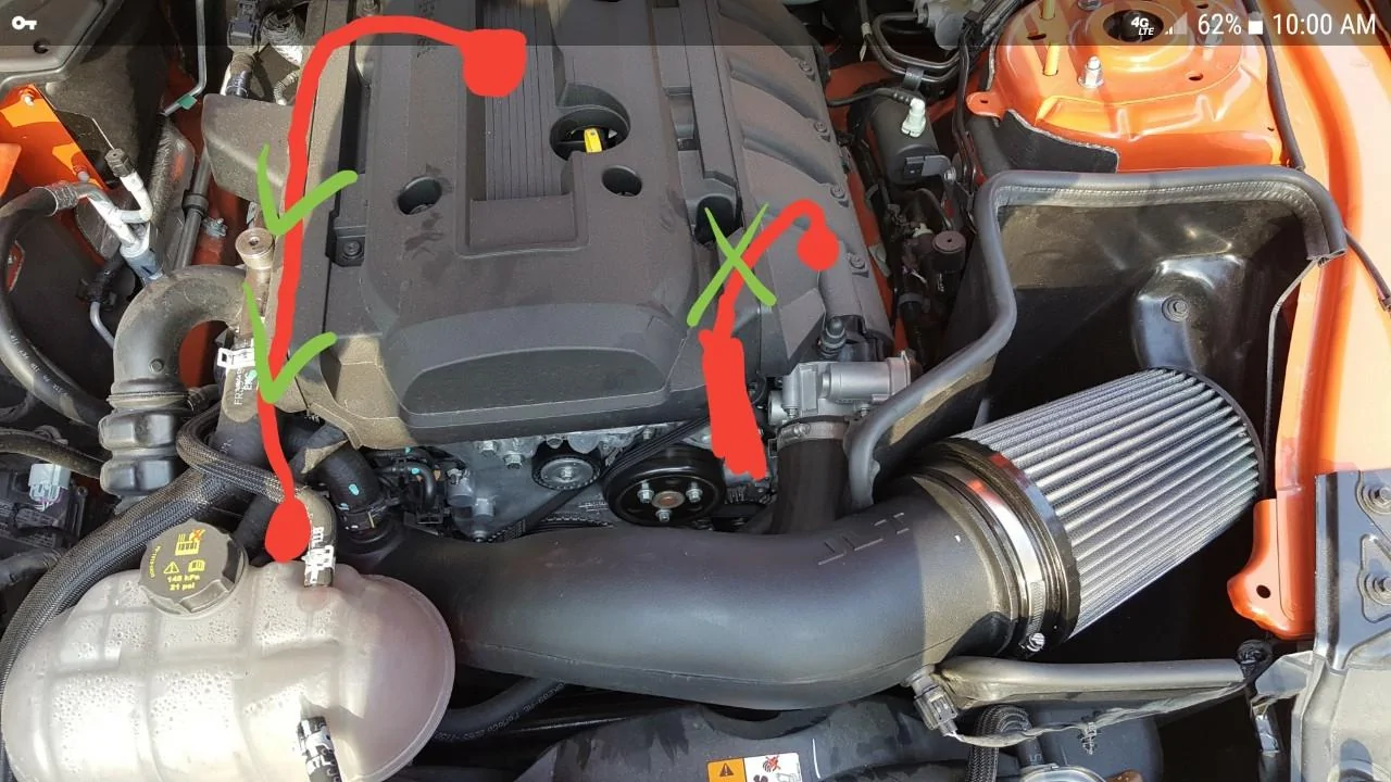

Wow. I'm having trouble visualizing this. It seems like you are saying PCV vapors go through the turbo instead of into the intake manifold when the engine is under boost. Is that correct? If you have the capability a diagram might help. Maybe you can draw one out and take a photo with your phone?
This seems like it would be a far larger problem than carbon deposits on the valves...

This is what's going on under boost. The breather box on the block is supposed to be blocked, but no PCV valve on earth makes a 100% seal from any OEM. So you have a little bit of boost pressure leaking back into the crankcase. Turbo inlet is the only source of a vacuum supply under boost conditions. So that pulls from the valve cover to evacuate the crankcase pressure.
