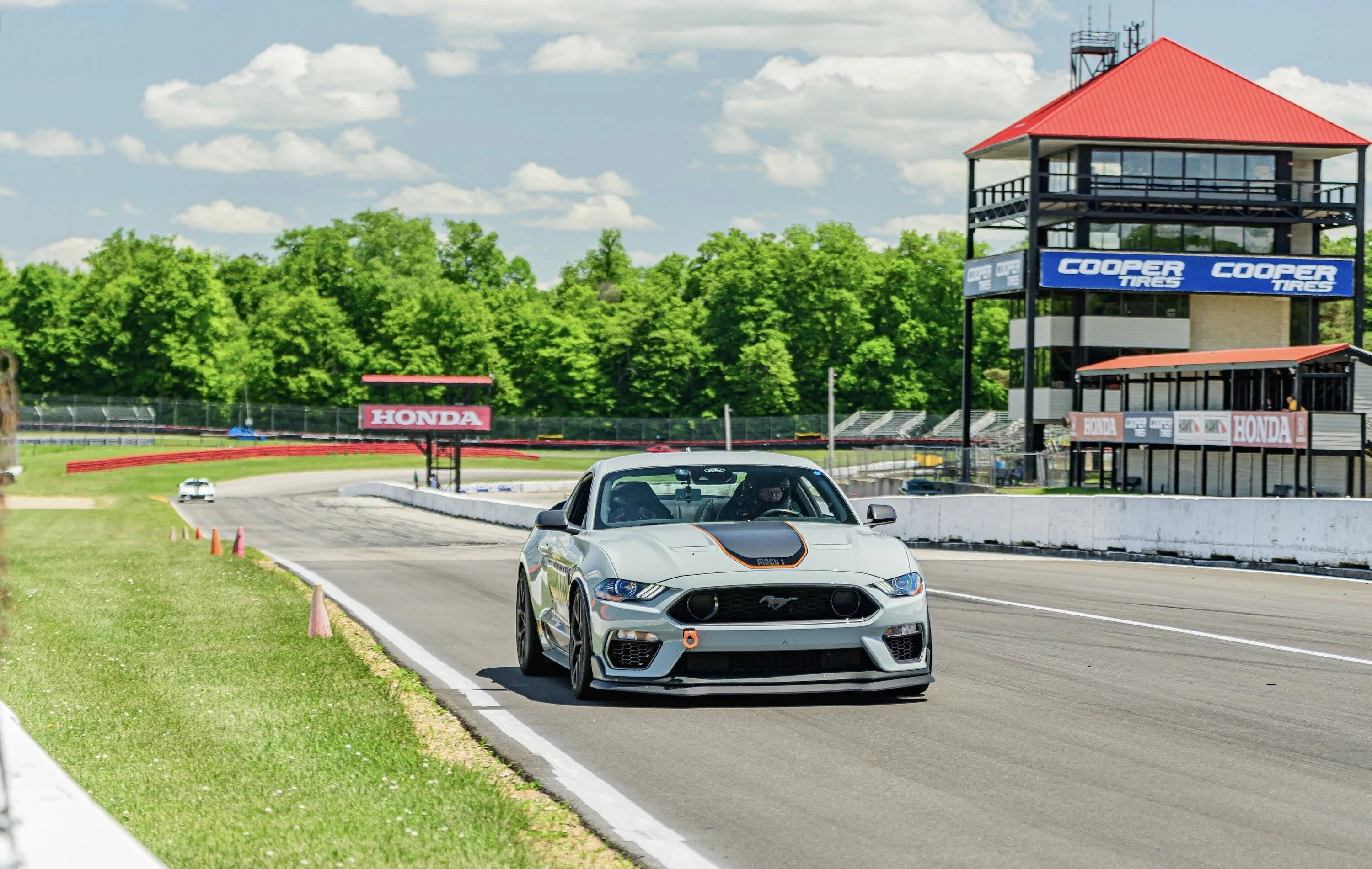

Yes, definitely do not take it to a track because you’ll get hooked. Do not take it to a track. My suspension is Steeda everything:
Gorgeous car!!!!!
My first track day is Sep 16th. All I am missing is sway bars and I will be full Steeda.
Are you using the stock seats? I'm debating putting a race seat in.

Recaro / 4 point Schroth
