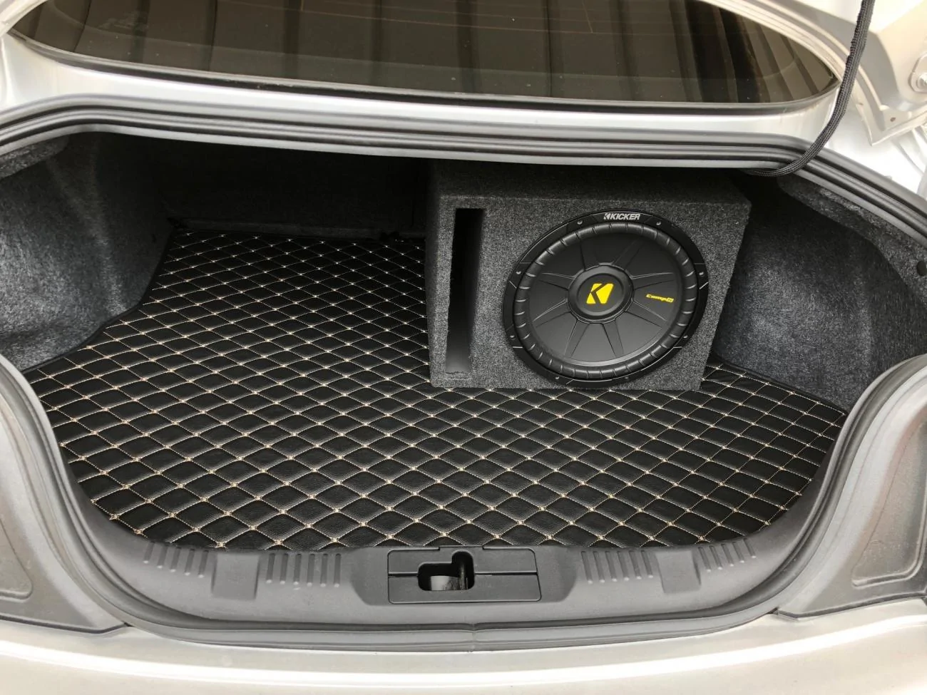

12" Kicker Comp S sub w/generic ported box
300w Kicker Amp under the carpet
Have a bass knob under the steering wheel
Less than $300 and it hits hard
that looks good! How’d You mount it so it doesn’t move if you don’t mind my asking? Also, sorry for reviving an old thread, just looking to add some bass as well.
