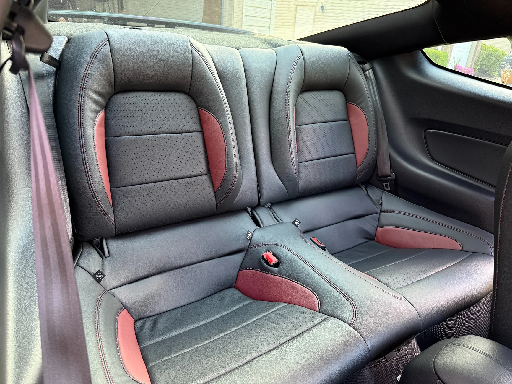

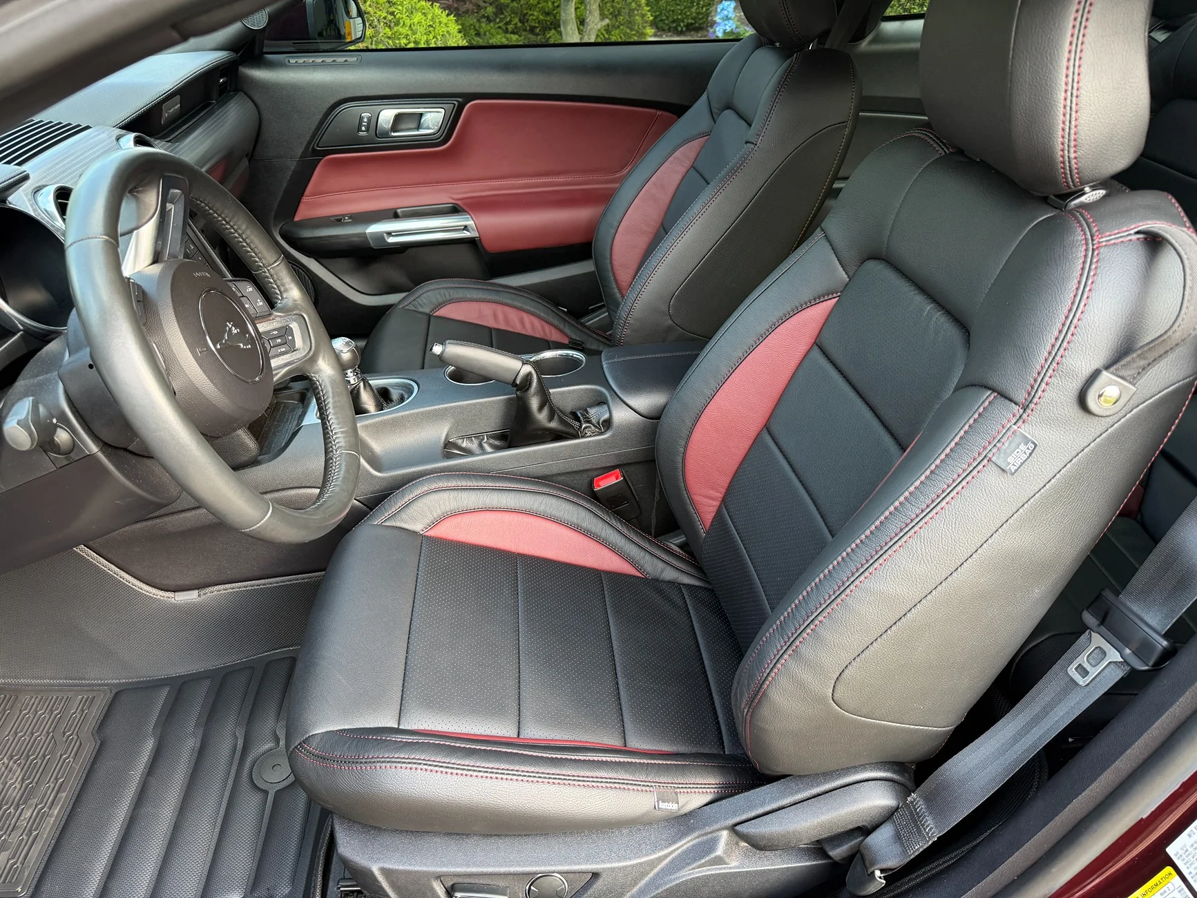

Just got car back from upholstery shop and I LOVE IT! It's crazy how big a difference this made. Like a totally different car. So happy ...
Looks nice.

And congrats on the interior. Is it a Katzkin set?

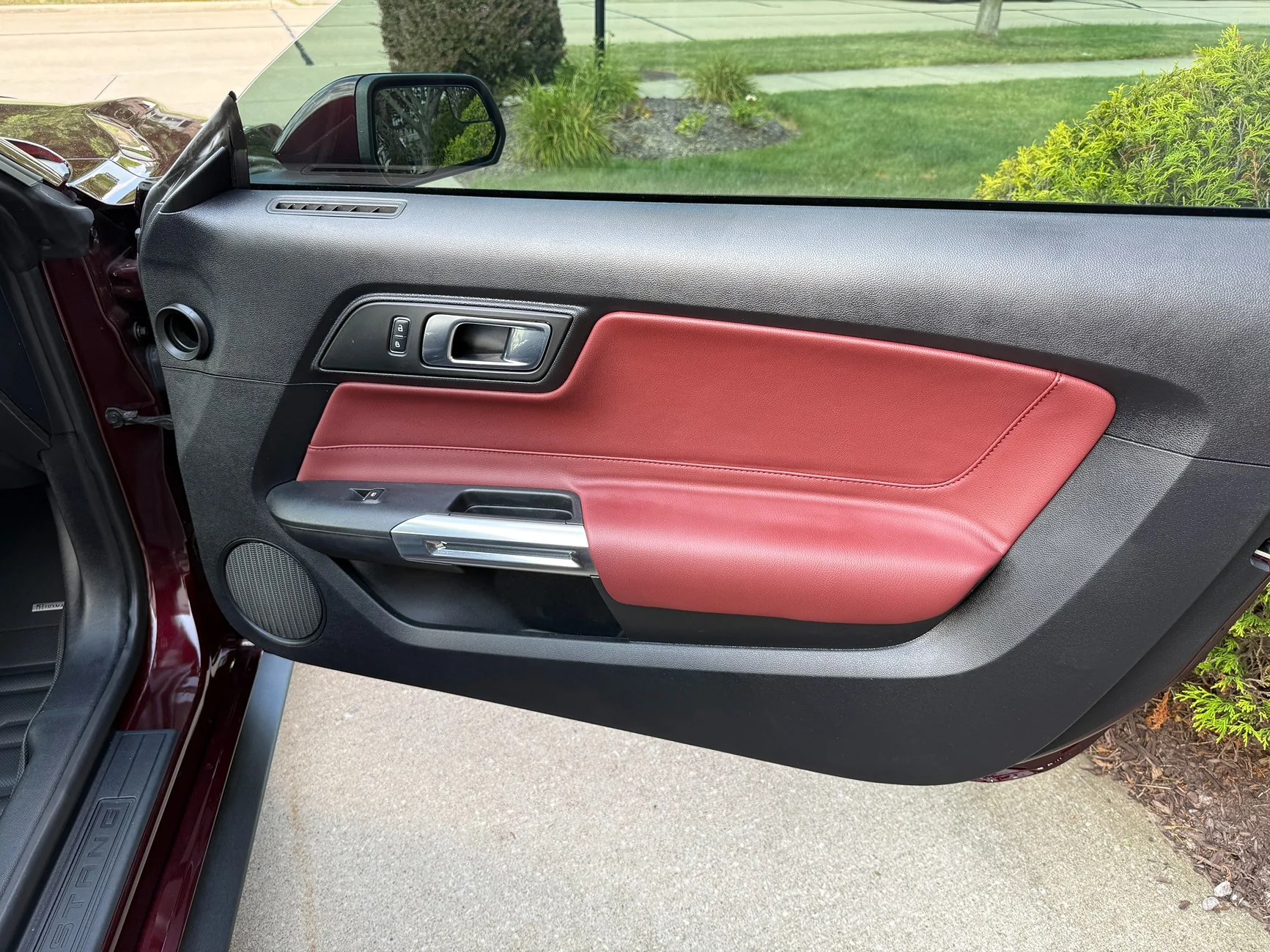

Yes, it's from Katzkin. It came out better than I'd hoped. Only problem is that I don't think upholsterer put the door panels back correctly. The handle flexes away from both doors now. I don't remember them doing that before. I'm going to take one apart this weekend and have a look to see if its something simple.
