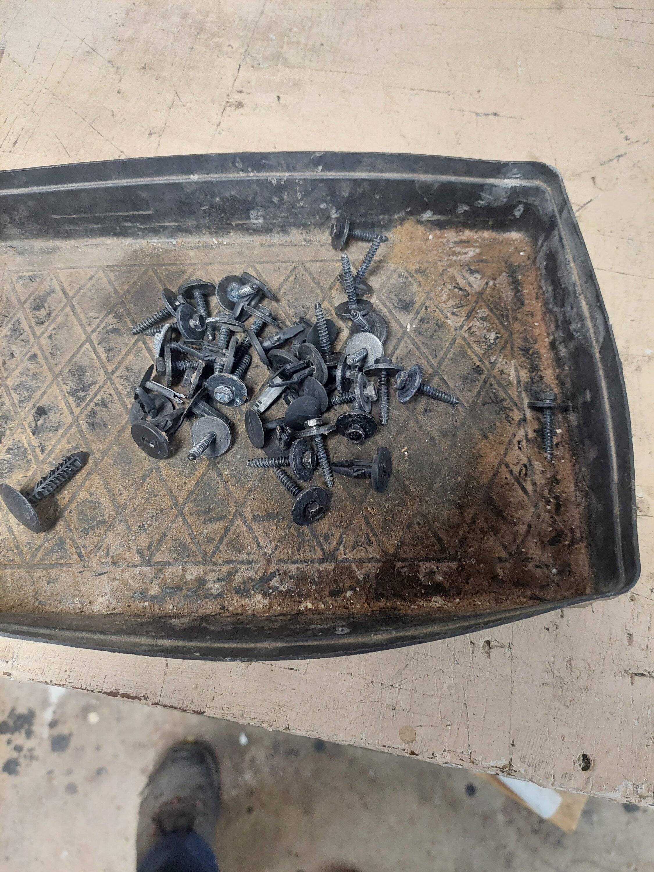

So I got meatballed this past Monday for my belly pan coming loose.
Front was still attached, but back side was flapping like crazy.
I was able to zip tie the back to the frame to get back on track, but wondering if there is a better solution?
If I go to the dealer to reinstall, I’m think it will just happen again.
Looking for better attachments.
thanks.

Its mainly fine thread screws into plastic nut inserts. Alot of them. A nuckle head could strip them out very easily.
