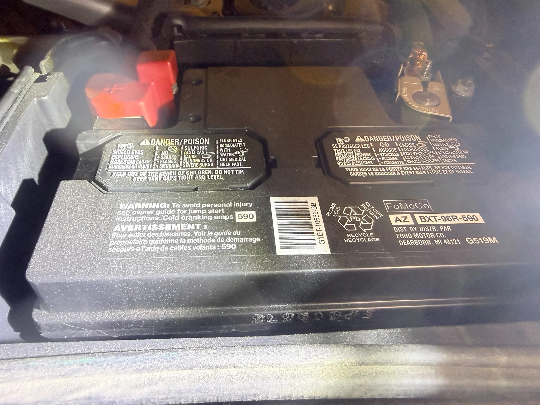

I bought my 2023 Mach 1 new and within a few months my battery was already having issues with charging and holding a charge. I went to ford and they analyzed it and said they charged it but they did not find anything else. I have had now the same issue about 4 or 5 times and have told ford everytime, they always check it and say nothing is wrong. My car off is at 11.5 - 12.0. When it is running it goes to 14.5. Ford has said they will not do a warranty battery change even with all these complaints unless the battery is dead. What battery if they were changed are owners of 21-23 Mach 1's using? My oem battery pictured below has a date of November 2022.

if you unhook it I think it s supposed to be 12.4 sitting at least. If it s lower, it s no good. seems guy s either have battery issues or they get years on one. I just replaced by OEM 2020 battery. It was still good but 5 years is enough for me. Bought a NAPA (inexpensive). I always change batteries BEFORE they die anyway. I seems to get 4 plus years on them all.

Yea, I did not expect issues from a brand new car and batery only a few months after I bought it. At least you got 5 years out of it. I will look at NAPA.
