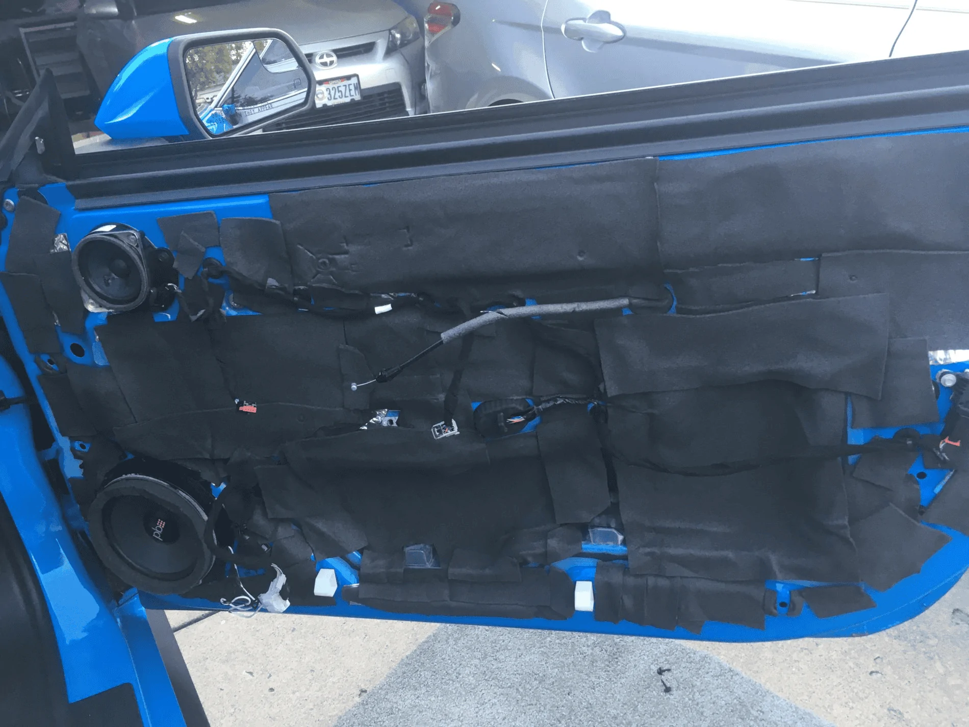

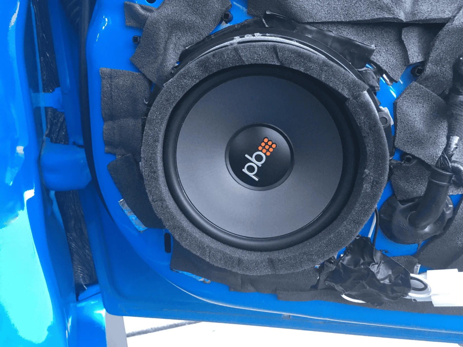

my car I had everything to set to 0. with centered in sound stage, I added gain with my subwoofer bass with these settings. with EQ off- everything was clear and beautiful as was, and the subwoofer added all the kick.
but I will say I added speakers to my car, 2 ohm factory replacements from powerbass, man they sounded great.
I have dynomat extreme + ensolite, I did this stuff to reduce rattles, it worked like a charm. just aint pretty.--- I do not know if these speakers are still made, but they was really solid for the lower speaker of our cars. I was very happy with them
I sold car btw. so everything I am posting was already done/over with.--- stinger foam rings for the speakers are worth it btw. like 10 bucks or something like that, it keeps the noise coming into cabin and helps keep panels from rattling too. I didnt have any rattles anywhere.
I put GTO629's in the rear shelf with dynomatt under the carpeting on the shelf as well.

How did you like the PBs? I am considering them for my puny 6spkr system.
I was pleasantly surprised by them, had a lot of bass and sounded good. was very happy with them.
buy from crcuthfield, you can return if unhappy.
but make sure you get 2ohm. if you get 4ohm you will halve your sound.- I actually thought they discontinued selling them after I bought them. I mentioned I bought them and other members mentioning they couldn't get them anymore. I will go look through my history
https://www.crutchfield.com/p_151L26C/PowerBass-L2-6C.html
They are gone. I got mine on sale for like 60 bucks, I didnt use the crossover or tweeters. only wanted the 2 speakers.--- but if you can find a set, I like them., look at the reviews, the other reviewers seem to express same opinion as me. I was very happy
