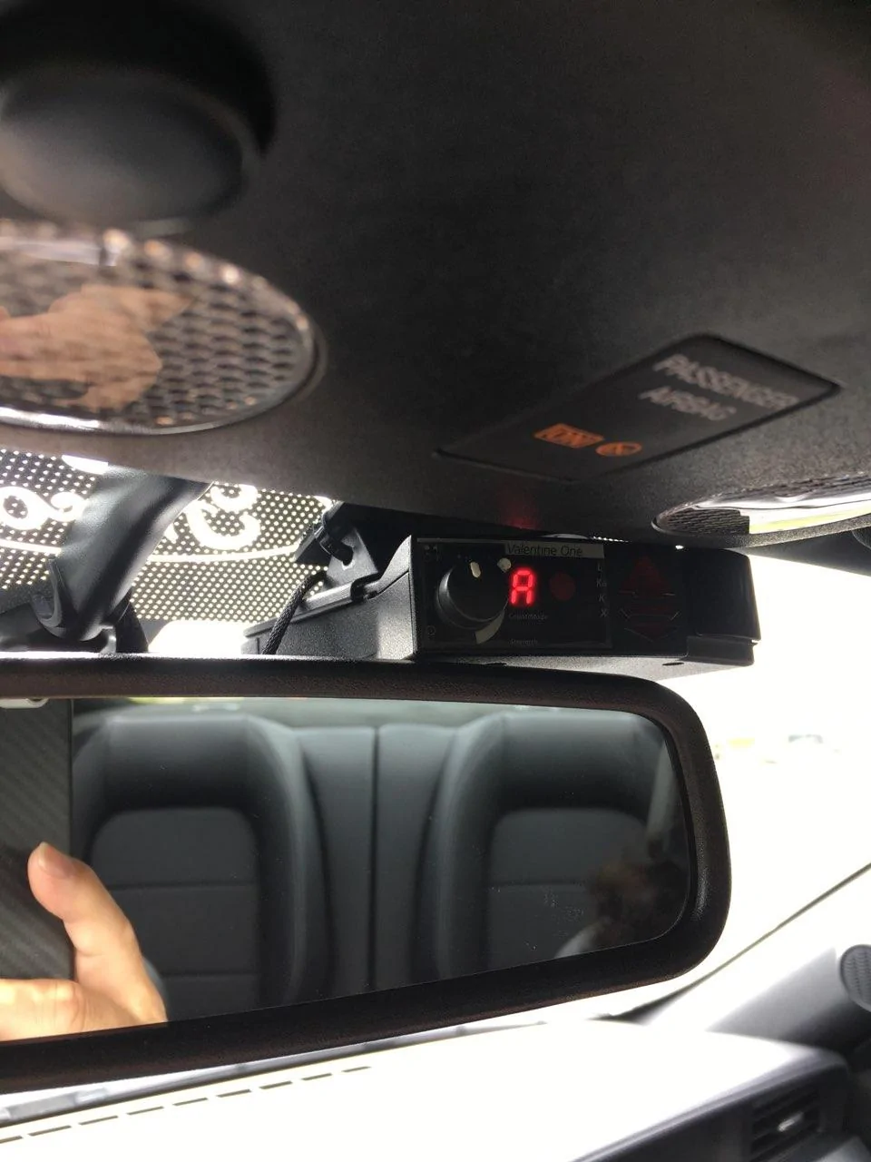

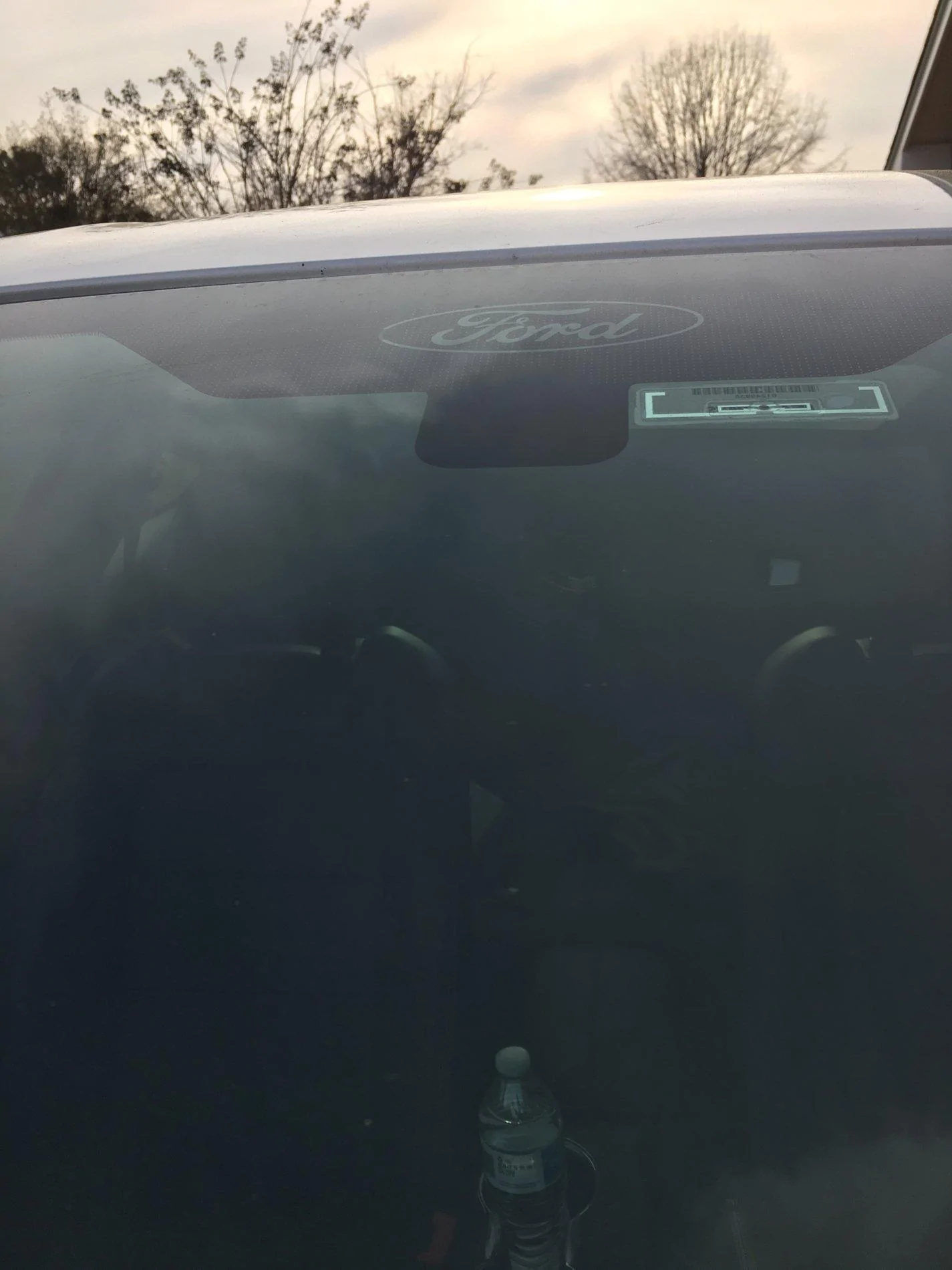

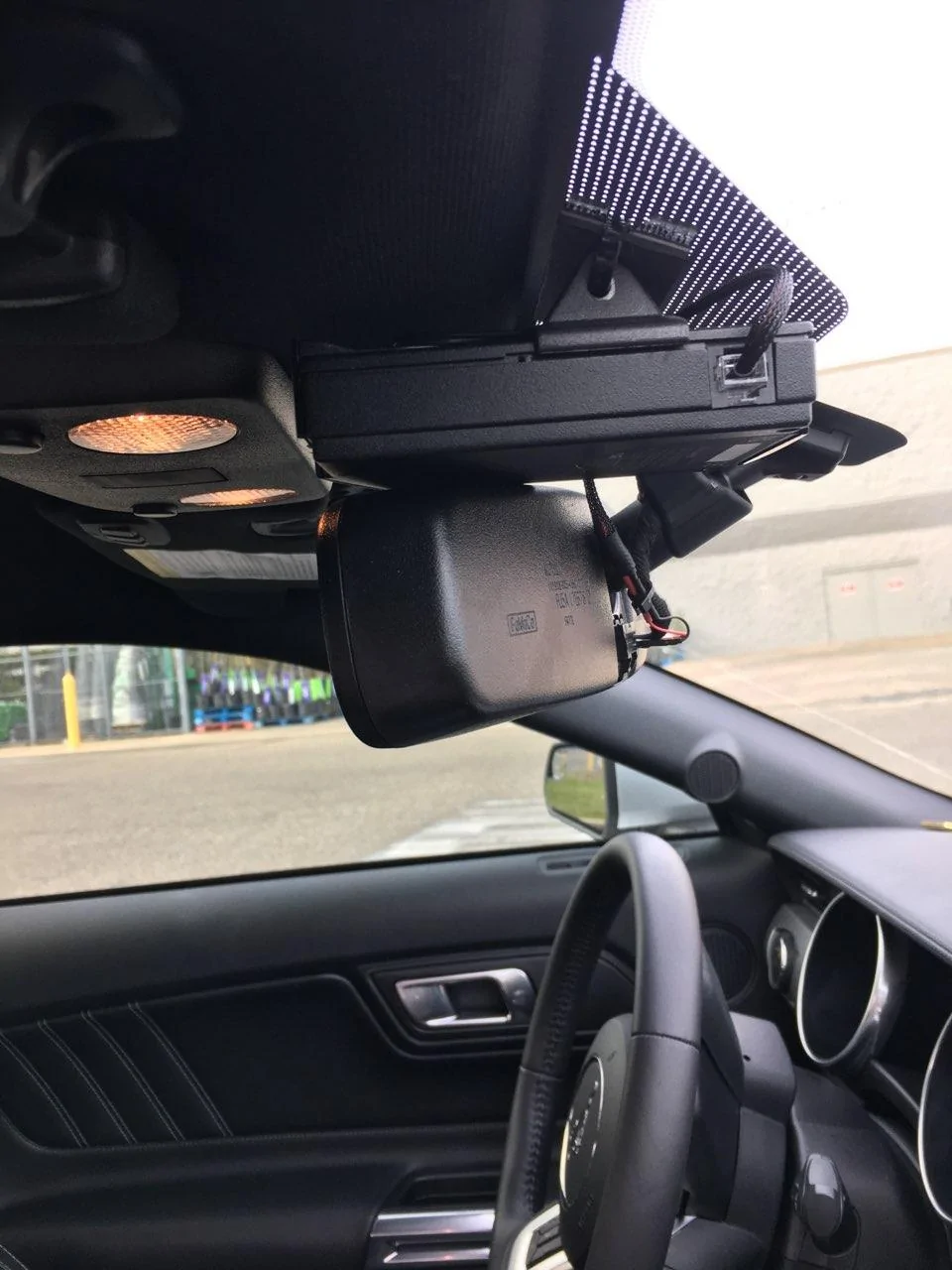

You can make your own. I saw this design at an Audi forum, the poster who is a police officer made it for me. Shipped to me free of charge. I borrowed the design and made another one for my Mustang.
Buy a strip of 3M Dual Lock Velcro tape from eBay. Use the radar detector mount, take off suction cups and use tie wrap (thru a pair holes you drill) to a piece of thin mounting plate (something thin, durable) and put 3M Dual lock. Mount a mating 3M Dual Lock to windshield, then Velcro mate the radar detector mount with 3M dual lock mated to the windshield. Well hidden, can't be seen easily outside which deters thief. I used the Mirror Tap to power Valentine 1.
