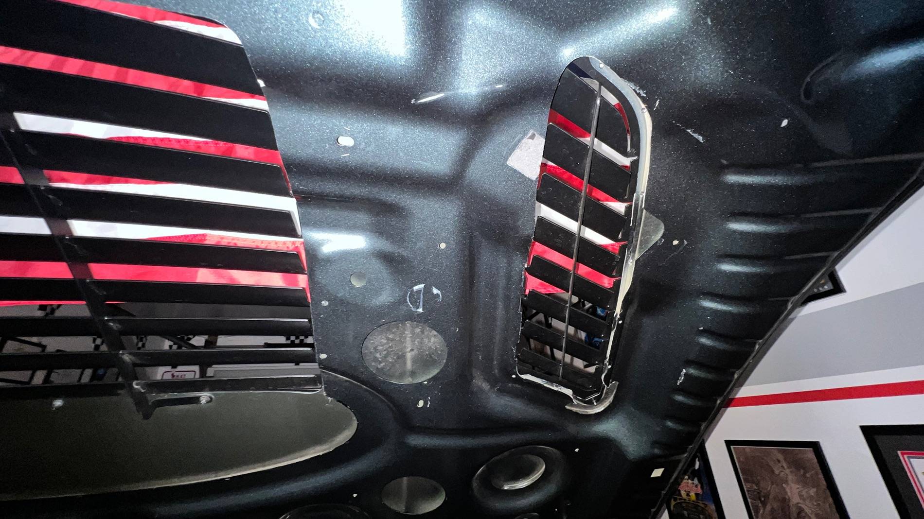

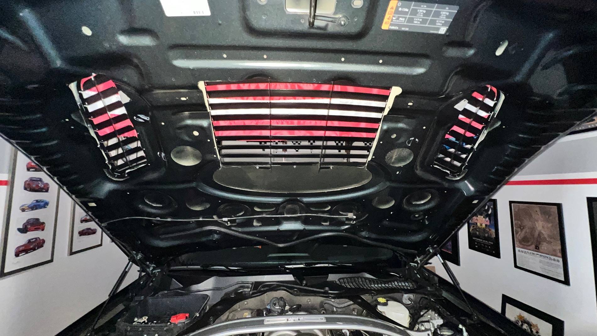

So, what are you all doing to protect the cut edge of the hood insulation after installing a shaker or Race Louvers?
On the side lovers you’ll want to cut out the bottom support (it won’t be used anymore.
The center is a non issue

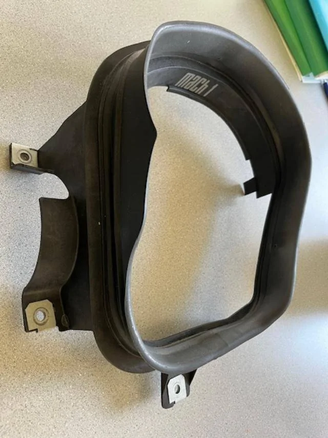

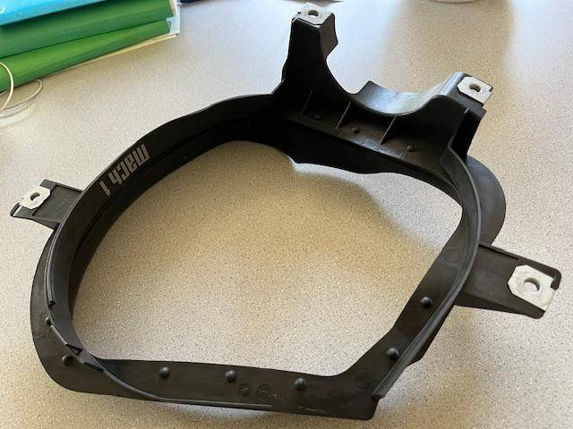

I'd like to see more information on how the fastened cover, shown above, is attached. The rubber seal and support ring are not flat surfaces so any additional details are appreciated.
It is riveted to the top of the airbox cover. Just unscrew the airbox top and remove to access the air filer element

....so, slice off the rubber and rivet the clear cover to the flange? The base diameter of the OEM filter diameter interferes at that flange height but the Blue AirRaid (Ford Performance) filter works? Thanks.
Yes, Yes and Yes! :like:

1) It would be pretty trivial to keep as much insulation as you want to keep (while removing the necessary area where the actual shaker goes.
2) Levittown sells a kit to convert a GT350 airbox (which I think the Mach 1 shares?) to a closed airbox with the GT500 airbox lid, so that's a good option too.
Thanks Nightmare, I will also look into the GT500 assssembly. I was thinking about cutting the insulation towards back and only leaving the front half to protect the vents from rain and filter housing area. I did that for my 2021 ROUSH stage 3 car when i installed the german SHROPP strut tower brace that everyone stated couldnt be done via blower. It worked. I gotta find pics for you guys.
After cutting the hood insulation, i have utilized black spray paint on those open edges which hardens them and removes the sensitivuity to water. Gotta spray and paint by hand w a brush like 10X, I did same on my roush car w strut tower brace and it worked.
Thank you, that was what I was looking for. I tried black duct tape and it is slowly removing itself from the heat. I had considered paint or some form of undercoating to close up the fiber where exposed. So far, barring any other good ideas, I think that will be the direction that I take.

Where it has been cut there is a lot of material that is not crushed and sealed like the edges of the original piece. Water will be absorbed here and the edge will continue to deteriorate and consequently look worse over time. Just looks unfinished and like it was done by a hack. I believe that I have it figured out and will report on the success or failure.

This all appears fine. However, I cut the factory blanket and reinstalled it. It’s the edges around where it is cut out that I am asking what others are doing to improve the appearance and stop water intrusion into the blanket.
