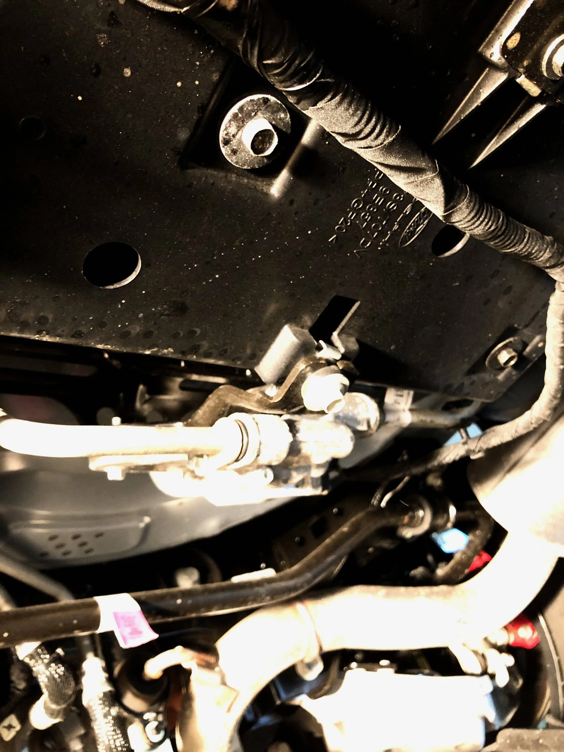

how easy was it to remove? Looks like dozens of screws?
I want to do an inspection under that area for leaks etc... thanks.

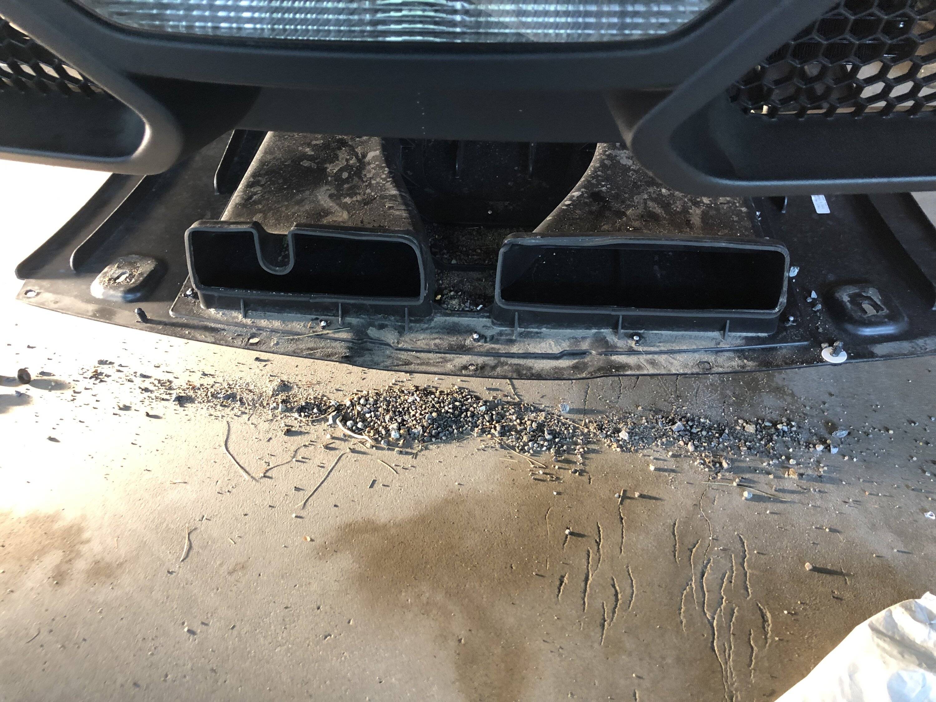

It's not terrible, really. I took it down to put LED reverse light in

I believe when I've dropped just the back half of mine down to get rid of pebbles and replace my reverse bulb with an LED it was 2 push pins, 2 larger bolts, and then I want to say it was somewhere between 4-6 smaller bolts. I just let the rear half hang down to do what I needed and put it back up afterwards. Very easy just 2 different sized sockets for the different bolts.

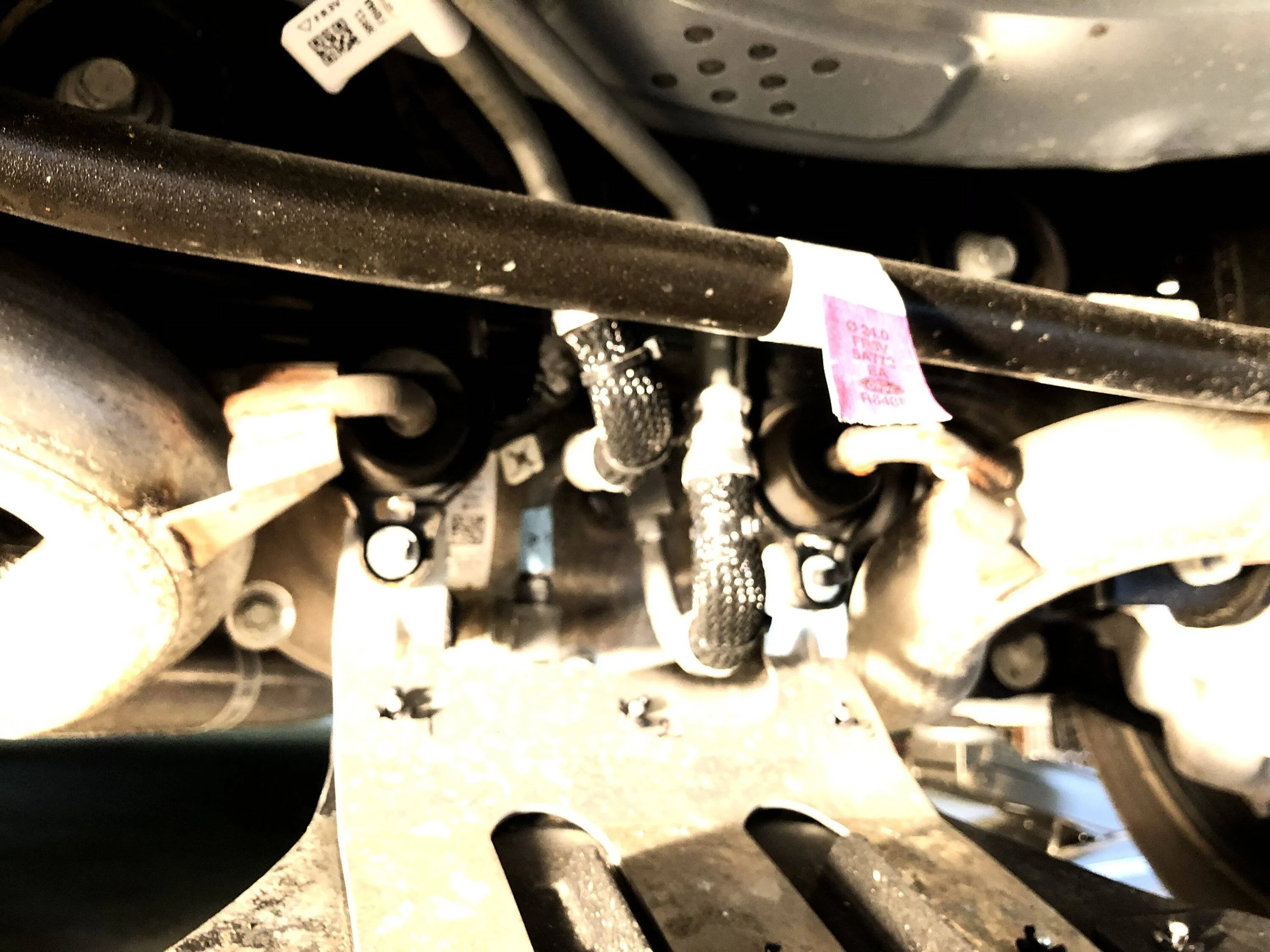

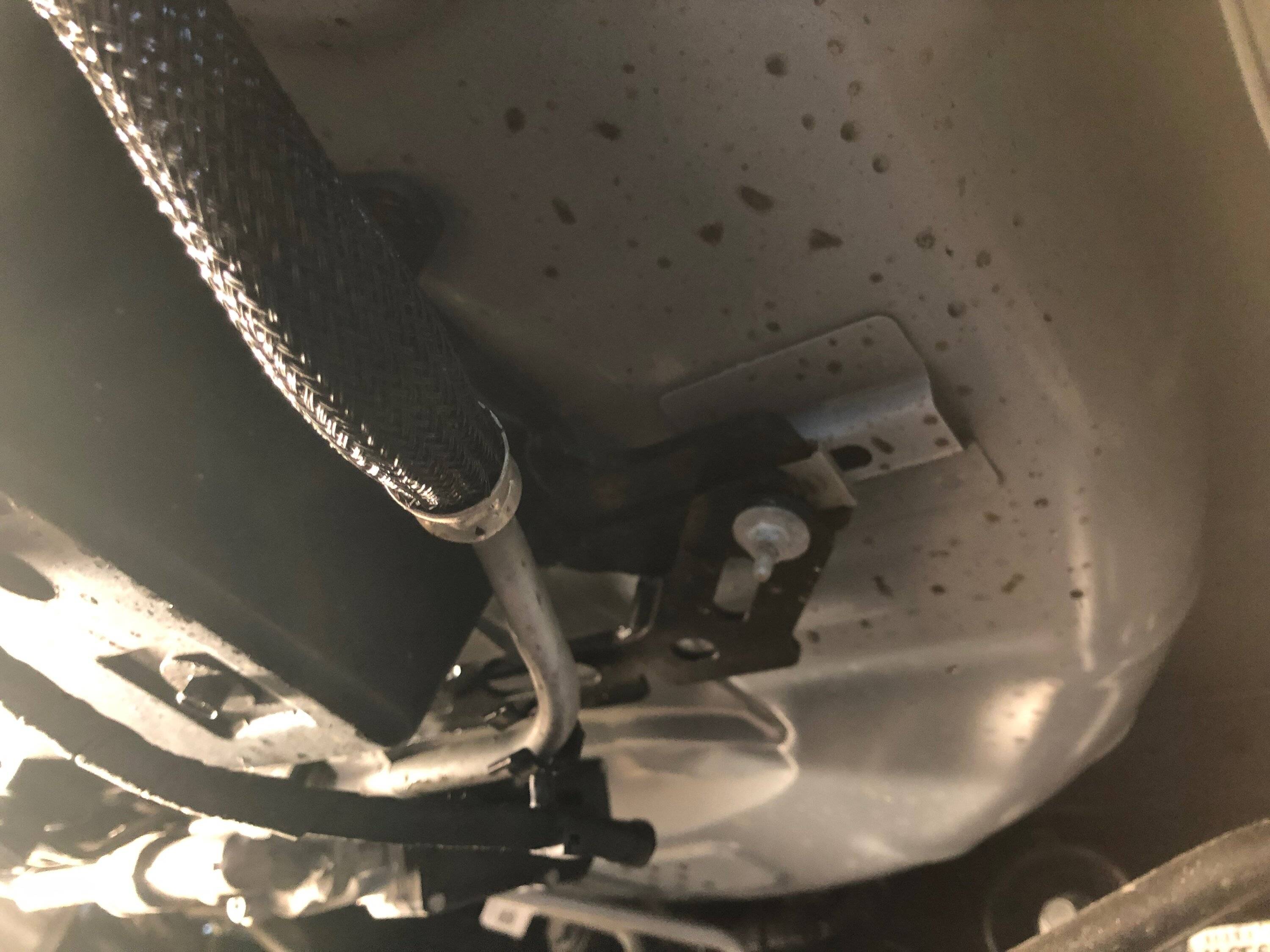

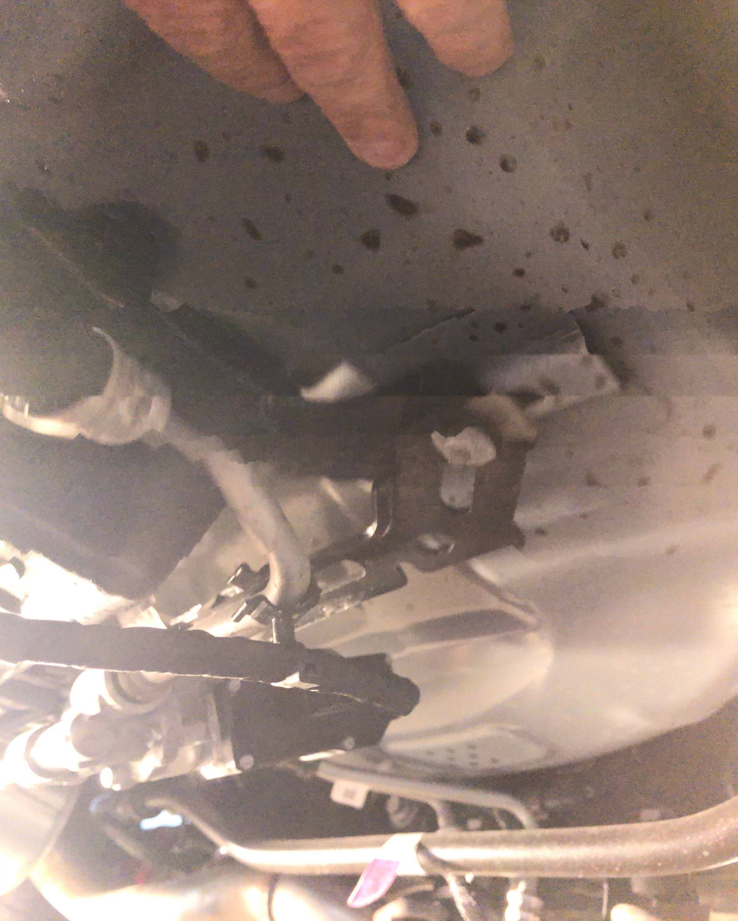

Thanks guys. So went under to do an inspection with 1500 miles. Got nervous cause I saw these little water looking droplets thinking maybe a rear diff or cooler leak. After checking it all out it looks like water maybe due to condensation mixed with road grim( exhaust runs right on both sides). No leaks detected. Hosed it all down and buttoned it up. Pics.
