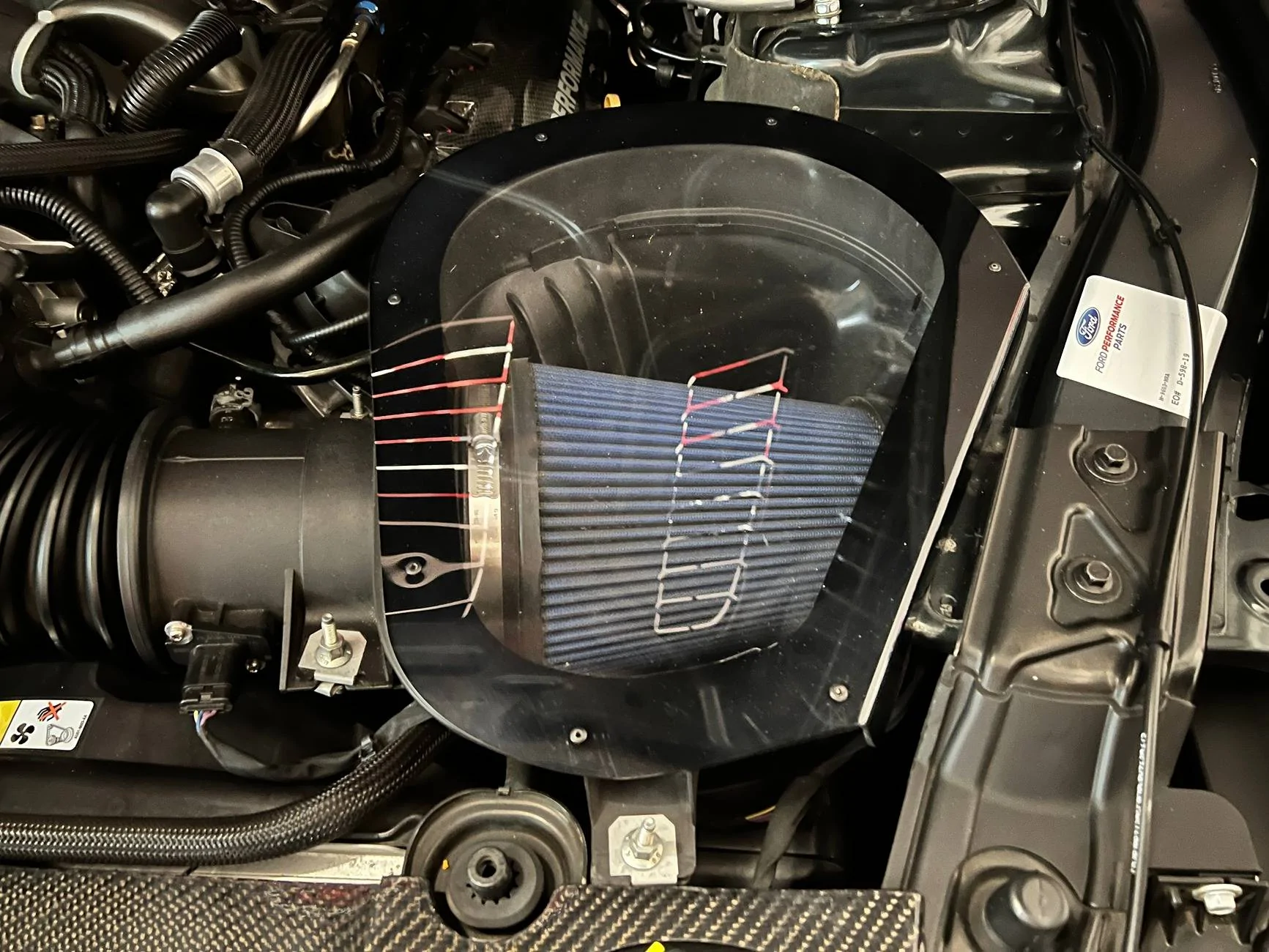

If your kit retains the current air box, then you are correct that it will no longer seal and will pull in hot underhood air increasing your IAT. Lots of people have cut a piece of plexiglass to seal the top of the box inside of the existing rubber ring and still retain the ability to look at the dirty air filter. Not hard at all and would solve your issue I think.

Who makes that lid?
My race mechanic Trent Musser made it. He’s workin a race at COTA this weekend bu I can reach out to see if he has more made. Just DM me your info

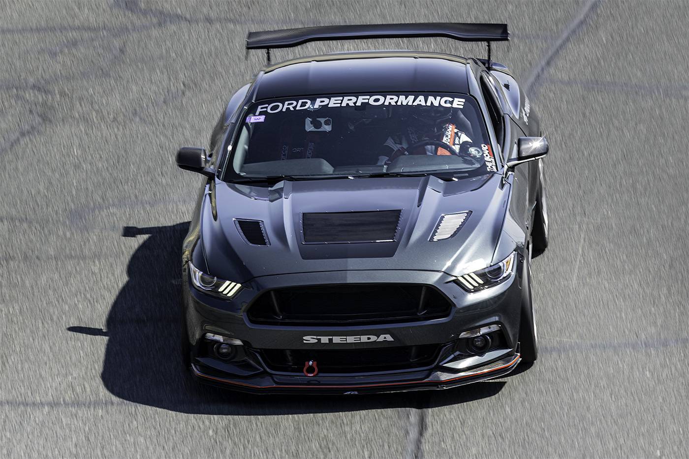

The cover solution was made because a lot of track guys have vents on their cars and blocking water, as mentioned above, and avoiding suffocating the filter was the prime objective

I'd like to see more information on how the fastened cover, shown above, is attached. The rubber seal and support ring are not flat surfaces so any additional details are appreciated.
