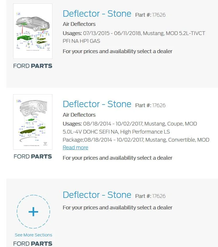

Me too, but mine is a '16 GT.
Just because I was curious, I looked at Ford parts website and only see one p/n 17626, it words it as for the GT, but also just says coupe? Anyway here's the link in case you want to dig deeper.
https://parts.ford.com/shop/en/us/body/other-body-related-parts-front/100/1#list
On Levitt I'm seeing different part numbers for both.
https://parts.levittownfordparts.co...0l-v8-gas-engine/body-cat/splash-shields-scat
Curious if there are any pictures to compare both.
