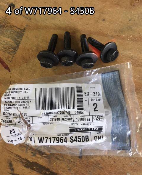

Cowl Panel Bolt M8x29MM
W717964-S450B​
To mount extension panel to firewall and tie cowl brace to extension panel

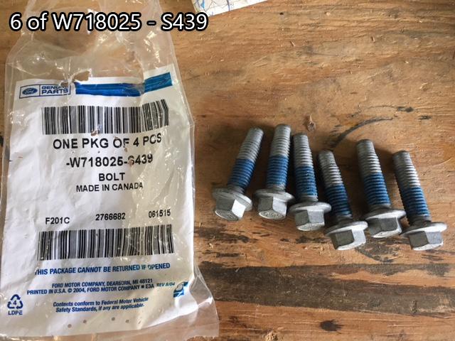

Lower Cross-Member Bolt
W718025-S439​
To install lower K Brace

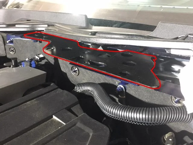

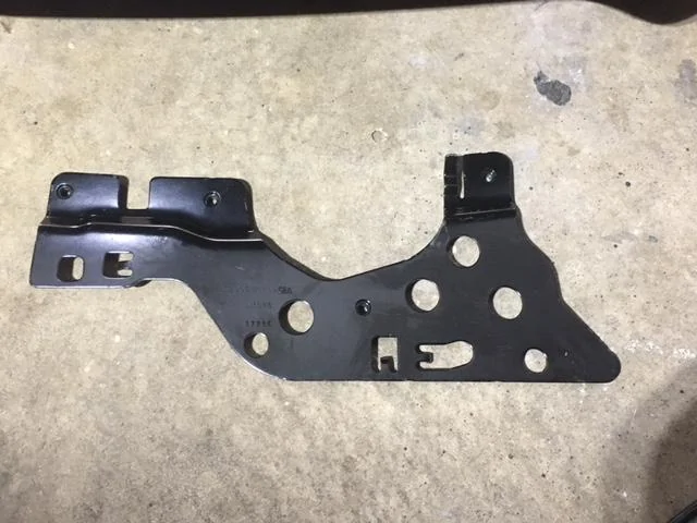

2. Look at your extension panel to see how it fits. This photo shows the orientation it will install at, with the bottom of the image facing towards the front of the car.

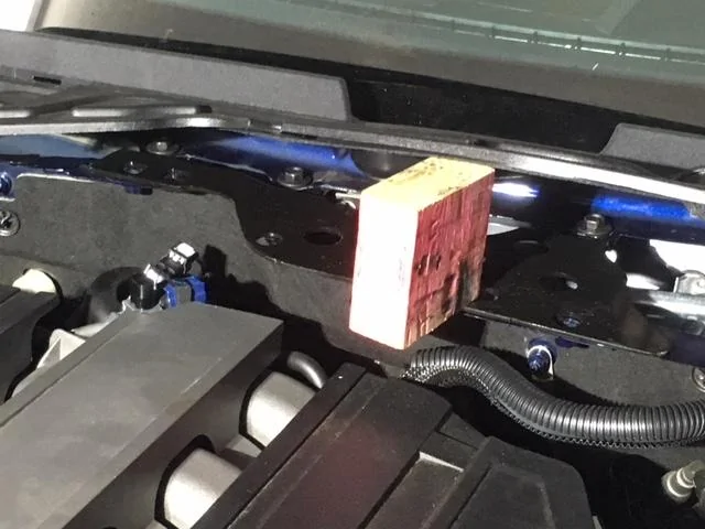

3. While holding the cowl up (they are sealed to the windshield so it won't come off completely) with a piece of something, angle the cowl extension piece into place and secure it. There are 3 holes in the firewall behind the wiper motor arms that indicate where the threaded holes of the cowl extension panel should align. They go underneath the lip of the firewall and there's a tab that holds it in place. It makes more sense when you are actually doing it, trust me.
This shows how it should fit:

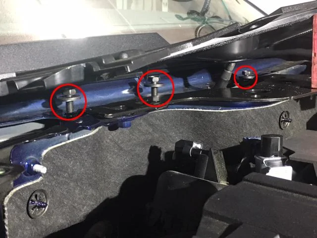

4. Now, take 3 of the 4 cowl panel bolts, which are identical to the 4 bolts you already removed to take out the plastic cowl brace, and install them into the BACK SIDE of the cowl extension panel. DO NOT install anything on the front side yet. Torque to 26 ft/lbs
You can see in this image where the bolts should go (circled)
And another angle with them secured, and my 2x4" piece that I used to hold the cowl up.

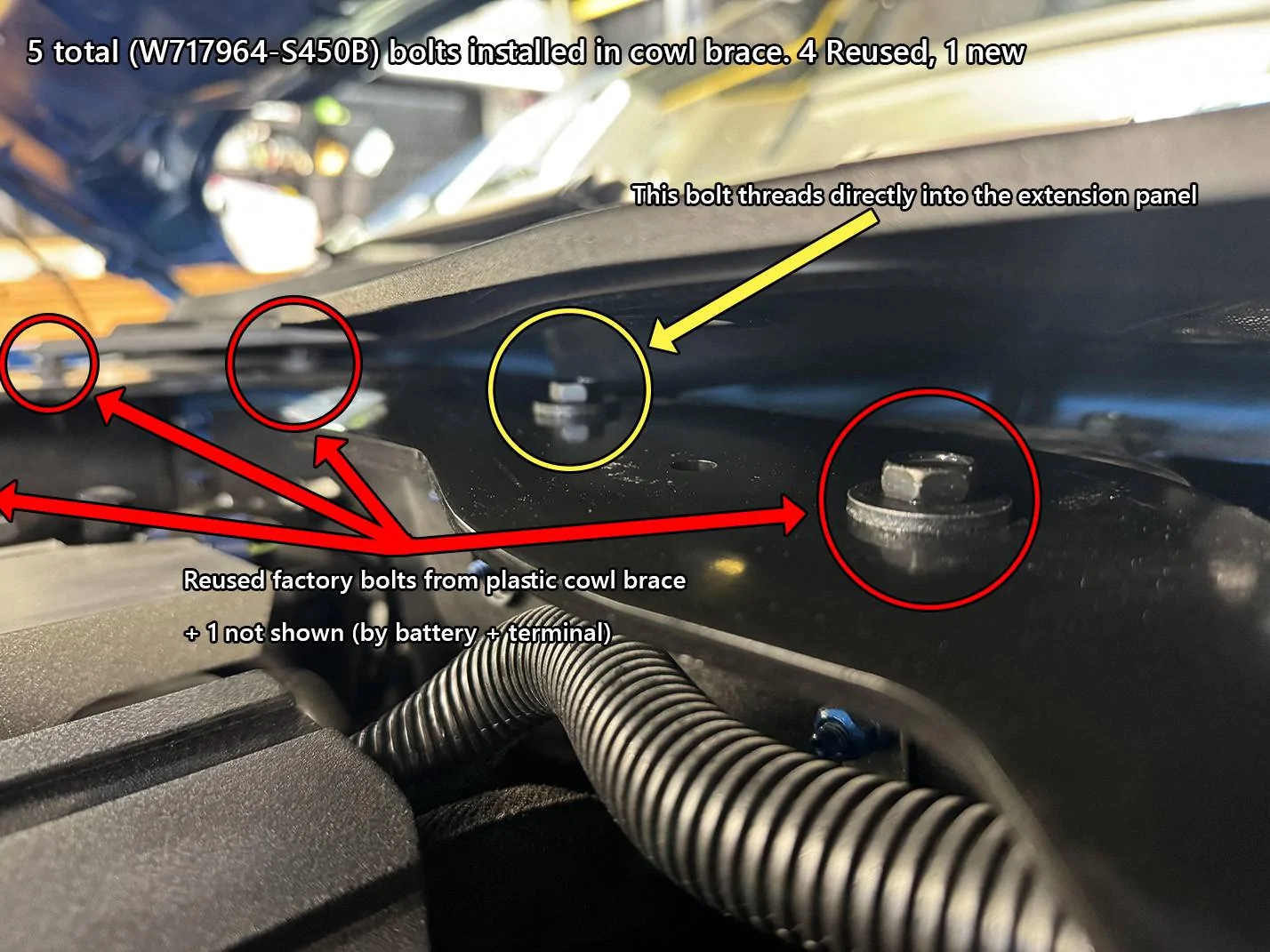

UPDATED STEP: The AM instructions (and my initial version) omit that the 4 reused factory cowl bolts will leave 1 bolt hole unused when installing the metal cowl brace and extension panel. Thus you need to order 4 total (W717964-S450B) bolts to make sure there are 5 bolts installed in the metal cowl brace. New image below:

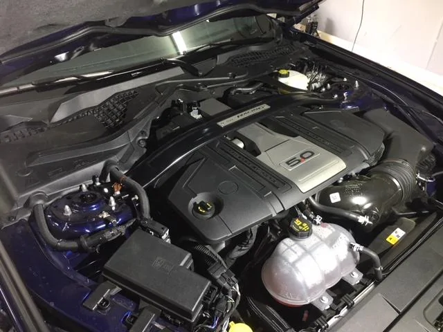

Now, continue where you left off on American Muscle's STB install instructions (step 6), and reinstall your windshield wipers.
Part 1 is done!

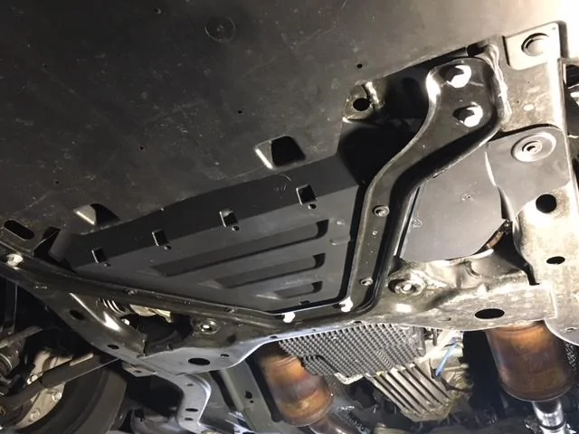

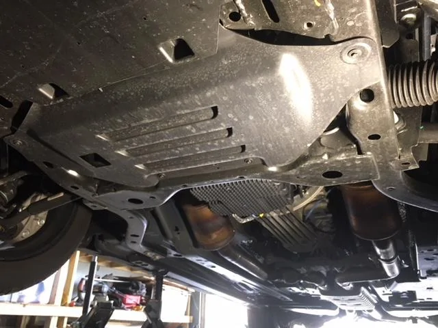

This is what you will see:
That ribbed plastic piece is the 'insulator' that the non-PP cars have. There are 6 small bolts holding it on, remove them all and pop the insulator out.

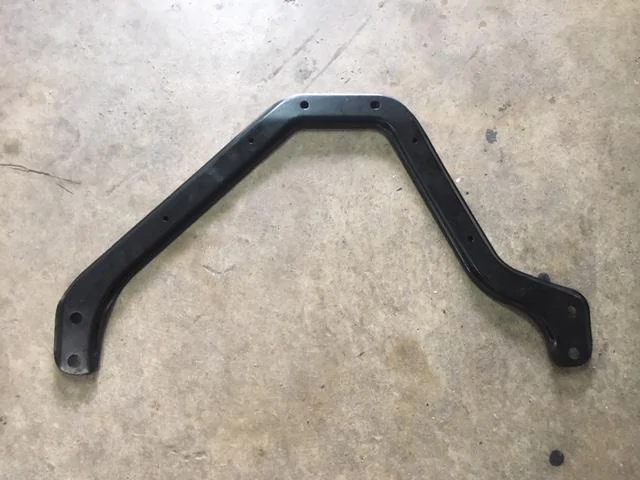

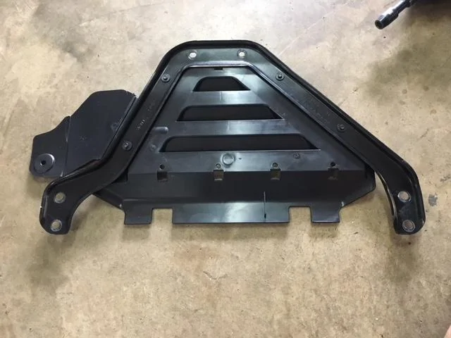

This is the GT PP lower K brace, it is oriented in the way it will install (bottom of image towards the front of the car)
2. Take 4 of the small bolts you just removed from the other insulator, and secure your new insulator onto the K brace, note how the pieces fit together in the image below. In this pic, it's flipped upside down to show the bolts. The flap that you see is actually going to be on the right (driver's) side when you install it.

Install the 6 bolts and torque to 41 ft/lb.

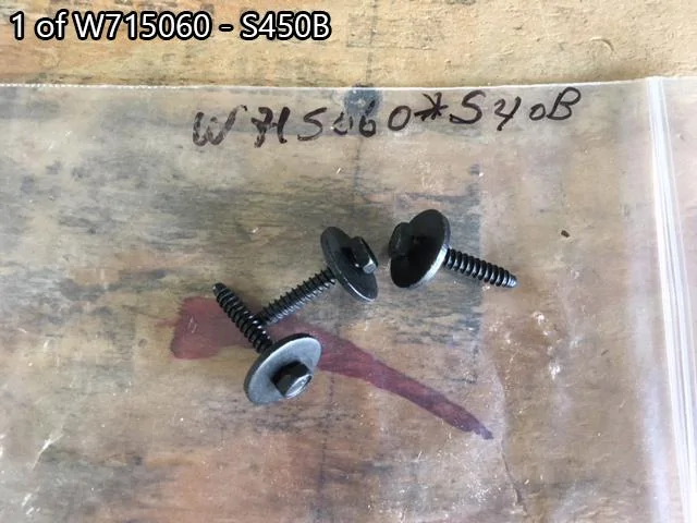

Reinstall 2 of your 3 remaining insulator bolts (small ones) to the front holes that secure the insulator to the large plastic splash shield (Square indentations).
Now take your 1 extra small bolt that you had to order (you can see that I ordered 2 too many):
Install it to hold up the oil filter access panel (it's obvious)
Finished product:

It'd be worth pulling your cowl panel up a bit to check and make sure you have the firewall connector too. Once I added that (already had the upper and lower K braces, strut tower bar), there was a surprising but noticeable improvement in composure and ride. I would expect that you do not have the lower K brace.
I'll check that out tomorrow. Hopefully it's there. Is that it in the 2nd photo in the original post?
Yes 2nd and 3rd pics. You probably do have it.
