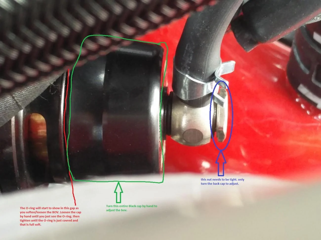

I asked enFOURcer on another thread about the TS factory replacement BOV sounds. I noticed mine has 2 sounds that seemed like surge but...
looks like the rubber O ring is completed showing so its backed too far off. the large O-ring needs to be covered by the cap. I run mine at full soft just so the cap just covers the O-ring.
base on the photo. which is? left of right o ring?

I took another look at your picture and compared it to my bov.. This should help explain it I hope..

I did everything as everyone here suggested and the car still does not do a big woosssh. All I get is surge. Before the BOV I actually get the woosh from the intake. Could it be faulty??
Can you post pics of the install?
Sounds like a vacuum reference issue.

Im pulling vacuum from the back of the intake and I get best results oddly enough from what others have posted by tightening the bov full tight then a half turn loose. You will get some surge at low boost between 2-6psi however thats on light throttle release. If you remove your foot abruptly it will still vent

I found out the problemproblem. It is the vacuum collapsed when it vacuum. My buddy replace it a beefy and on it woossshh when higher boost is builded.
