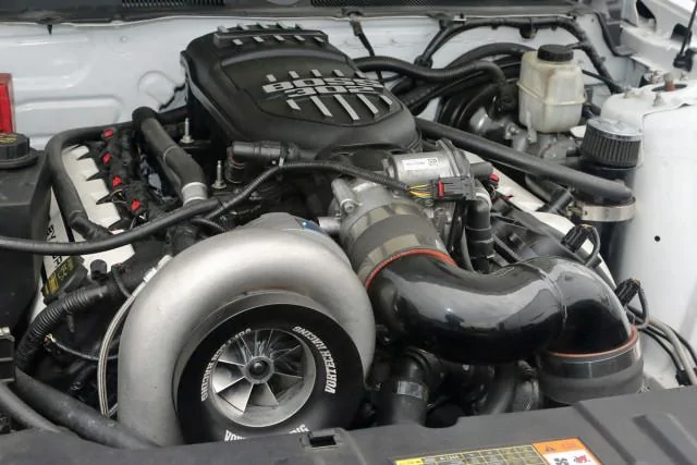

Vortech jt-b, for me. If i wasn't going with that blower itd be a paxton novi 2200sl. Only two centri blower choices worth looking at in my opinion. Jt-b pictured below.

Looks like a nice setup for sure. I Think I'm going to wait for the Paxton and then choose between Paxton and vortech.

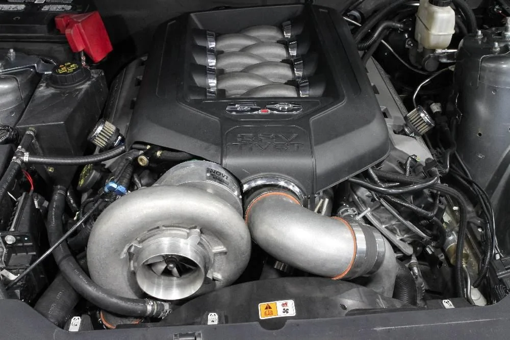

This is the novi kit incase you were curious. I can't justify 14g for twins when i can have a jt-b that will make similar power for 4g less. Whatever you pick, im sure you'll be happy. Force induction is great.
