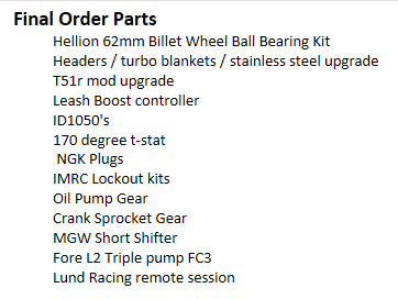

so after couple of month of research, I deiced to go with the Hellion TT top mount on my 2018 gt manual. you will see all the parts I'm getting for the build in the screenshot below. All these parts combined including installation at a shop will be about 23-24k. is that the right price for all this ? installation itself is 5k. I know I'm getting the top line of my fuel system but I rather to have something that can handle big power now for future hp increase. I'm keeping the engine and transmission stock for now and slowly work on upgrading all my suspension. my car will not see drags at all, only roll racing (rarely). What is your say on the build I listed ? pricy ? and what would be a safe max whp in your opinion with this setup ?
anyone here have the same setup installed already can shine in and give me their opinion please!

When I first read your post that sounded high but I added up your list and it comes in around $19k. Figure about 40 hours labor at $125 and there is $5k do I'd say the quote doesn't sound unreasonable.
Since your doing a fuel system I'm assuming you plan to run e85? I'd say 700hp on pump gas or 800 on e85 will keep you safe ish. But when you boost the car things can happen. Most will long lives at or under those power levels. Some won't. Some will live up in the 8-900s on e85 and stock engine just fine. There is always the what if factor. After you drop over 20k on this build do you have money left over to replace the motor tranny if need be? If not I would think about scaling back the build for now and do some of the upgrades to the kit later so you have a cushion. If engine money isn't an issue then get the kit installed crank it up and send that shit. These cars are a blast with a hellion set up.

$5k for the install is not terrible (although still pretty damn high), but $19k for just the parts...holy moly are those turbos made out of gold? A good fuel system is a few thou so I get it, but that means just the turbo kit itself with no fueling mods is $15k? Yikes.
The turbo kit with headers and ball bearing/stainless upgrades is about $11-12k. $4k for fuel system and injectors, $1200-1300 for remote tuning session. Close to $2k for the other additional items. It all adds up.

Dropping it off and picking it up all done, I don't think it's out of line. Everything is expensive now. If you could install yourself, it's significantly less expensive.
I'm not sure you need the ball bearing upgrade. My "cheap" journal bearing turbos trapped almost 150mph the first and only time I've been to the track. Don't let a journal bearing turbo scare you.
I'm not saying they're not, I'm just saying that's an insane price when you think about it.
