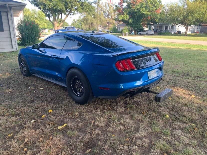

1000whp, 315/60R15 ET PRO's and 200lbs hanging off the back and it can still be a struggle. welcome to the street! LMAO
I thought that weight rack on the back was a rubber bumper for backing up into a tight garage or something. Nice and easy way to add and remove weight when needed.
