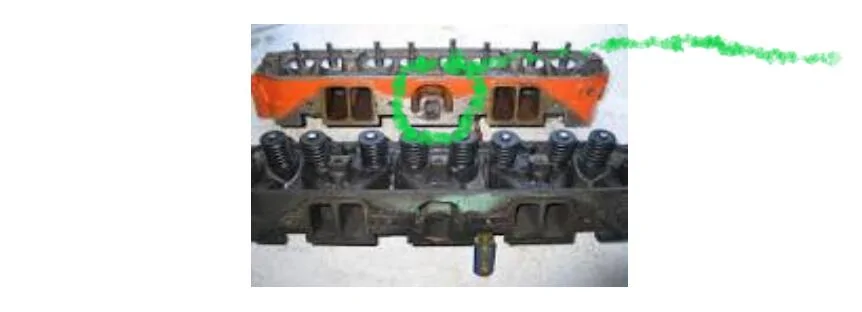

A lot of the old engines in the 70's had an exhaust crossover in the inlet manifold to speed up the warm up process to lower emissions. If you blocked this off it totally changed the sound these old engines made. Interestingly if you fit alloy heads to these old engines the exhaust crossover is omitted.
Those heat pipes never carried exhaust though, they were just hot air radiating from the manifolds, right?
He is not talking about the flex pipe from the manifold heat cover to the air cleaner. These are openings for exhaust gas to travel into the intake manifold. EGR.
Circled in green
Ahh totally different thing, never saw one of those before
Depending on the year, they either just flowed under the carbon to heat it, and, in some cases, bled off for the egr. Most aftermarket manifolds had this blocked off.
