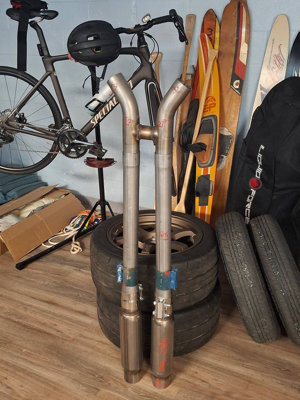

I have the Lethal/Kooks Catless LT's and am going to replace the OE suitcase with two 3in bullet resonators [ $68/pr off feeBay ] adapted down to 2.5in into 2.5in H-pipe I cut off my 3v exhaust and keeping the stock AVE mufflers
That should deepen the WOT tone and cutout the trumpeting in track mode.

That's pretty much what I did, added 2 vibrants in parallel at the H pipe and it doesn't sound too raspy. Ignore my friend screaming

sounds fantastic. Can you tell me the exact parts so I can buy them lol. My only concern is I have Catless headers so I already have that insane rasp from that regard….
Thanks man, I got a pair of 12” MBRP resonators and magnaflow mufflers P/N: 14419.
However if you have LTH’s I would recommend a 16” or 22” resonators to help tone that down.
