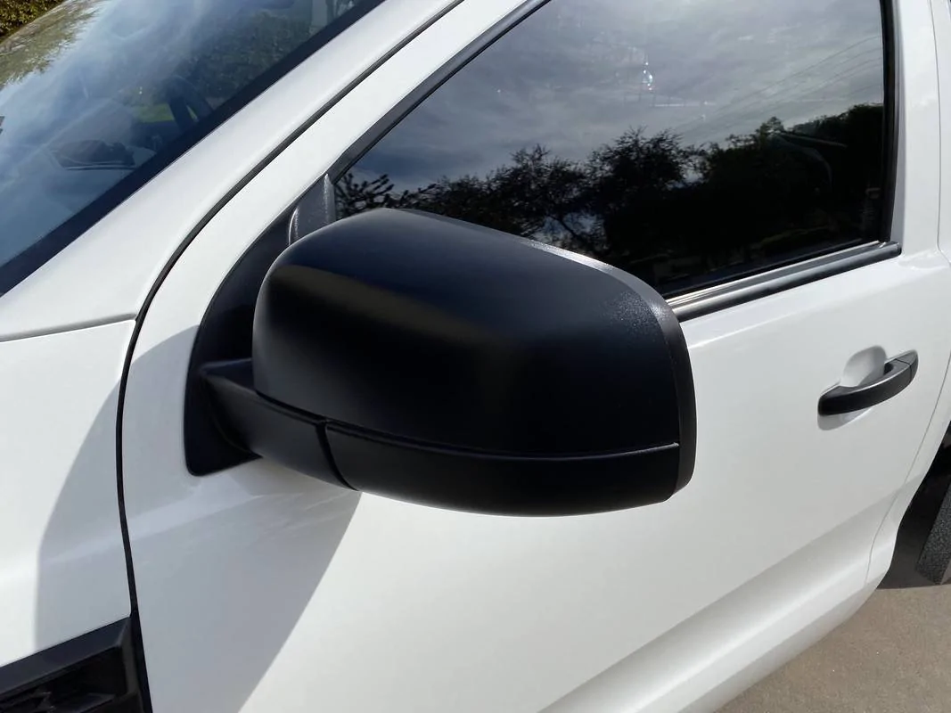

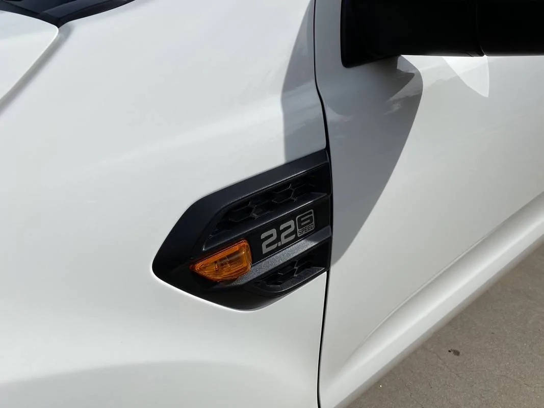

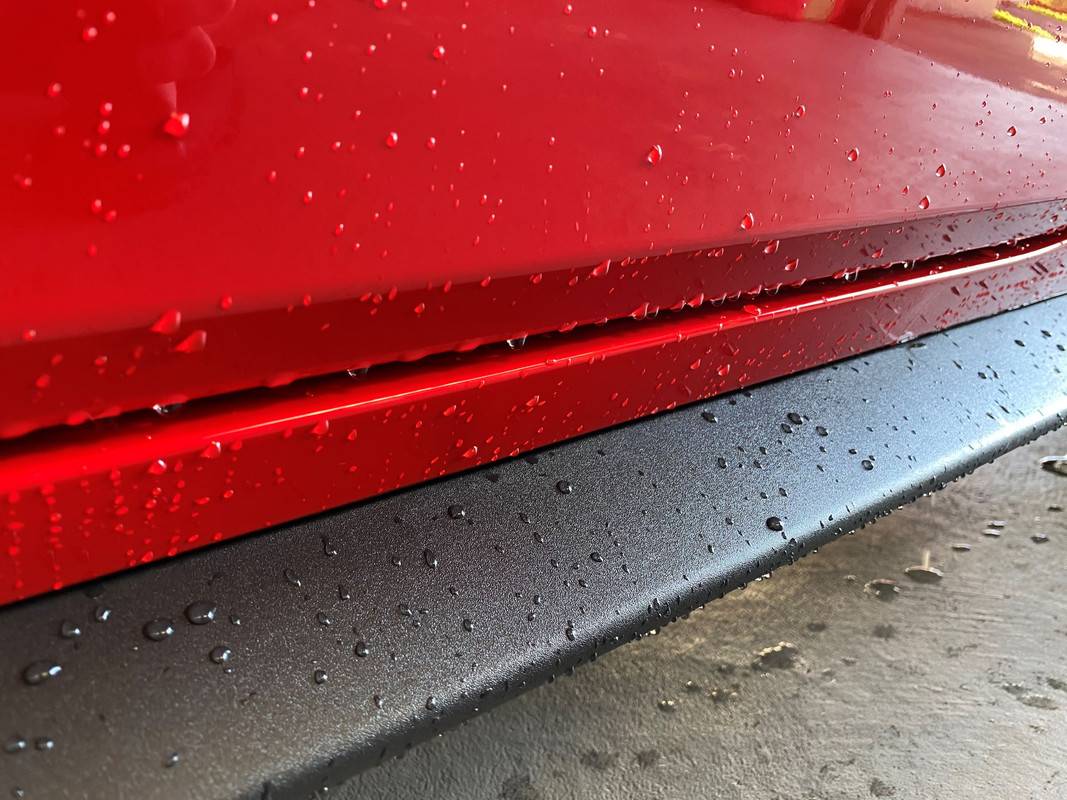

You can deal with this with a number of products, and it will depend on how bad they present.
I actually really like 303 on trim like this, but it's effect will not last very long owing to it's water based formula.

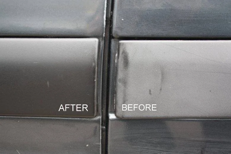

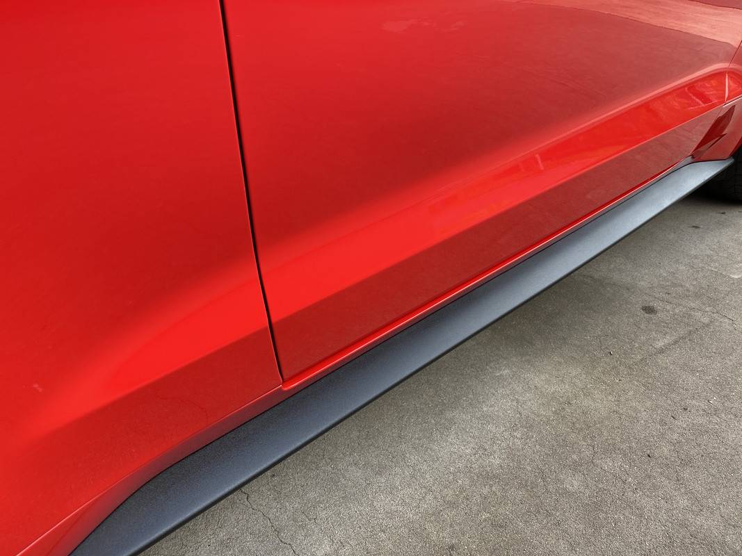

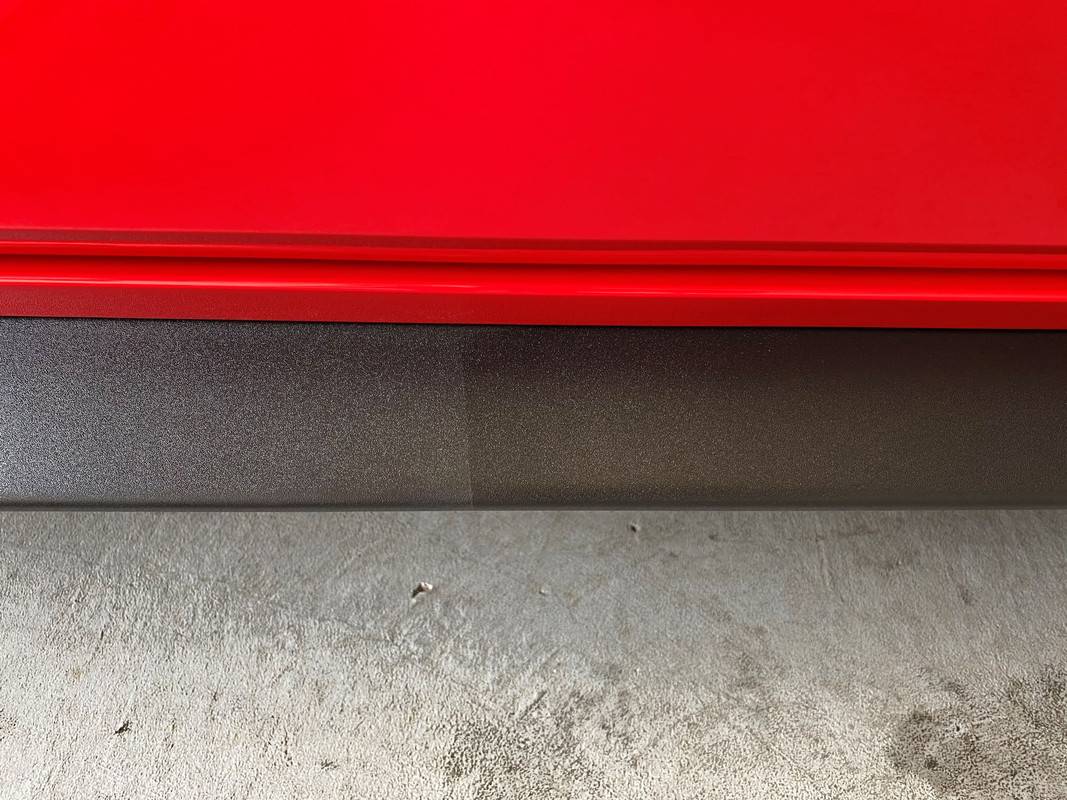

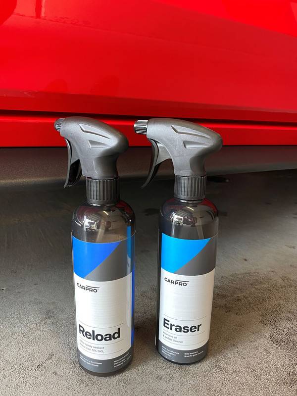

Another product I like on trim is Carpro Reload. It's effect will not be massively different, just a richer shade of black. This would suit trim already in decent condition and will last 4-6 months.
(Reload treated side on the right.)

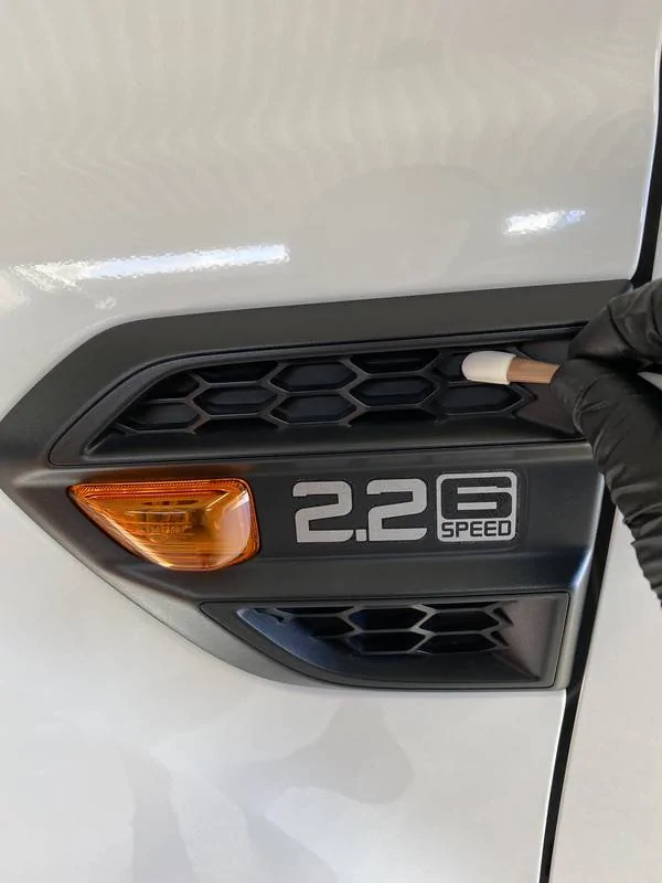

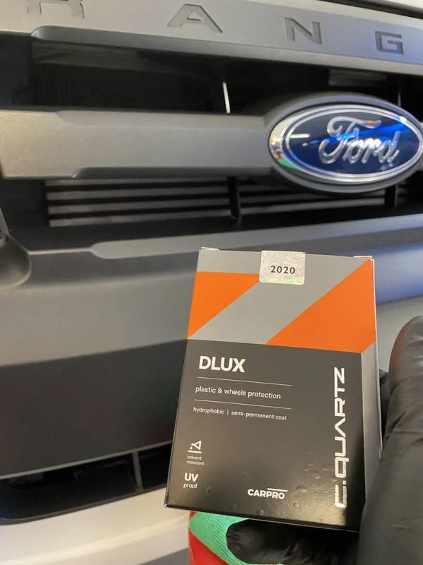

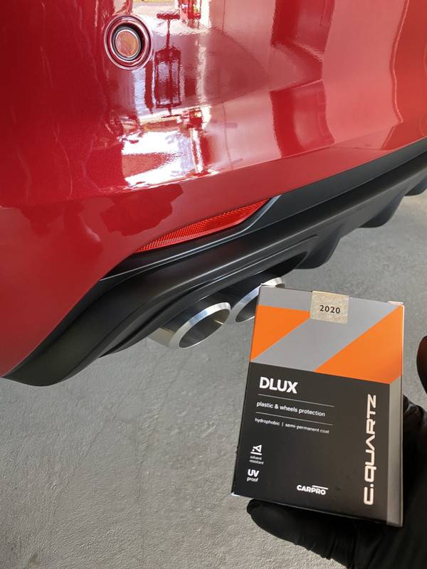

Carpro DLUX is also a good product to use for trim, it can protect and prevent UV damage or bring back faded trim. This is a longer term solution.

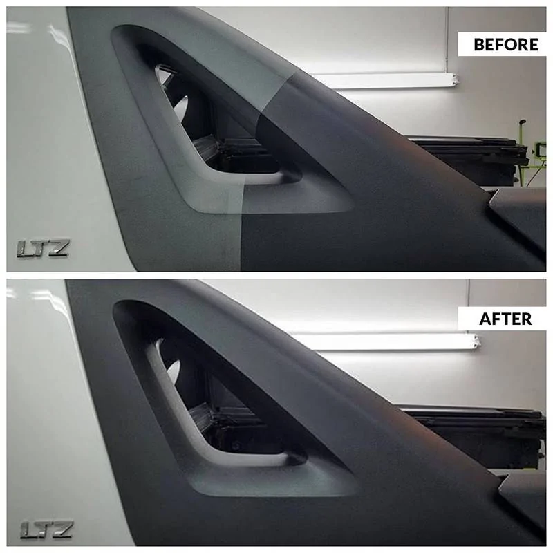

Another option would be Solution Finish. This is a permanent solution to already faded trim.
(16) Restore Faded Running Boards | How To Use Solution Finish - YouTube
All of those products leave trim with a matte/satin sheen with no greasy/oily/shininess at all.

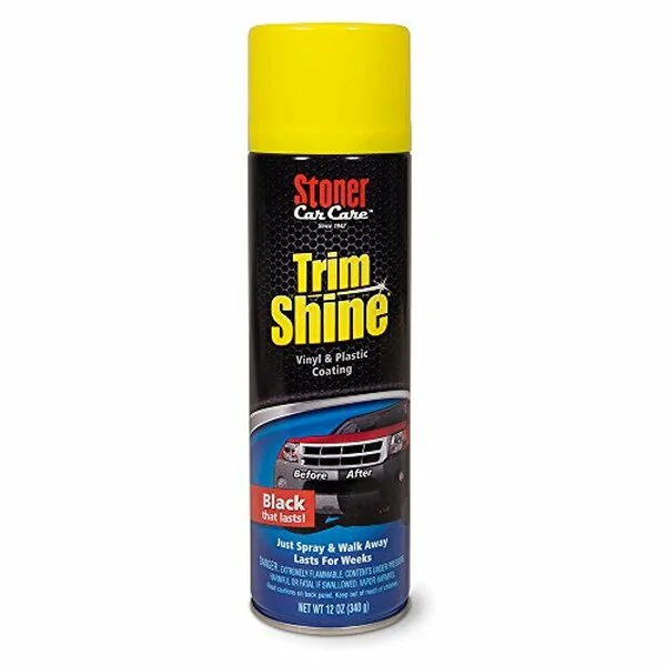

I love this stuff:

Before I sold my 8 YO Ram 1500, I got the Stoner to treat the trim after Back to Black and some Meguiars stuff failed miserably. I could NOT believe how well the Stoner worked. But........... the truck sold in a few days, so I have no idea how long it lasted or if it rinsed off, streaked after rain, etc.. But since the can actually says it lasts for weeks, I'm guessing not much longer. And since they refrained from saying months, I'm guessing the number of weeks is less than 9. LoL

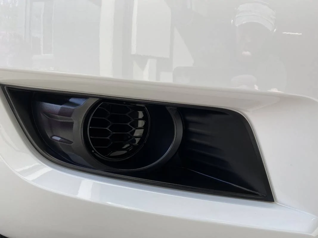

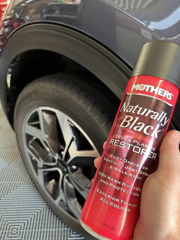

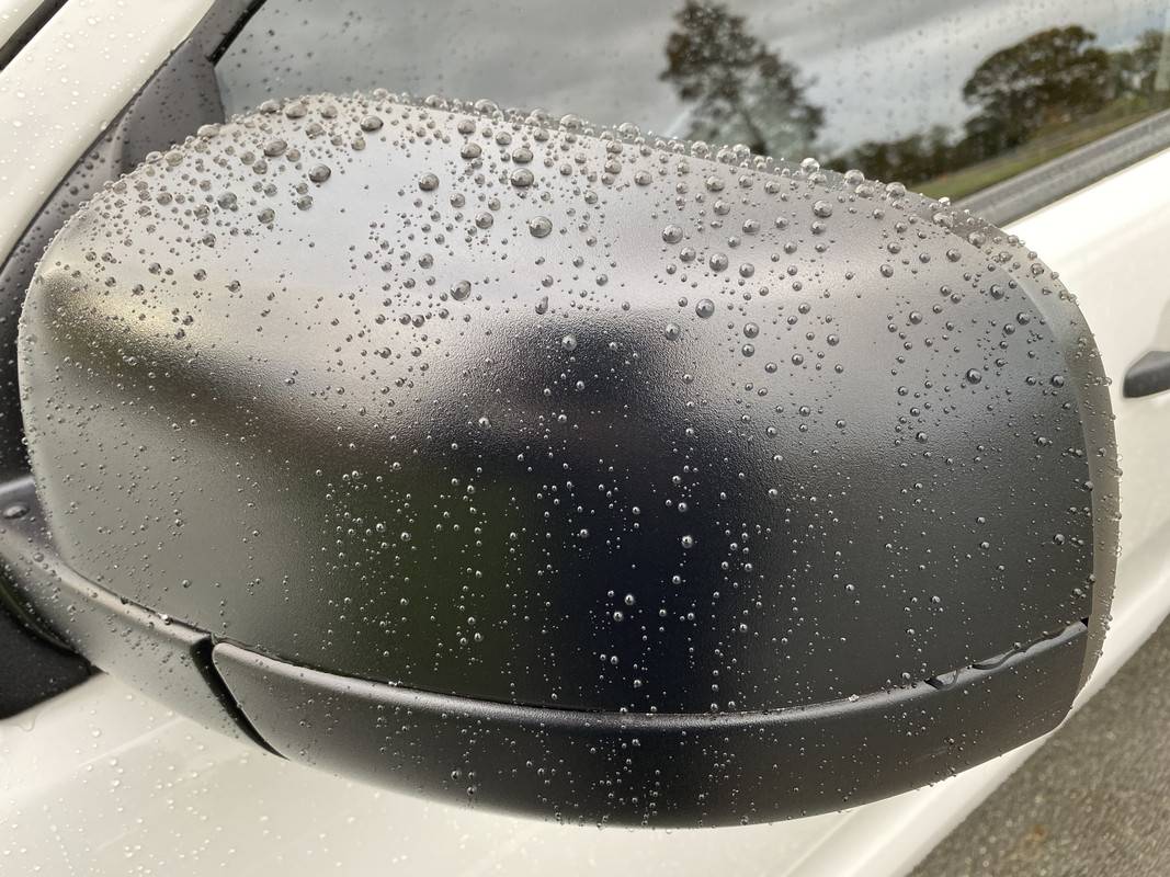

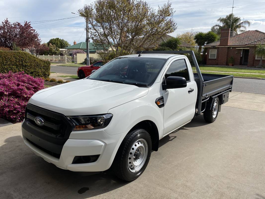

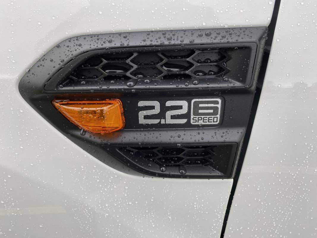

I detail a few cars on the side, I wanted something quick and easy to spruce up black trims. I actually went looking for some of that Stoners but couldn't find any in stock across various outlets. I ended up with a bottle of Mothers Naturally Black.
It's actually a really convenient product to use and is supposed to be "100+ wash durability and protection". This would also be very useful for the honeycomb grill on Mustang's.
