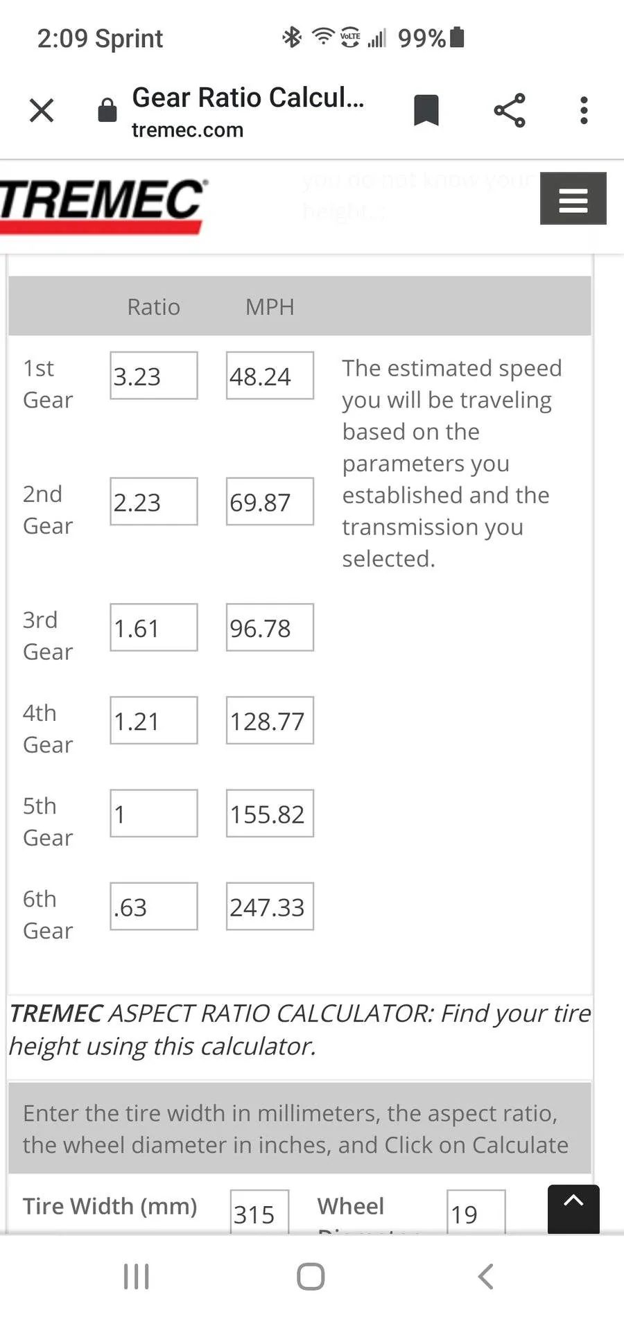

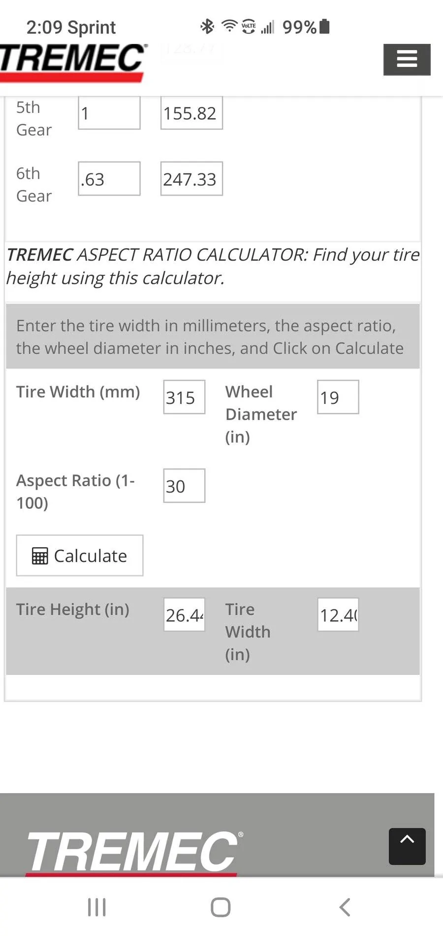

Hey everyone, I found some Tremec gear ratio information on Car and Drivers website. I crunched some numbers and here are the maximum speeds for each gear at 7400 RPM.

I'm afraid that tire calculator doesn't understand tire flexibilities any better than the rest. All those speeds are about 3% optimistic, so at 7400 rpm the speeds should be a lot closer to 46, 67, 93, 121, 150, and 239. This isn't too important in street driving, but it can be at autocross, road course driving (anywhere from HPDE up to W2W racing), and even drag racing.
Do yourselves a favor and divide the speeds from any of the online tire calculators by 1.03.
Wish they'd just round their answers off to the nearest whole mph, too.
