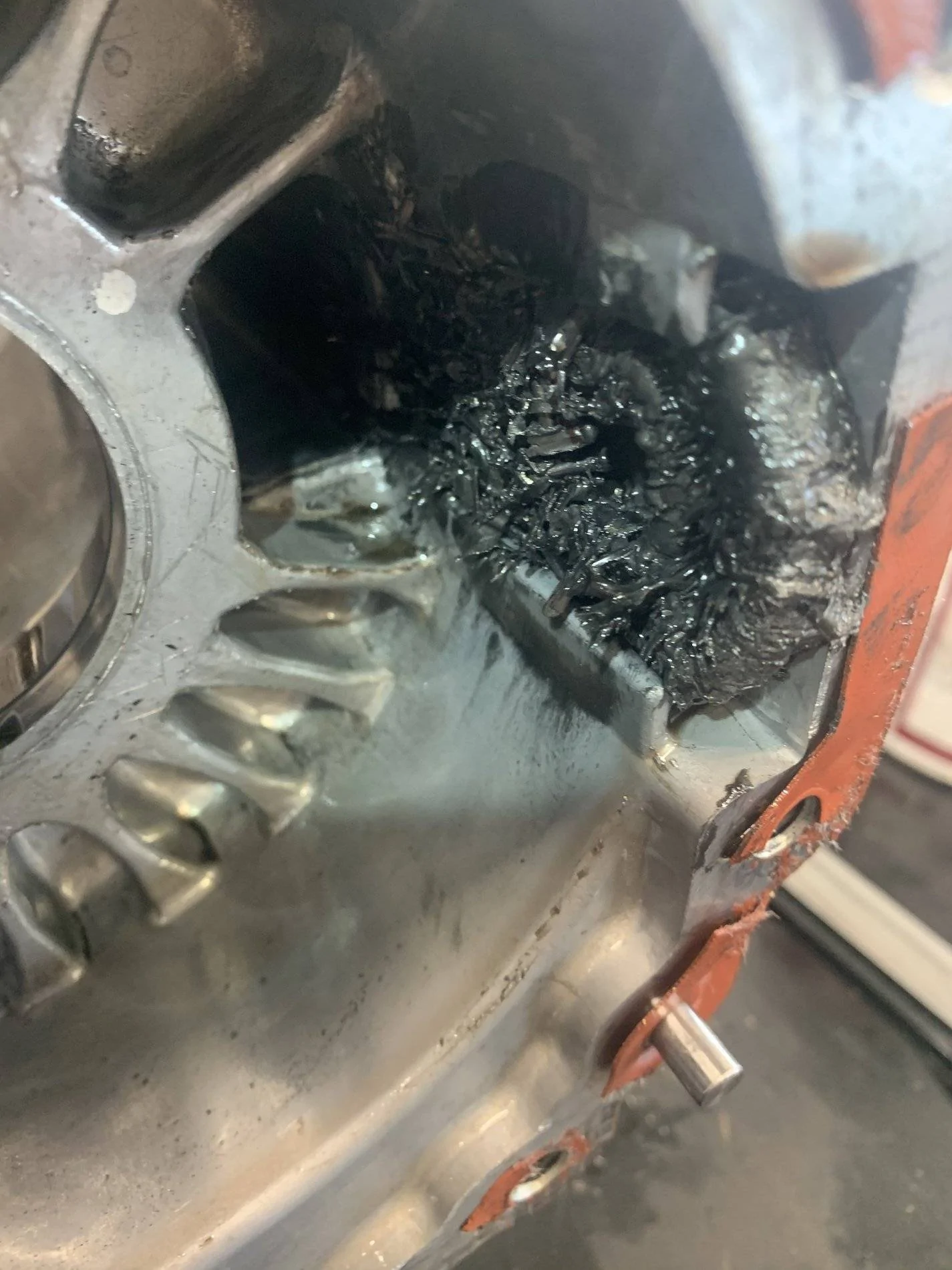

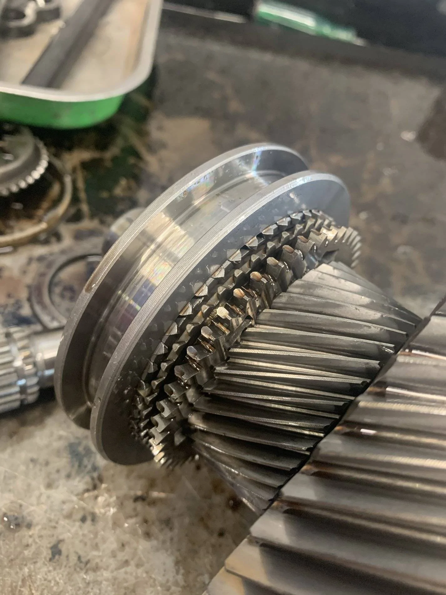

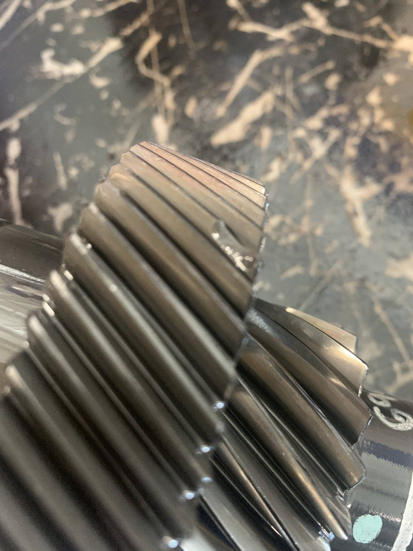

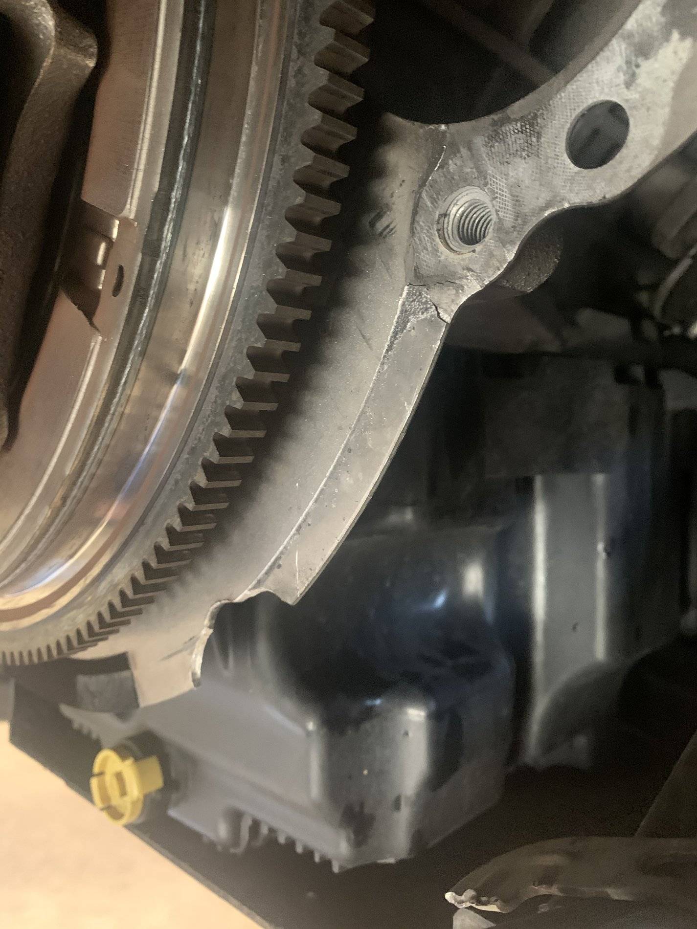

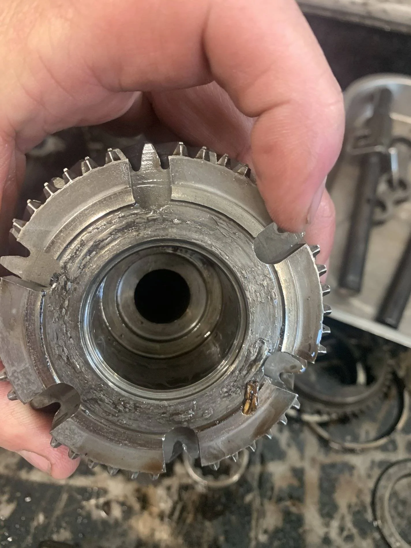

My car has about 11.5k miles now, but it lost reverse at 9600 miles (I could get into reverse fine, but releasing clutch caused grinding and kicked the selector out), all other gears worked fine. I waited about 5 weeks, never using reverse in the mean time, for the car to get to see the transmission guy at my dealer. Right before I took it in, I started having problems getting into 5th, as it was grinding.

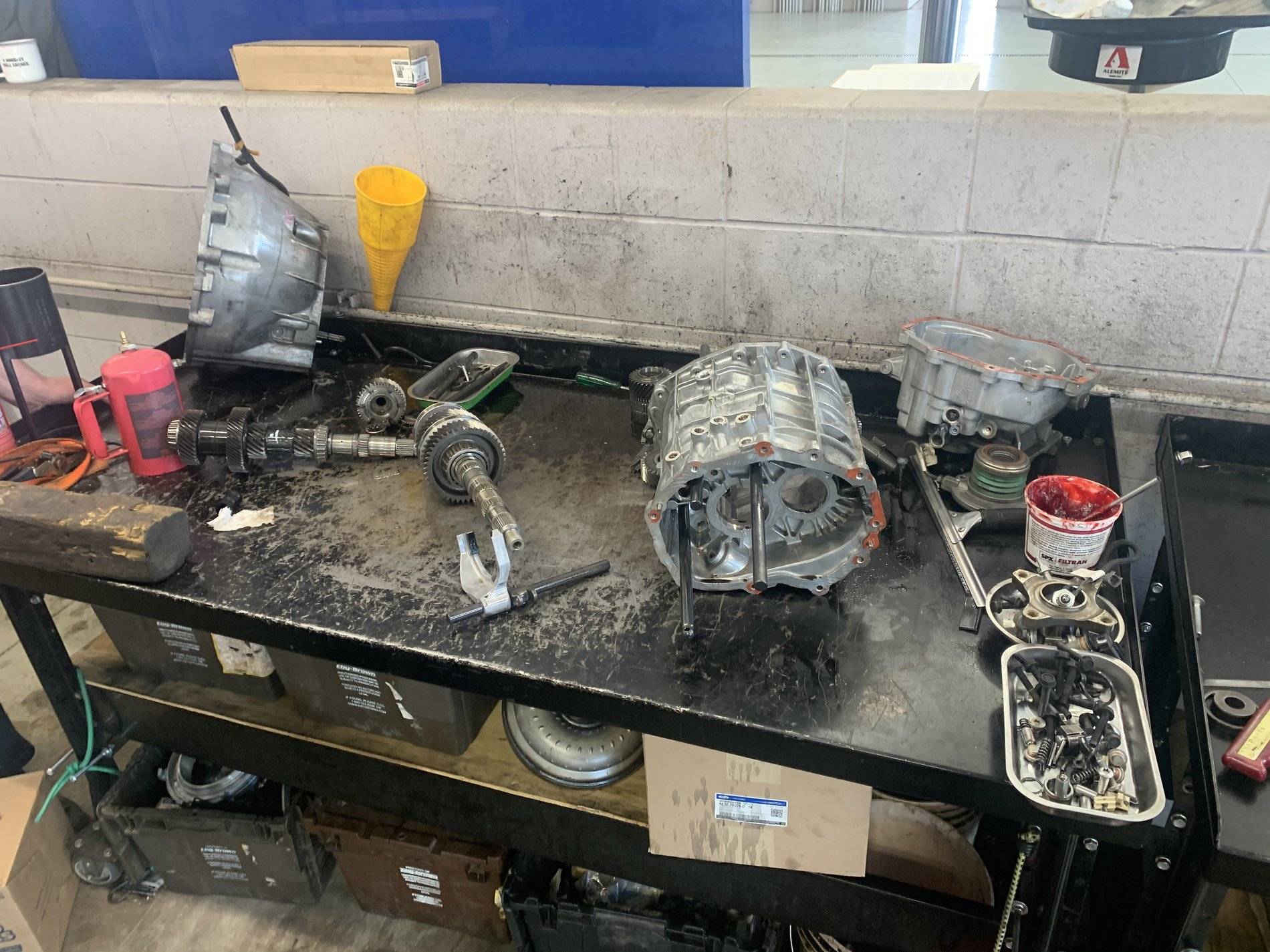

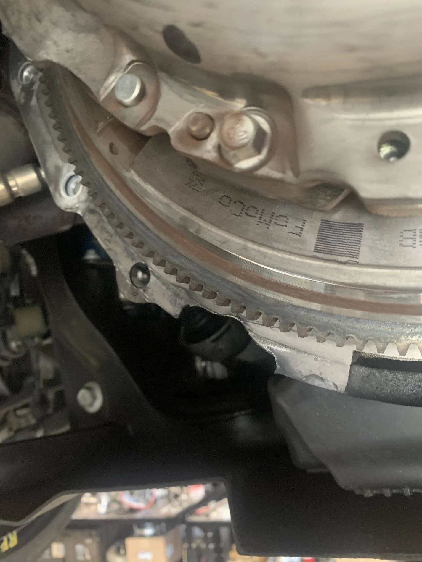

So I just got a call and all I know now is they said my transmission failed and it's being replaced under warranty. However, as the clutch is a "wear item" they want me to pay $2,800 for a new one. I am getting more details later tonight, but told them I'm not agreeing to that right now as this isn't a "wear" issue in that plates are thin and something is slipping, they are saying parts of the clutch itself are broken off. Given that the trans itself has "failed" I don't see how they can say it's my duty to cover the clutch as a wear item, particularly at 11k miles.
