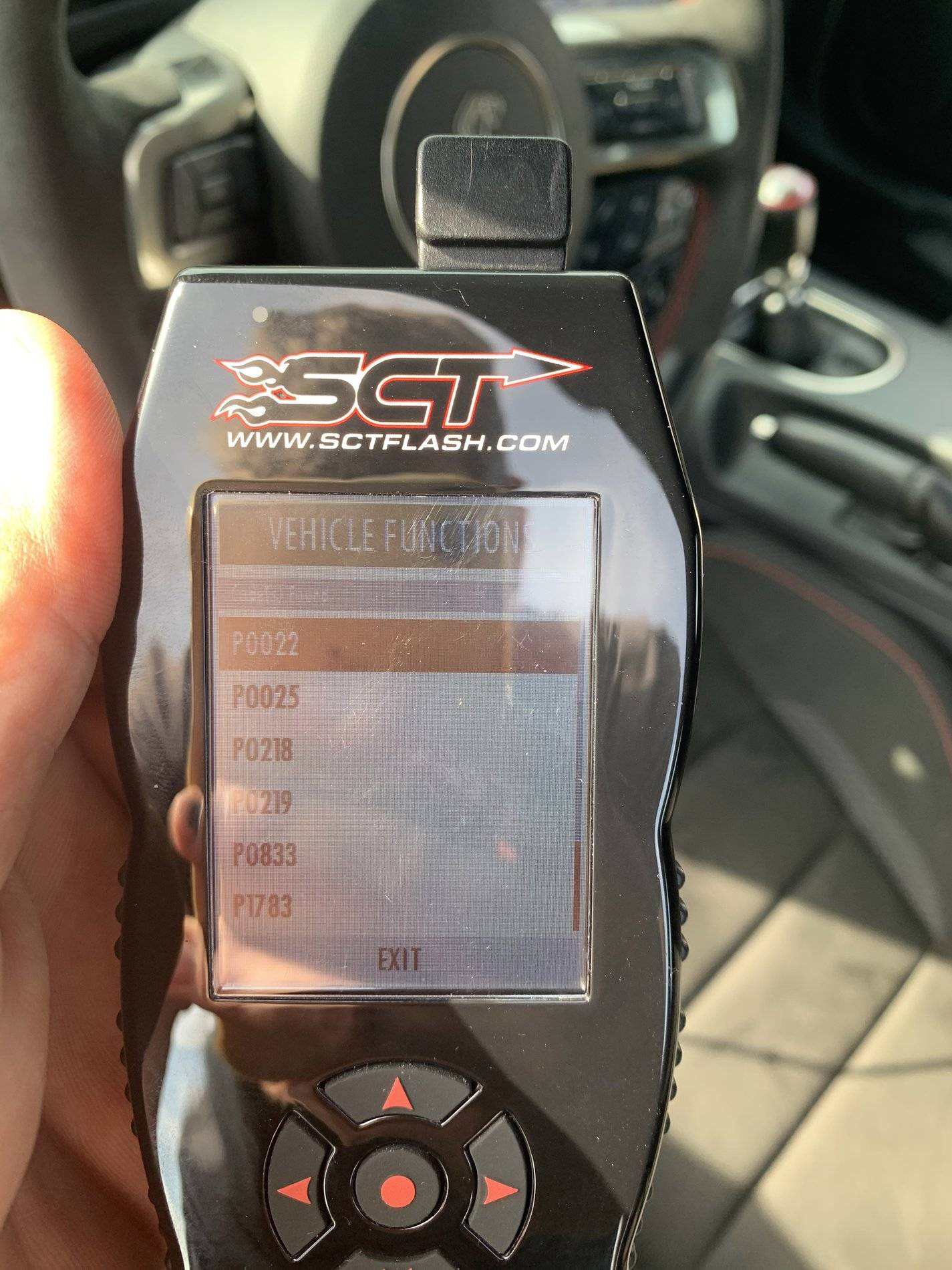

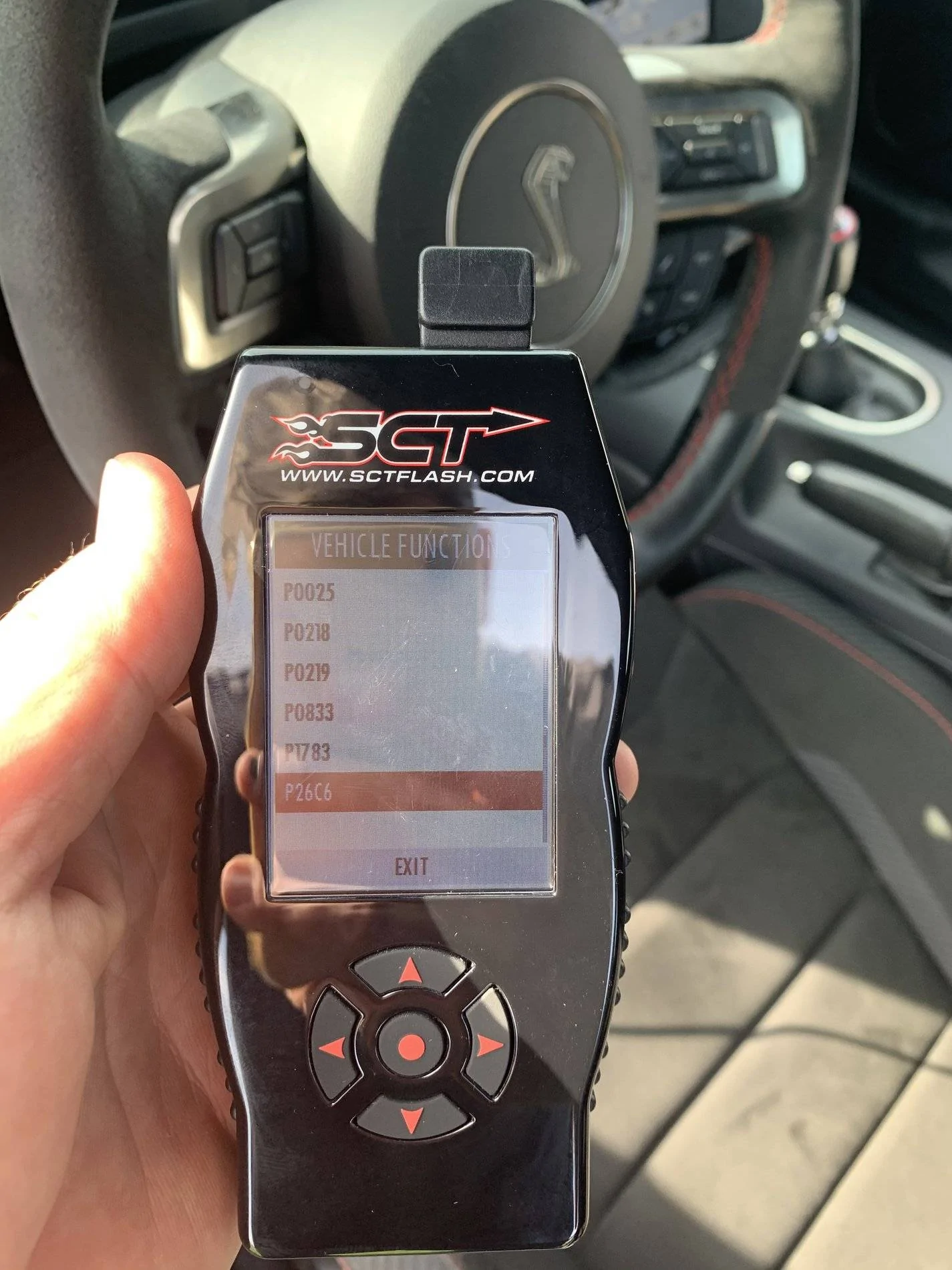

Well now 5th gear grinds In addition to lost reverse and car goes to limp mode at track after 5 sessions with a Christmas list of codes, most transmission related. Watched trans oil temp go from 160 to 275 before limp mode happened and restricted to 4K rpm.
This ruins a $520 track weekend and also my last event of the year next weekend. I plan on ditching this car and getting a 2019 or 2020 R to replace it. Still has 5 years of warranty left but I don’t have tolerance for more wasted track weekends and dealer clearly cannot fix this surging issue with the VCT. Will be making good friends with my lemon atty when I get back.

I have helicoils in my block from an ac compressor replacement (they reused bolts and they sheered off in block). I know ford doesn’t allow this and say new motor. I didn’t bring it up after the dealer did this initially when it had 5k miles and no running issues, but does a new long block come with new VCT that should actually fix my surging issue? Wondering if I should push for a new motor now due to helicoil and failure to fix surging and vct codes after 6 service attempts?
