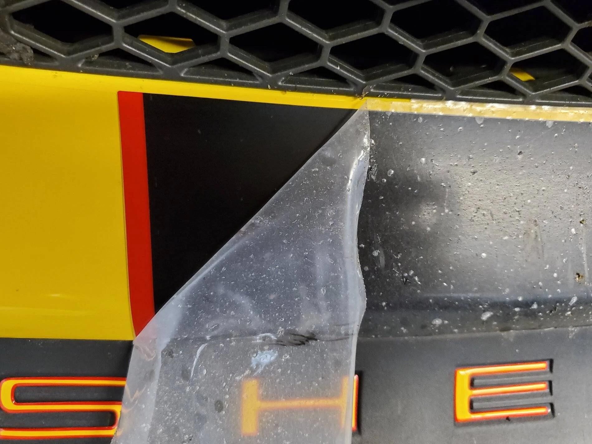

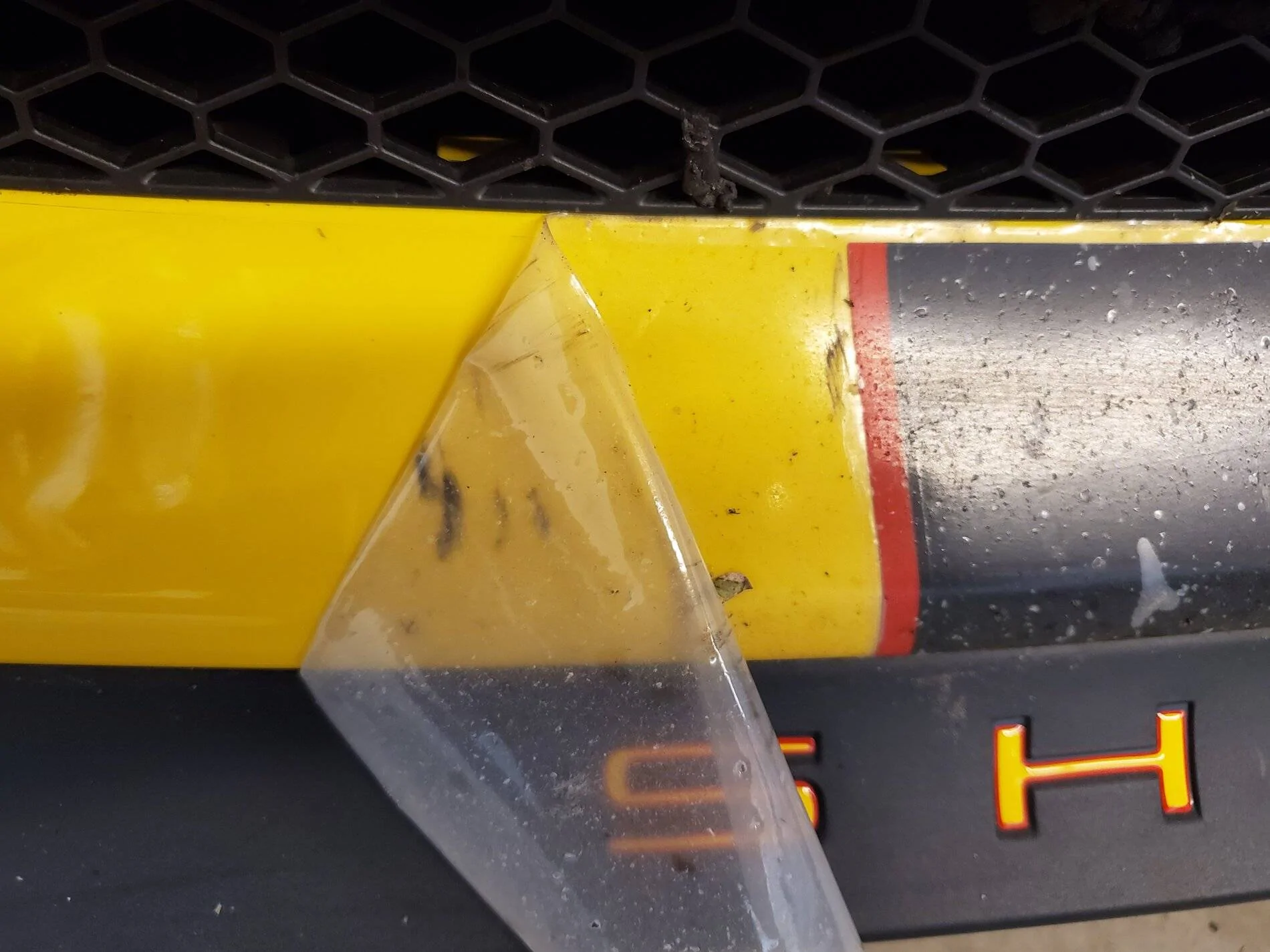

That was my takeaway as well. I use trakk tape over my PPF. Although trakk tape, (which I believe is 8 mil thick), Stops most everything from getting through, a small amount of debris does get through. The PPF winds up being your last line of defense.
If you are running slower and smaller road courses, the need for trakk tape is overkill, but on the faster courses when you are on someone's ass, your car is getting sand blasted.
The below images are trakk tape being removed from over PPF.

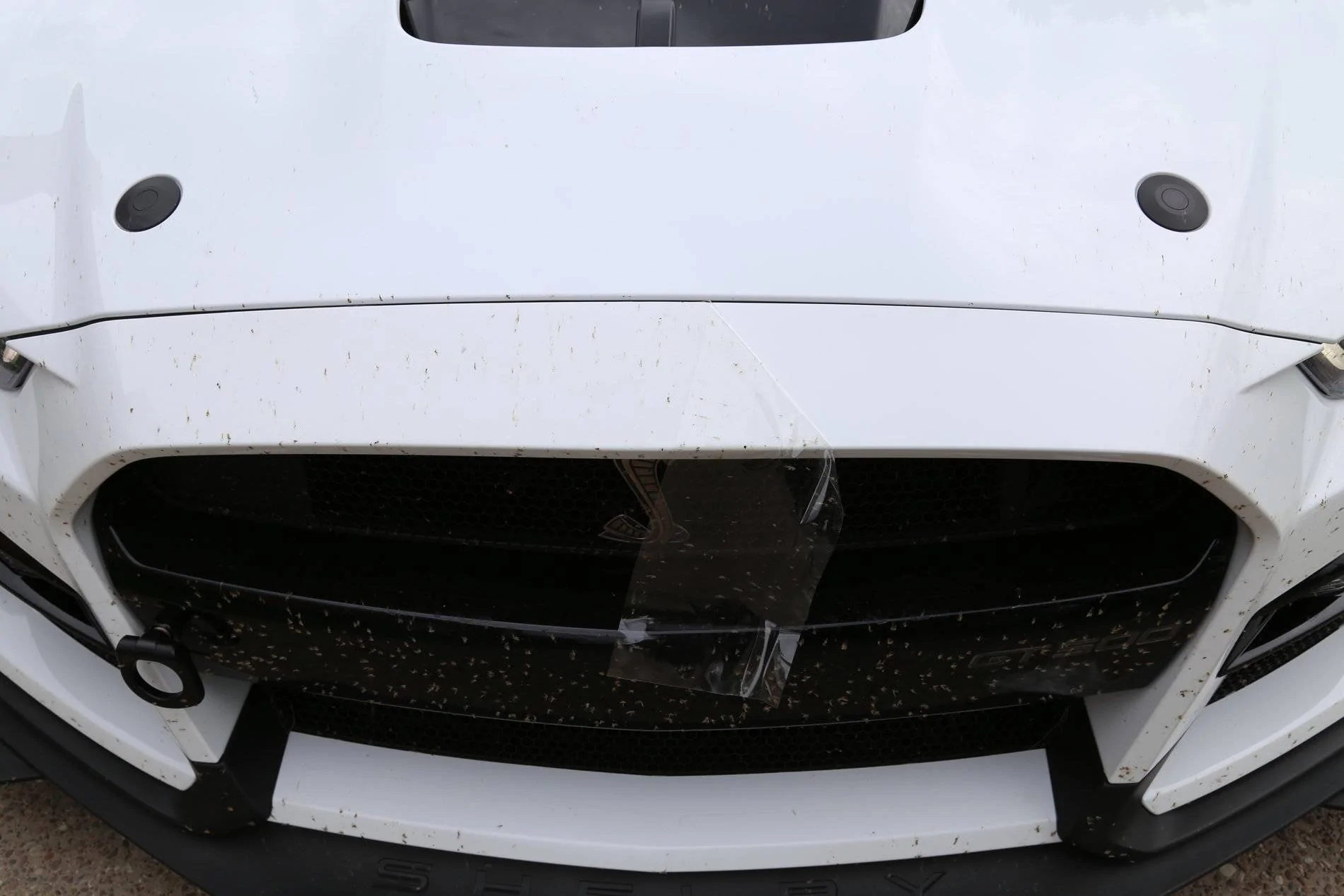

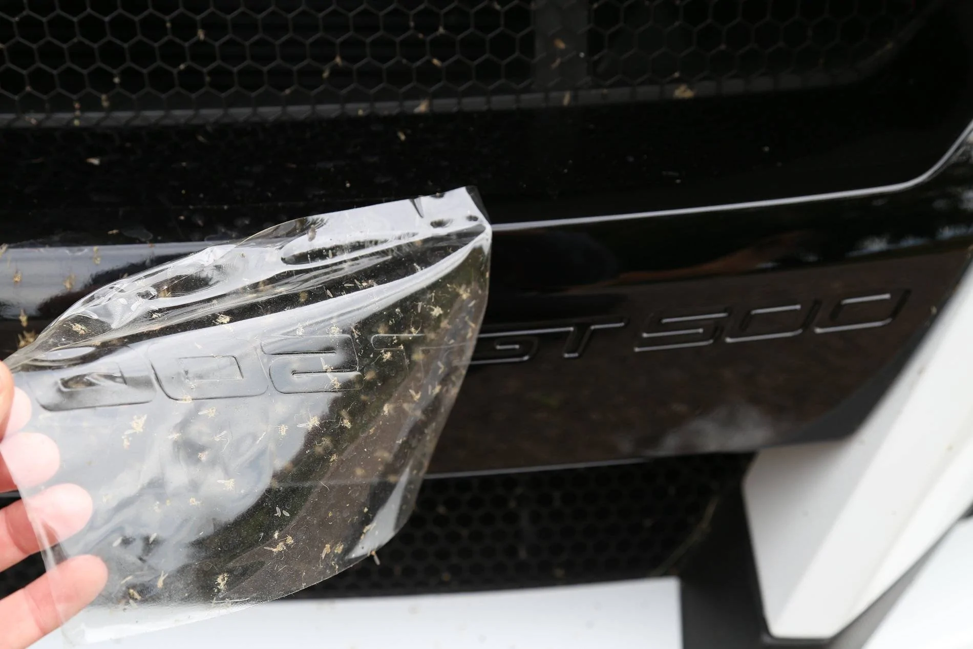

How long did you leave it on and did you put it over any stripes?
This does not sound like something that's intended for temporary use, but rather an extra thin regular PPF. Thickness appears to be about half to 1/3rd the thickness of more expensive 3M film, but the cost is also just a tenth. Seems like really good value for money compared to that, but I'd be worried about putting it over any vinyl stripes if I intended to take it off later without removing the stripes at the same time.
I didn't have it on for long but I read every review I could find and they were all pretty positive in this regard with respect to time, be it short or long. I cannot comment on how well it works with stripes but I can say it peeled off just as easy as the track Armour.

I've used Track Armour and Track Tape at Daytona over xpel ppf and both do a good job of protecting the car. Both peel off very easy after a couple of days of track use. I would never run at track without it. The tape is pretty beat up when you peel it off. I would hate for my car to look like that. See Tomster's pic above.

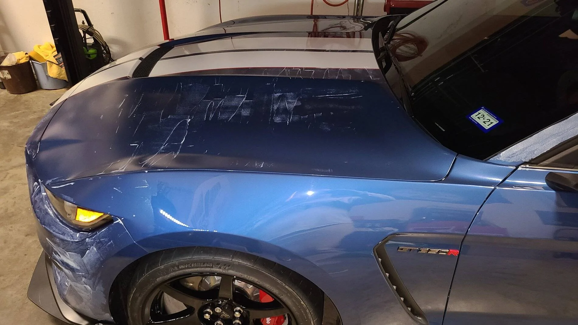

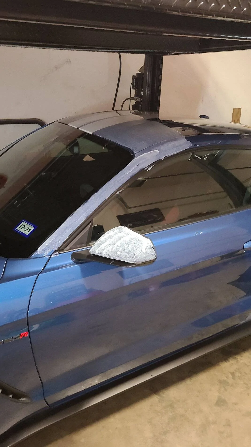

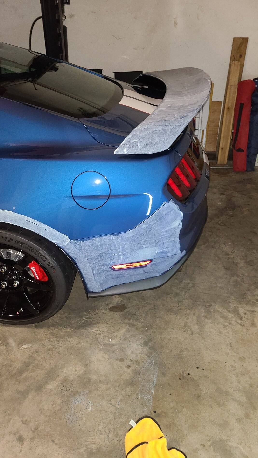

The Road Warrior Paint Protection is on. Easy to apply and looks like it will protect pretty well. Just need my tech inspection and I'm ready for Feb 20-21 race days.

I cannot see if you put it on the panels below the doors also, but I went off track and onto the gravel once, and that really messed up that unprotected panel. Ugly lesson learned.
Hope it will not rain before your trackdays, as I guess you're aware water is what one uses to remove that protection.
And yeah, easy to apply, not so easy to get off. But it gets easier with every time.

ALso can't tell if you hit the area in front of the rear wheels (behind the door). That areas takes debris coming off the front tires pretty bad.
