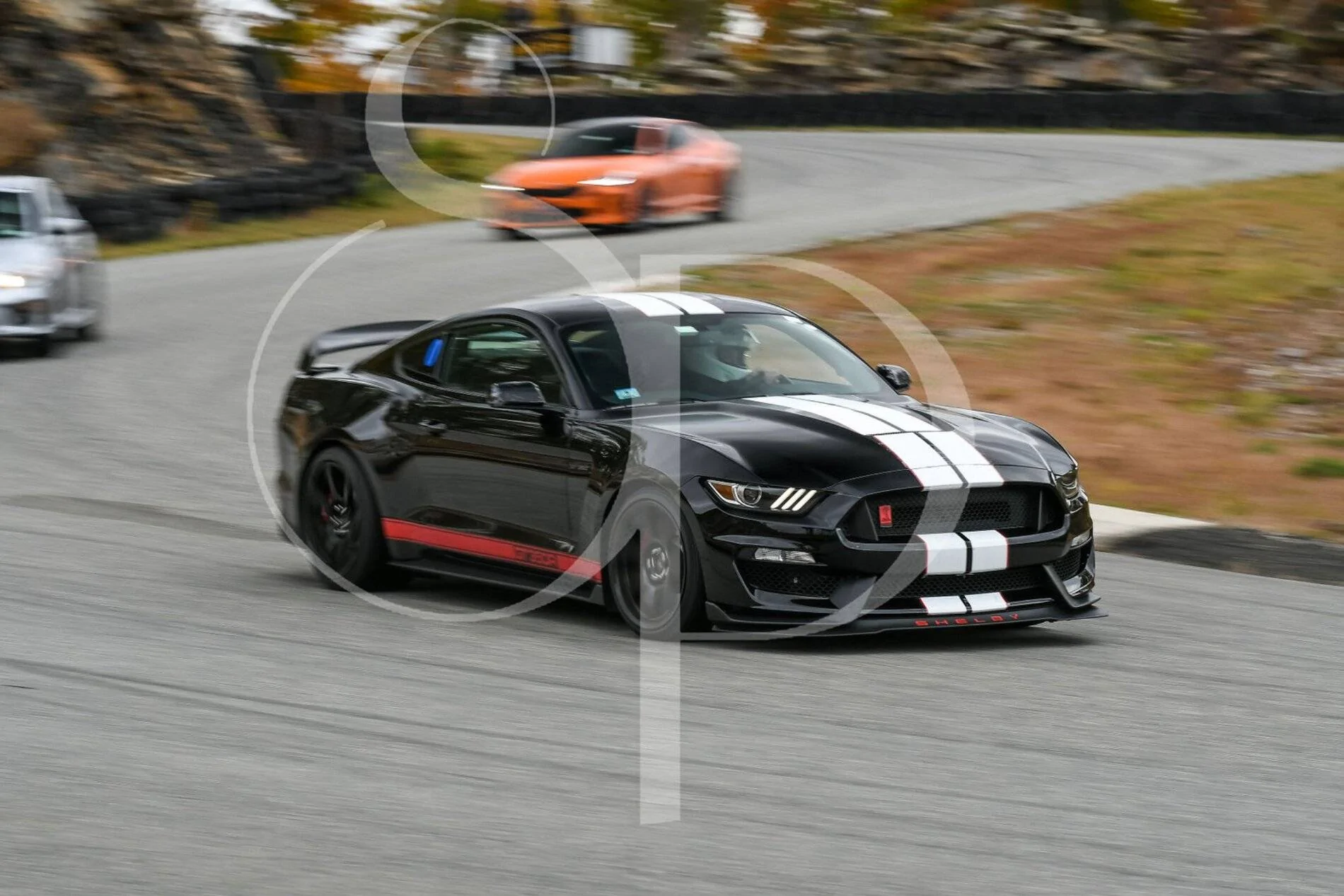

From one Texan to another, here's the poop, pardner. Track tape is cheaper but is time consuming as hell, depending on how crazy you go with it. Also, it looks like shit in the track photos that show your car lapping the field.

Here she is with tape on the stripes, you can tell...
