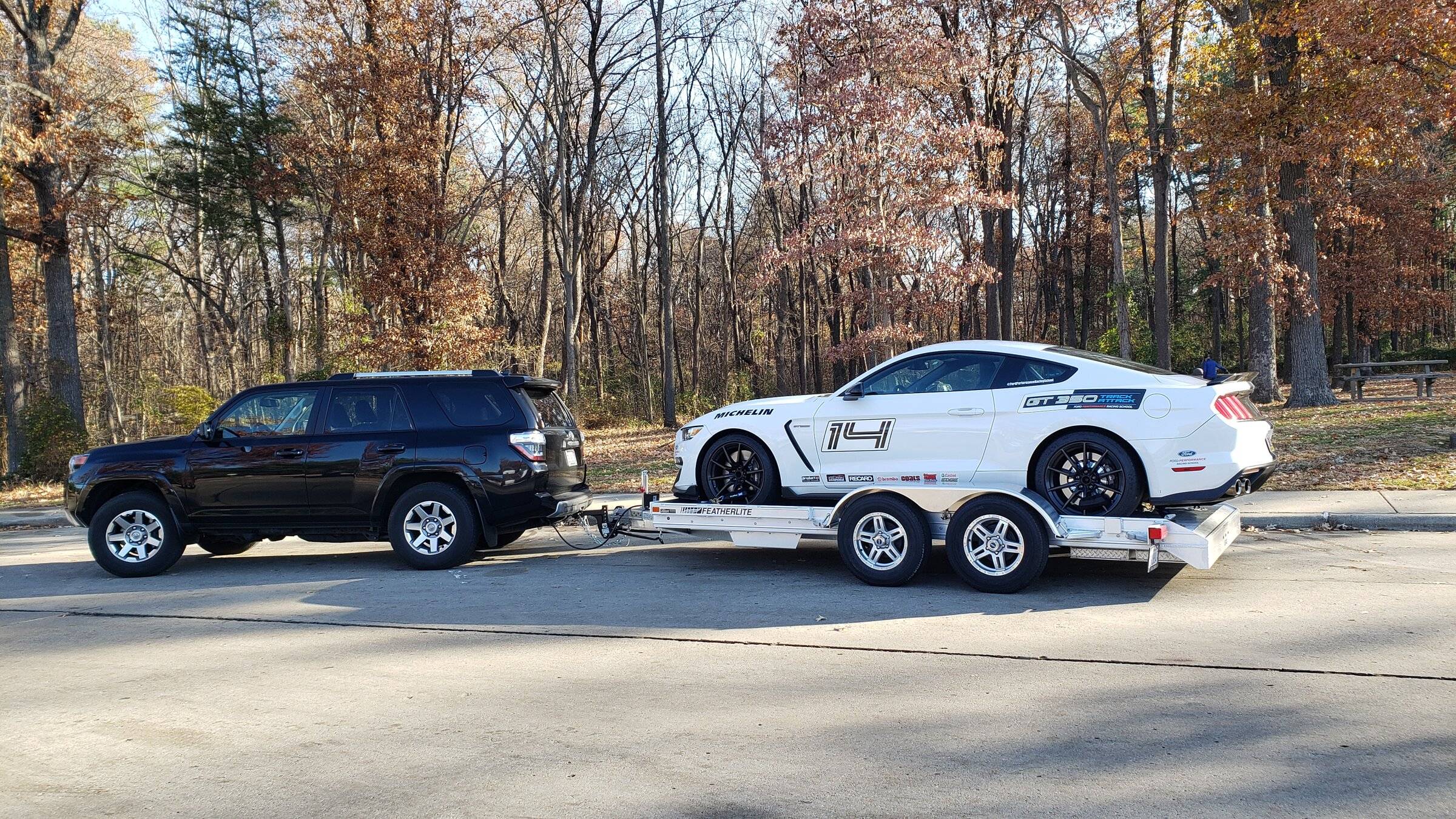

Featherlite 3110 14' - small, light, and just barely fits a GT350.

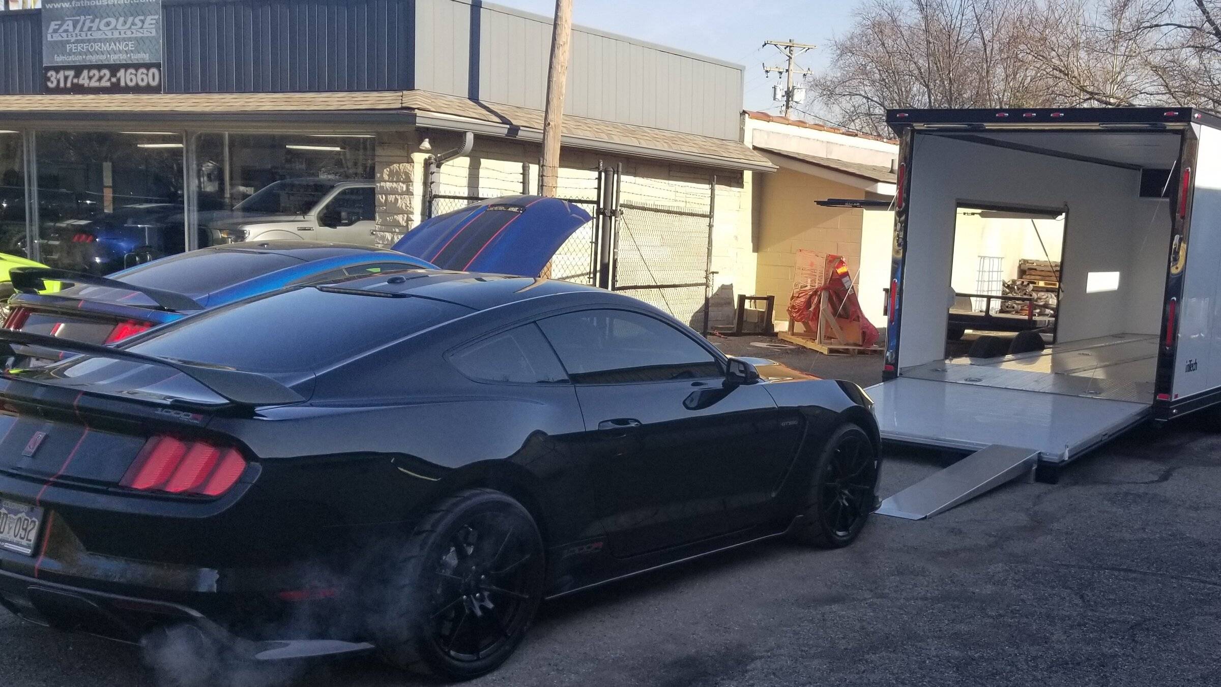

The race ramps will work but they are more as a solution to a standard equipped car trailer. If your shopping I would get the trailer made with long mounted ramps that are about the same length of the trailer door. If you do that, than you wont need to mess with carrying around loose ramps or boards.
