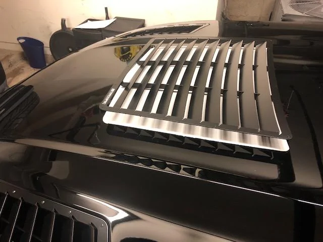

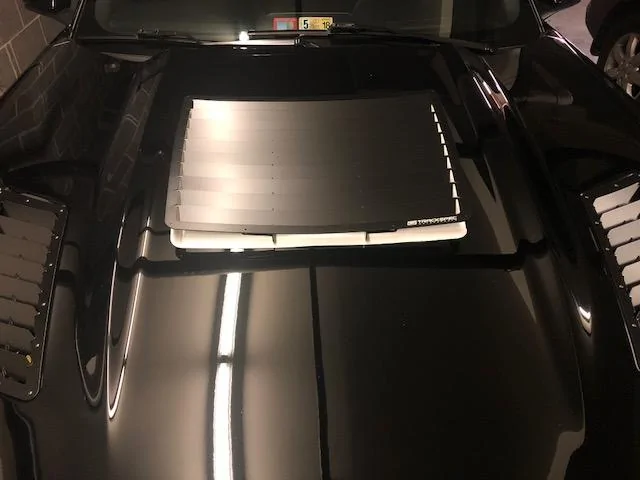

I have noticed slightly lower intake temps (-1 deg) while driving, slower to climb when stopped, cools down faster when you start moving again. You can visually see the heat dissipation when stopped. I can only assume it has better aero effects as the car seems to hold speed longer when you let off the gas. I have only had it on the streets so far, so obviously any positive or negative aero effects have not been seen. The lead edge of the vent it placed 15.5" off the lead edge of the hood, so it sits right behind the radiator shroud.

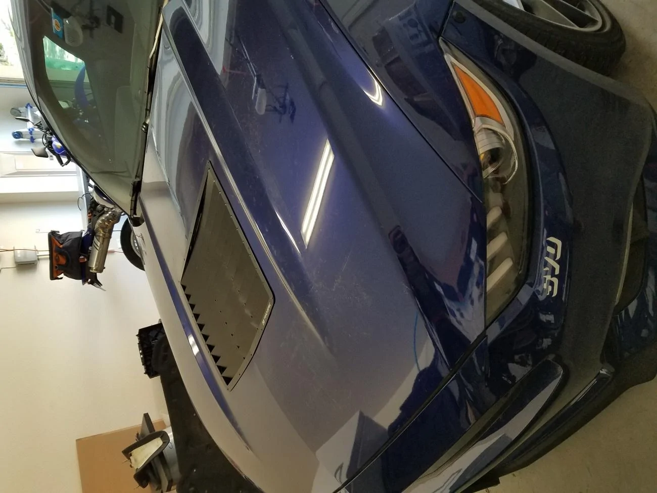

Was not as easy as I thought it would be to install.

is it just me or is the center of the last vent pushed down..?

that is correct. I started installing the rivets from rhe front back. I will have to drill the rivets out and try from the back forward. Maybe, it will look better.
